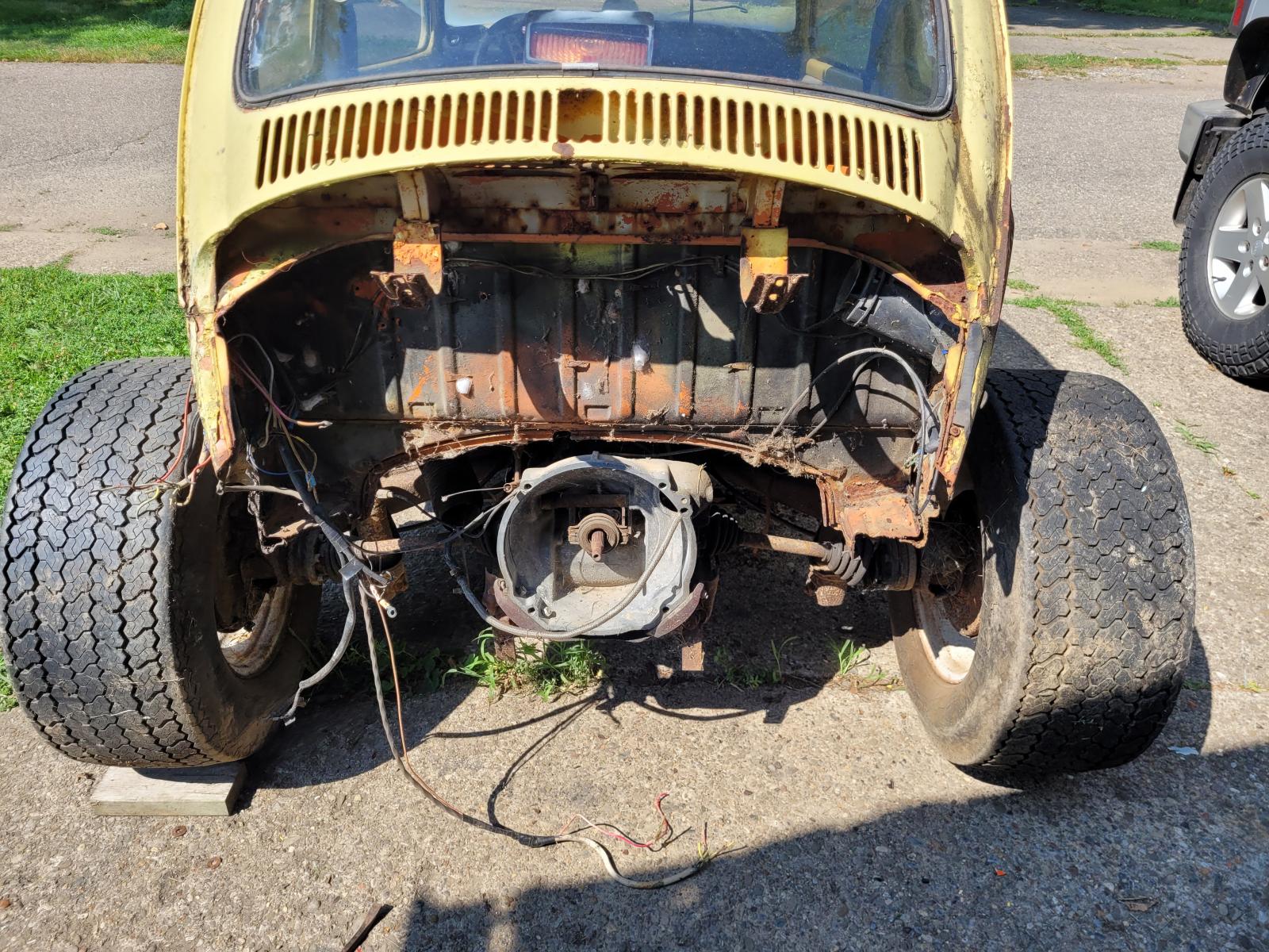

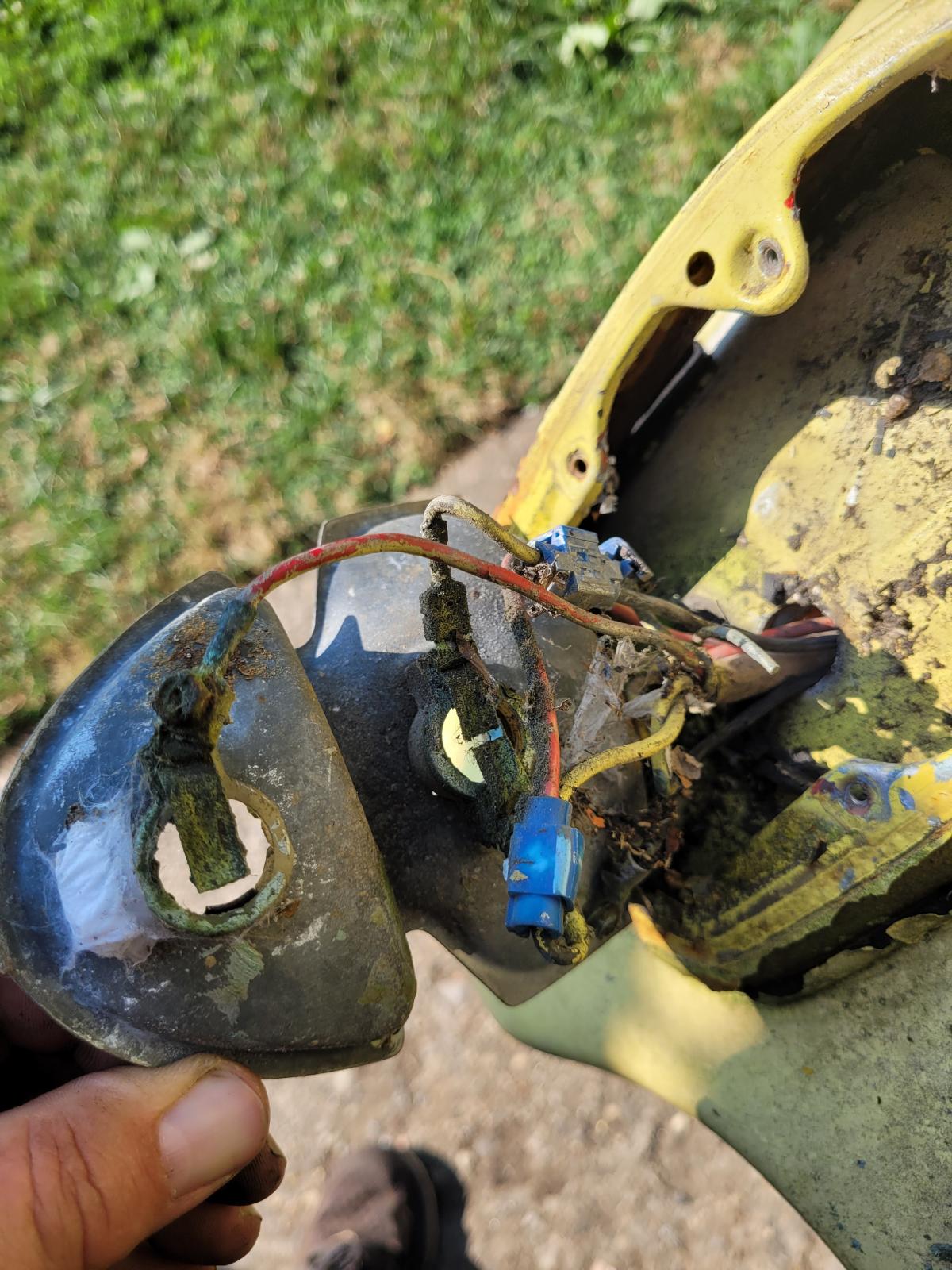

Rome wrote:
Whenever you reach the stage of body reassembly, remember that the taillamp housings need to have a small separate ground wire. A short wire with round "ring" end terminals that runs from one of the small taillamp housing studs over to the closest fender attachment bolt would be sufficient, though of course the contact surfaces would need to be clean and not rusty metal. Electrical current can't flow through the fiberglass fenders.

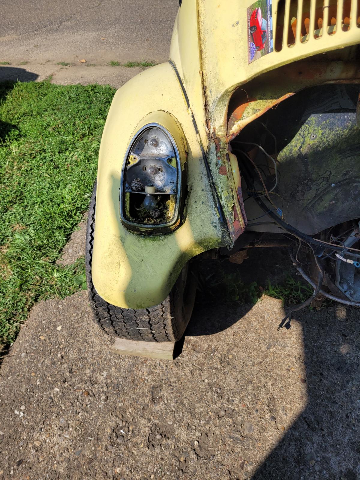

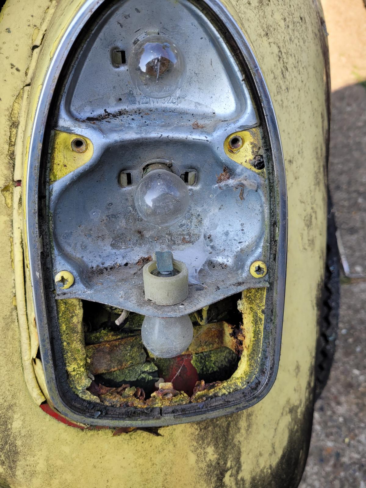

Thank you for that. Most, if not all, original wiring is inherently gone. If you look close, there is industrial SO cord throughout the rear of the car currently, so there's that.

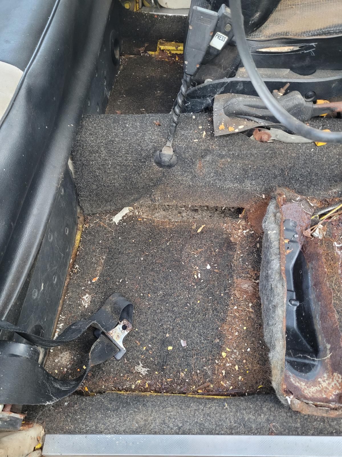

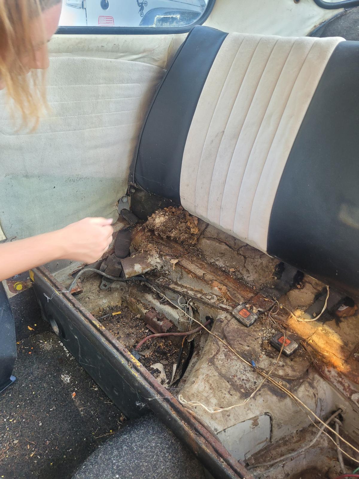

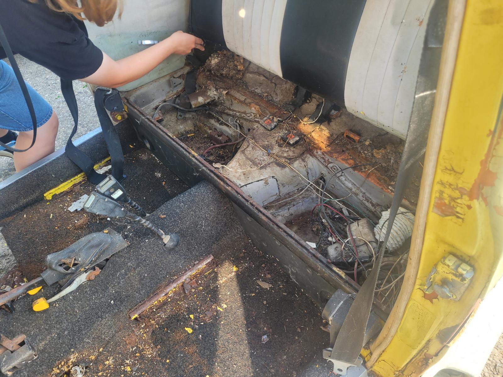

I know we are a long way from reassembly right now. Pans are, in a word, GONE.
The front seats were mostly sitting on fiberglass Shocked
I removed the terrible chrome sheet on the firewall, and found plenty of other issues. I'm quickly drawing a conclusion that we will need a donor for a bunch of sheet metal.

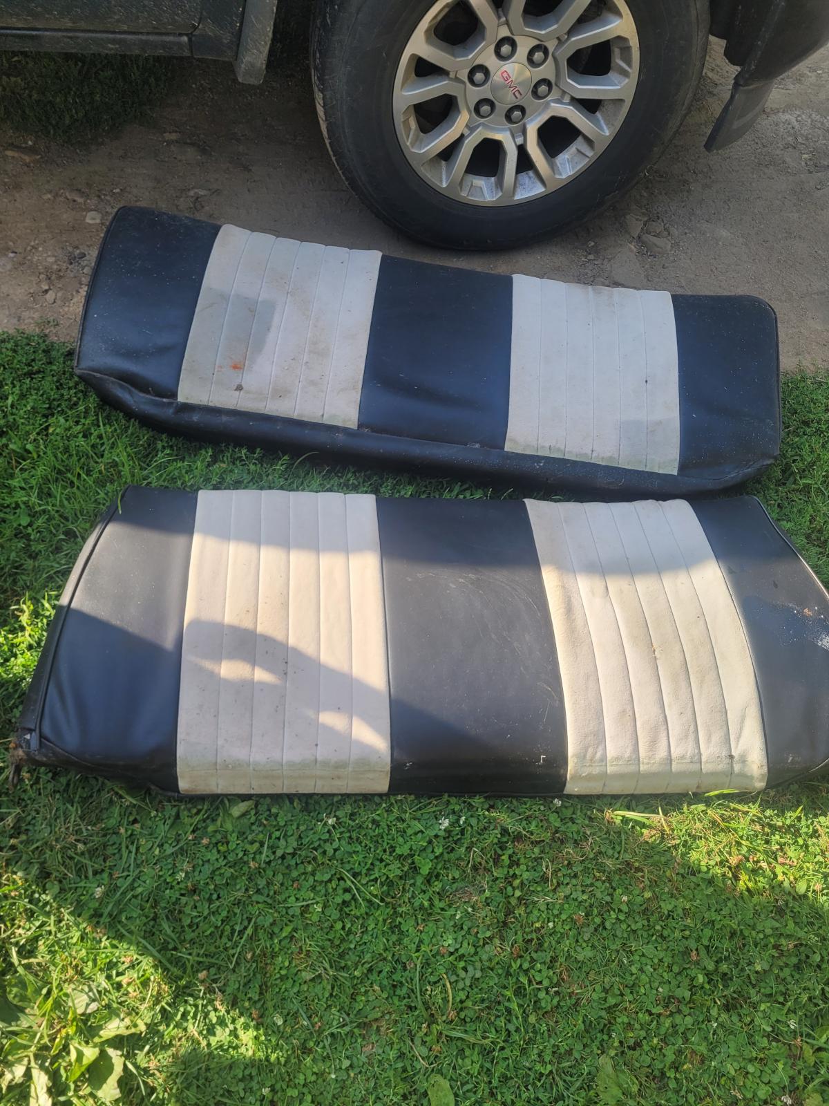

The original seats will all be offered up soon, since she is going to get some later model seats from a small car or something. The battery tray may be the only area that I don't have to weld, but I'm not counting on that yet.

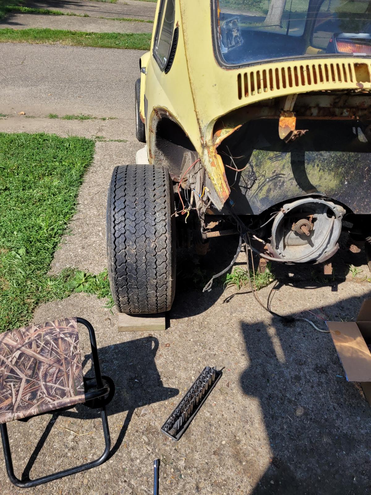

Those rear fenders looked ok from a distance, but had already been patched up and "repairs" made. They got thrown out since we have a fresh set.
Next goal will be getting the front apart and the apron off to see how much damage there is.

PostPosted: Mon Aug 11, 2025 9:57 am    Post subject: Re: 74 Super "Bimbo" Reply with quote

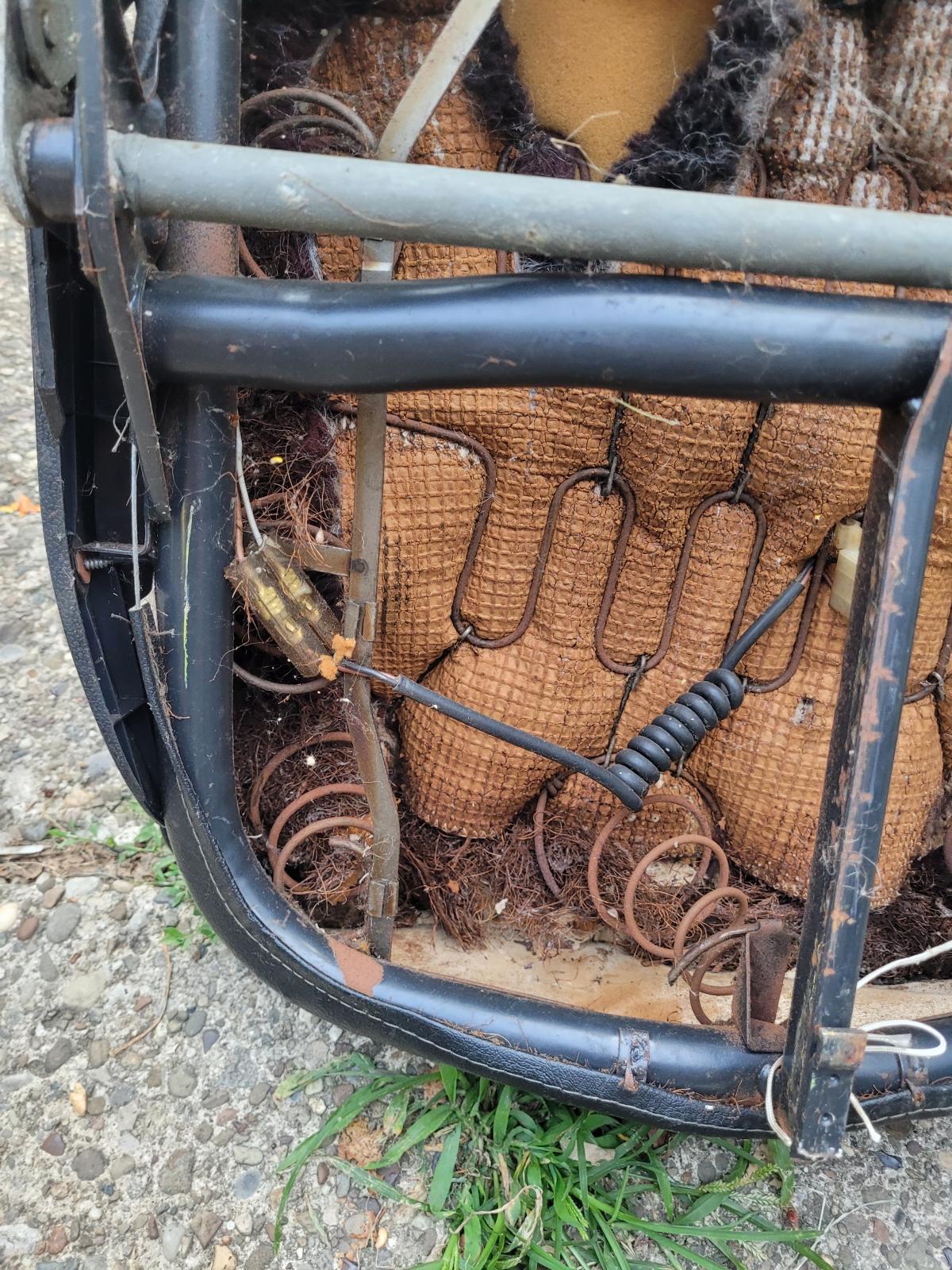

I did find a 4-lug disc conversion, so I answered my own question.
Some more work getting done, and my daughter is finalizing a walkaround video for our youtube page to document this process.

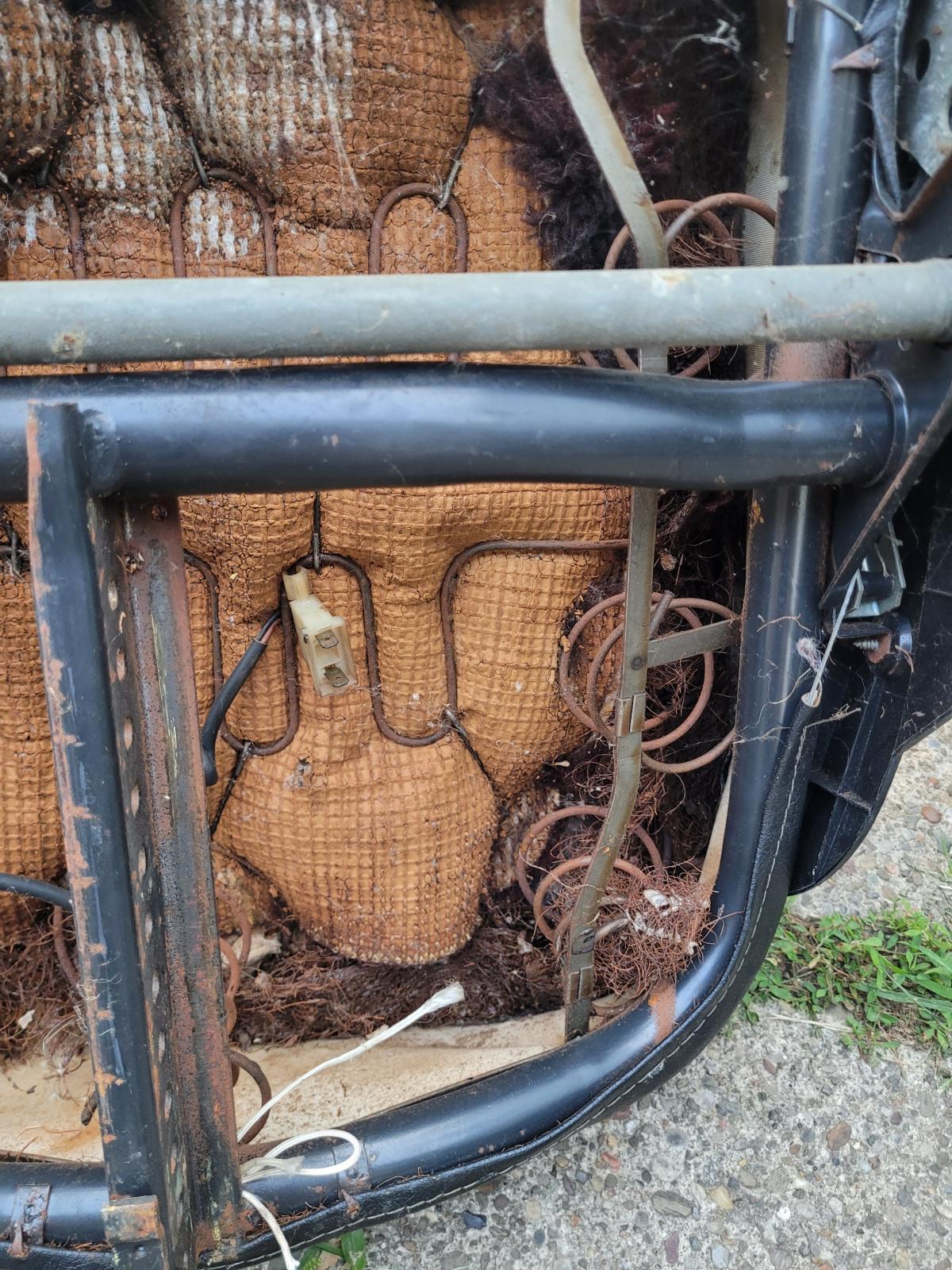

Looks like there is/was a seat heater in the passenger seat.

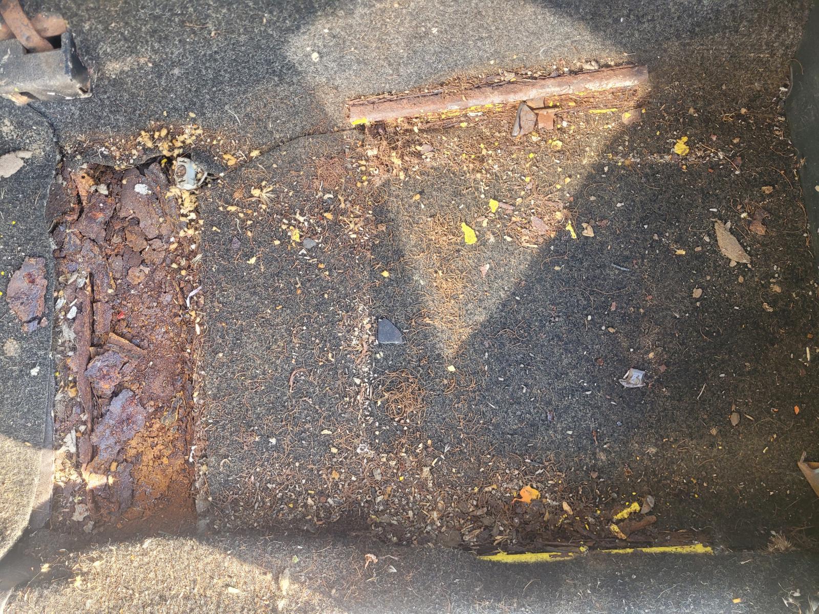

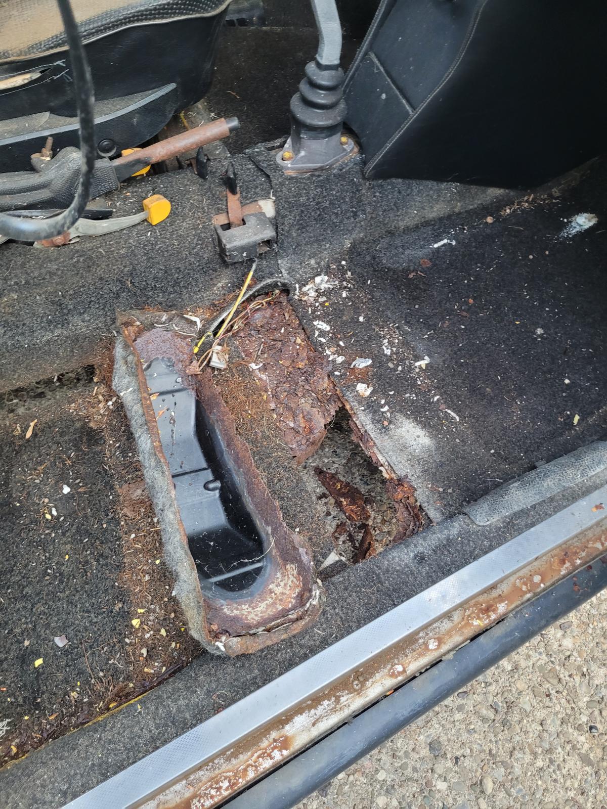

It's gonna need floors. I'm not surprised at all, since we are in Ohio and it's been sitting for a looooong time. I don't even think the rear mounts were attached.
Passenger side will definitely need a full pan. It's looking like driver side will too.

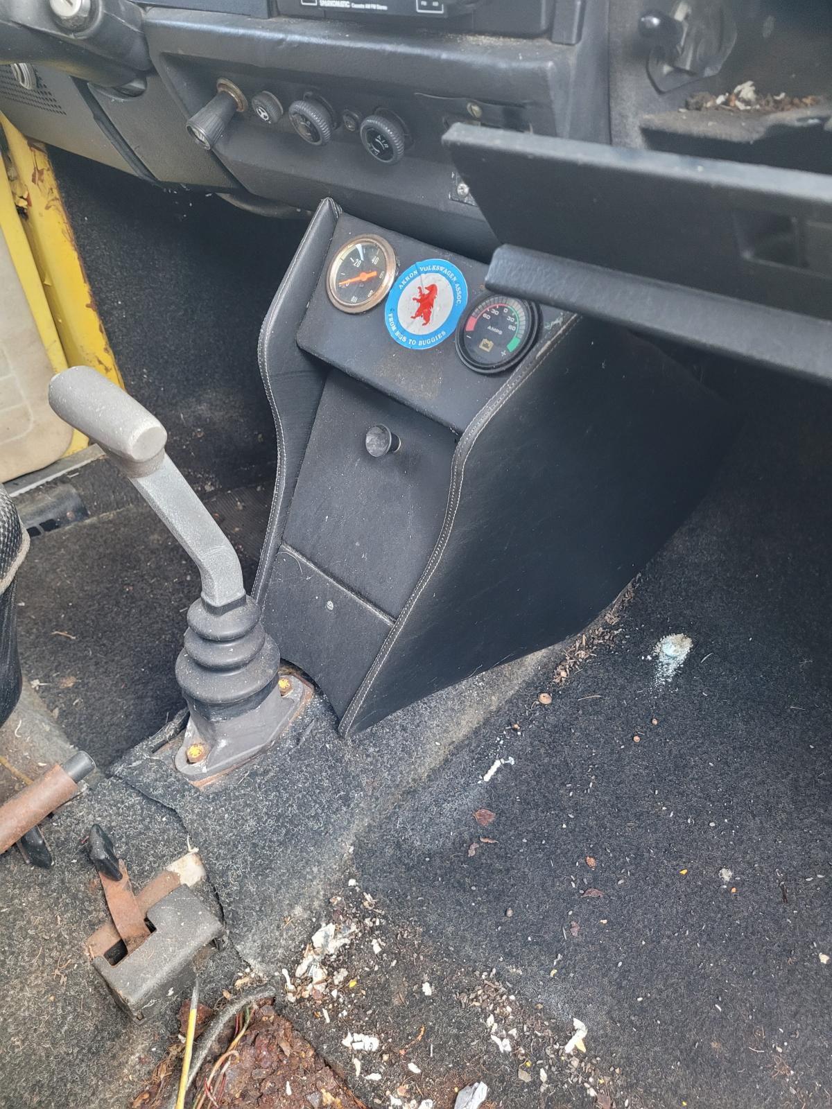

This may be a custom console. If anyone has seen similar that is available, let me know, but my daughter will be learning to reupholster this one.
That's all gonna go, we will build an updated and modern sound system on Bluetooth.

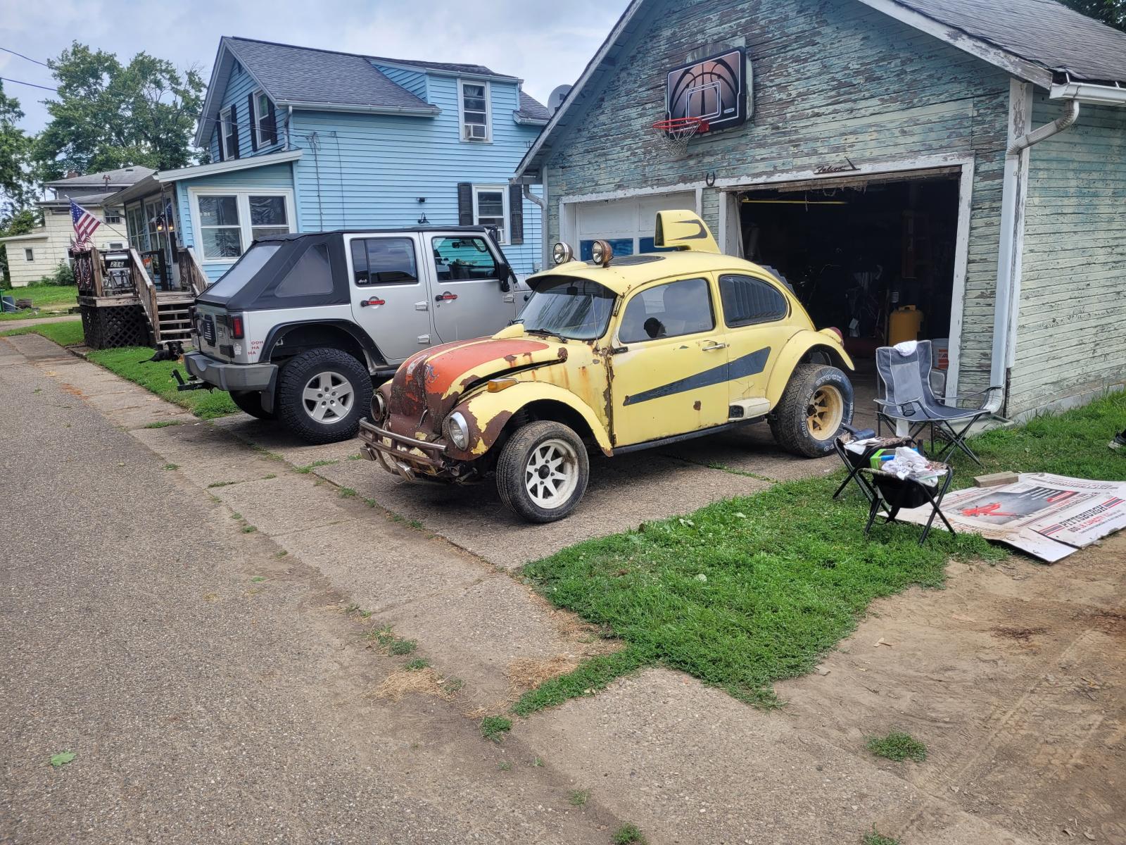

Got the car moved around into the driveway yesterday. Had to pull a stuck drum off the front passenger side to free up the wheel, but it moves.
With no key right now, we pushed it into the street and I pushed it sideways with a transmission jack.
It looks like I will need to do a ton of fab work!
Where we started
Moving with trans jack. Looks like some mounting points for the engine are missing.
Where it landed
She's happy so far!
Cleaning years off the windows. Don't worry, we didn't trash the louvers!
Car sat for years and accumulated some trash and odor!
Seats are decent, but not going to save them. Moisture has ruined the padding and covers.
Ants crawling inside, will be eradicated once the interior is stripped.
I can't explain what even happened here.
Trash. Shop-vac time!
