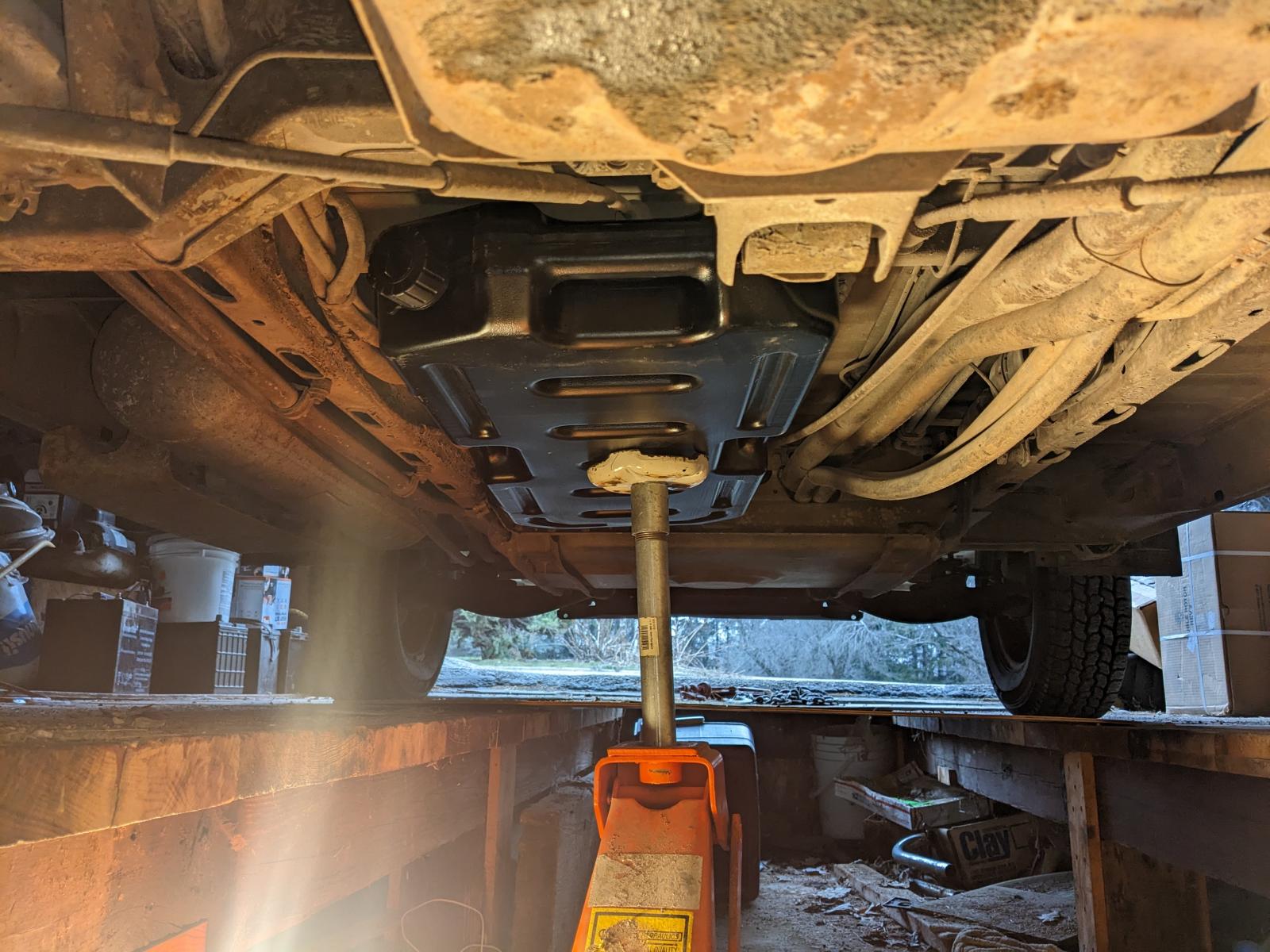

PostPosted: Mon Jul 21, 2025 2:49 pm    Post subject: Re: Gas can in luggage rack? Reply with quote
This 5G unit "fits" but I haven't carried gas in it up there.
Nor have I made straps for under here, but it fits here too..

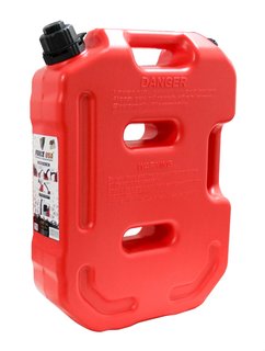

…I’m curious if the spout opening is on the top or side when “strapped in”...
FYI…Side, it seems. Keep us posted on leakage (if any)… Cool

It's like this one. I can't find the orginal vendor
https://shop.carmart.ae/product/force-usa-flat-plastic-jerry-can-10-liter-2/
Pre tariffs, (late winter I got them from both AliExpress and Amazon. It looks like they are hard to get now.

PostPosted: Sun Jul 20, 2025 10:55 am    Post subject: Re: Gas can in luggage rack? Reply with quote
RicMcK wrote:
I have two 10 liter flat plastic fuel containers (Amazon or AliExpress). They are the same height as the luggage rack I can fit 3 across if I need to...
Pic or link to the actual container? I’m curious if the spout opening is on the top or side when “strapped in”...???

PostPosted: Sun Jul 20, 2025 8:15 am    Post subject: Re: Gas can in luggage rack? Reply with quote
I have two 10 liter flat plastic fuel containers (Amazon or AliExpress). They are the same height as the luggage rack I can fit 3 across if I need to. Never had a leak issue.
Hard to see I strap them in place with 1" webbing.
