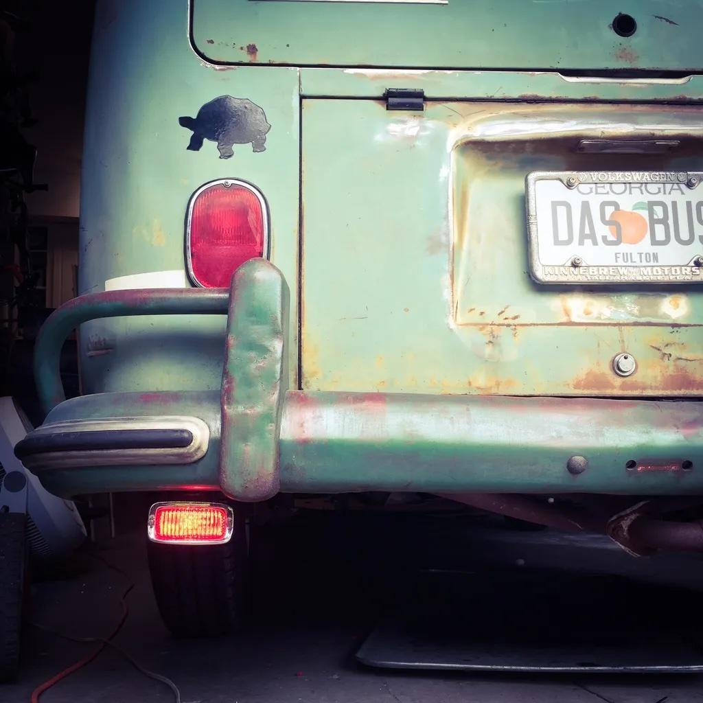

Modern LED bulbs in new euro housings with US-spec lenses:
Added a running light using a Hella reversing light with a red lens and a modern red LED bulb. It comes on the the bus is running.

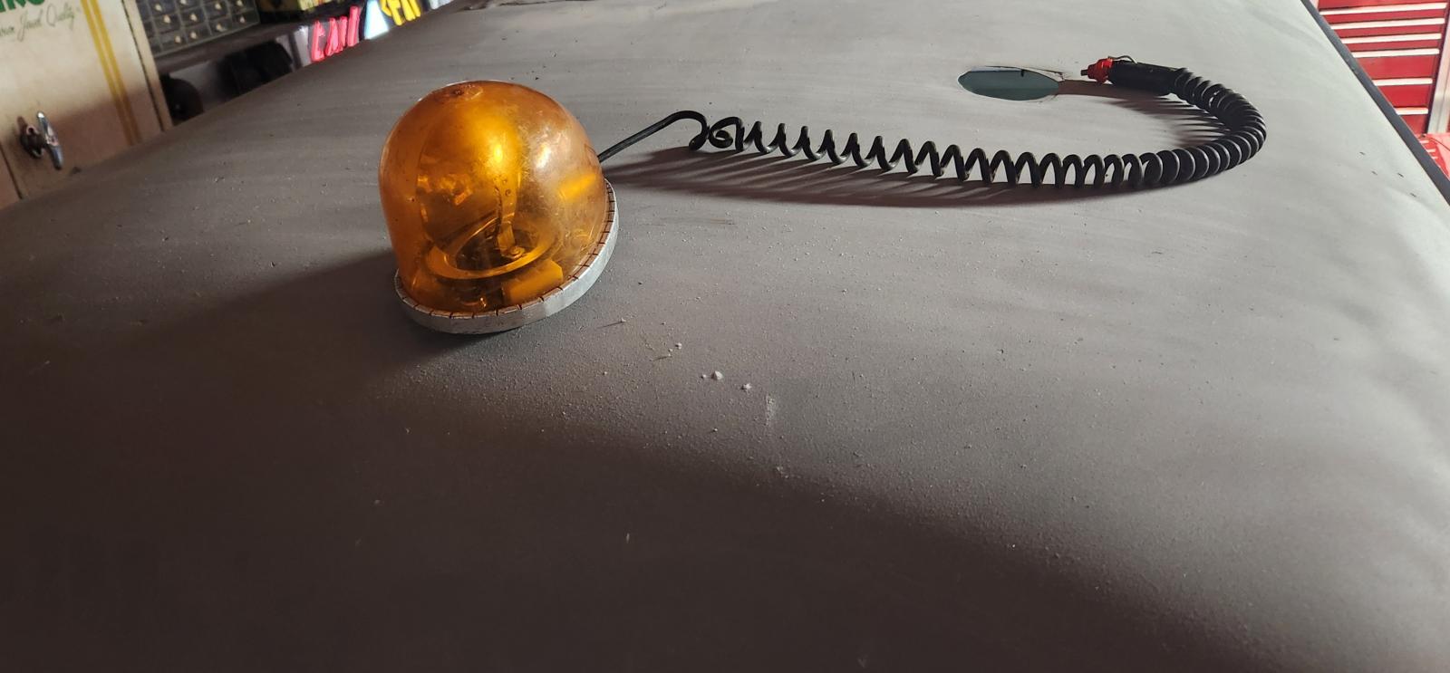

I am going to get an orange rotating emergency light for my roof. You can get magnetic ones for under $40. Turn it on when pulling a hill in third gear, or whatever. Remove it after freeway travel. Way more obvious that a slow moving vehicle magnet.
https://www.ebay.com/shop/amber-rotating-light?_nkw=amber+rotating+light
Yep, whenever I'm driving my 6 volt, 40hp late '59 Double Door Panel with round stock taillights at night on the Interstate I'm usually going a maximum speed of about 50mph. I therefore "own" the right lane and others can simply pass me. So to become much more visible years ago I bought a LED amber magnetic-mount rooftop revolving light which is controlled by a remote control key fob on/off switch (4 or 5 years ago it cost about $60 on Amazon). Runs on 6 AA batteries. It really gets your attention and has no cord at all between the light assembly and the on/off key fob. If I see someone bearing down on me I use the key fob to start the bright revolving amber light and it works great to make me and my old Bus much more visible to night time traffic. If no one is around me simply I turn it off again.
Mine looks just like this one currently on Amazon, although in that current ad I don't see a cord or mention of the key fob control? But you get the idea:
