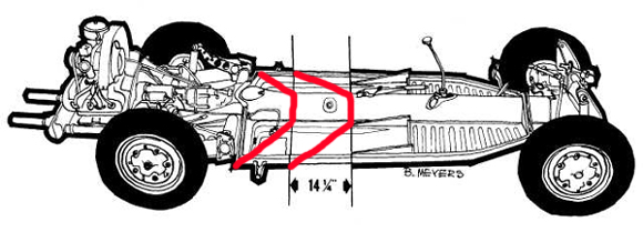

Here's a link to a "How-To" on the official Myers Manx site:
http://www.meyersmanx.com/garage/garage_shorten_p1.htm
...where it says to cut straight, but I also disagree. Rather than a bar straight across, your section to be removed should be shaped like a chevron, slanting back toward the torsion housing at the outside ends.

PostPosted: Tue Sep 27, 2005 12:17 pm    Post subject: Reply with quote
How much of an angle?
Steve

My $.02- "The right way to shorten a VW pan for a buggy. Stronger than just a straight slice, since there is no "Fold Here" line. The section removed is the same width all the way out. Be careful of the tubes inside the tunnel. You'll lose your jack-points, and have to relocate the seat-belt mounts."

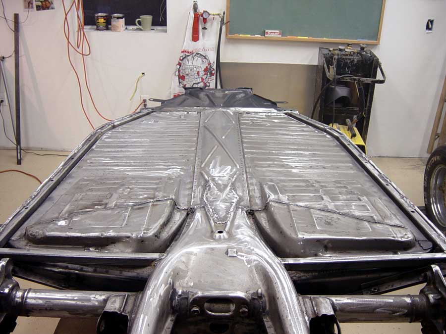

Here's some real life photos of how I did mine:
Here's how I made sure all the lines were nice and straight and properly aligned. I used a Craftsman Laser Trac and a white paint pen:
The rest is easy!
-Jim
Nipomo, CA

PostPosted: Thu Feb 16, 2006 9:41 am    Post subject: Reply with quote
Great Pictures, Jimmler. Nothing like seeing the real thing. Did you use some of the 'liberated' tunnel section over the tunnel joint for reinforcement? What did you use for cutting?
Feel free to post the rest of the pics and the finished product.

PostPosted: Thu Feb 16, 2006 10:26 am    Post subject: Reply with quote
The pan is not officially welded back together yet, so there's not much more to tell at this point. I have a broken clutch tube I'm repairing.
I probably will not brace over the weld with a section of removed tunnel. In this last picture you can see I left some "tabs" from the rear section. I think by bending those in and welding them to the sides of the tunnel, it will reinforce more than a strip across the top. The tunnel is stamped in that area that almost makes it look like those tabs are supposed to go there.
Most of the cutting was either by a sawzall or an air powered body saw from Harbor Freight. The tunnel is some pretty tough stuff. Buy plenty of blades. Also be careful not to slice the various tubes. That's the wrong place to shorten them! Wink
-Jim
Nipomo, CA

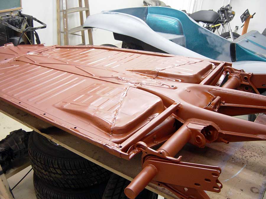

PostPosted: Thu Feb 23, 2006 6:37 pm    Post subject: Reply with quote
Here were some photos from when I did mine a couple of months ago.
