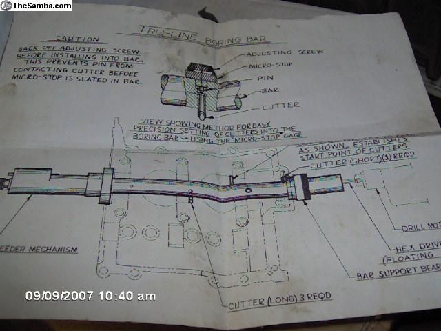

i just bought a truline boring bar dose anyone have the instruction for it . thank you rod

I have 7 Trueline Bars. If you Message me with a FAX number I'll send you a copy of the directions. Did you get a Thrust Cutter also? I can send the directions for that along also.

Rather than starting another thread about the samething as the OP, anyone have a set of a set of instructions for a TruLine boring bar? I actually picked up a couple of these bars.
Also anyone know who could sharpen these cutters? I may just PM nsracing about rebuilding the sets I have.

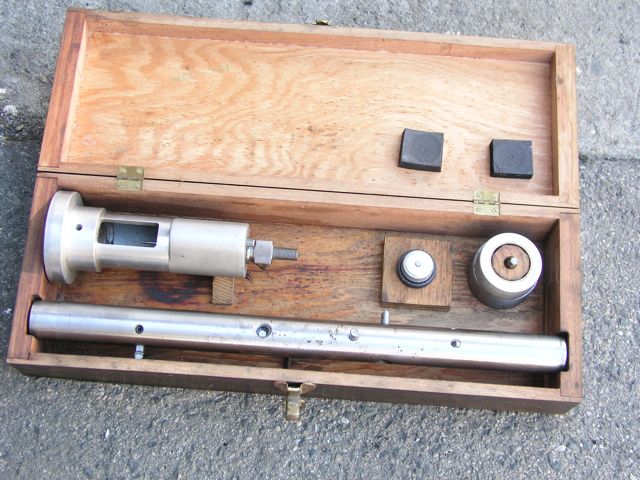

I was trying to catch up with machining and balancing. My PC in the garage is not hooked up yet so I can only check stuff on the computer when I pee. Laughing
I got your PM, Stone. How about you post some pics of what you got.
The TruLine came w/ different feeds and the deluxe ones are the late ones. Some also came w/ chrome bars and non-chrome ones. The latter really wore out quick so you have to make special, dedicated, endbushings for them. As far as the feed, it can also be rebushed but the more the bars are worn, the more the need to have a dedicated feed/bushing.
I have even had to grind some bars undersize and new custom bushings made. The chrome bars just last much longer and hardly wears out, so you only need 1 feed and 1 endbushing to use on several bars.

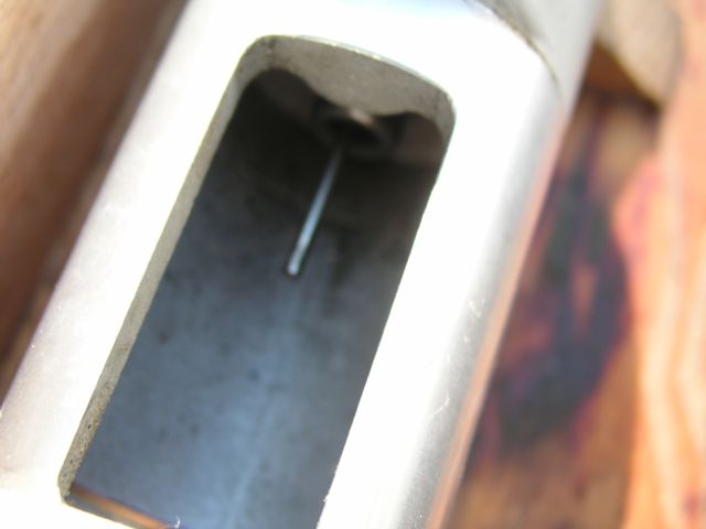

i just bought one of these. at the risk of sounding clueless, i have no idea how the feed is supposed to work. can someone explain this?i have a photo of some rudimentary instructions, that's all i have at the moment.
the small diameter rod inside the feed mech, is this the part that will feed the bar? when you push the small button on the feed mech, what is supposed to happen?
i am going to measure the bar and bushings and decide from there if it needs to be reconditioned. the shop who does crankshafts for us can grind and plate it back to spec, i was thinking this would be the way to go, first off i would have the bushings checked and/or honed perfect, then get the bar made to suit the new bushing size (if the bushing needs honing that is).
NSracing, what is the spec for clearance between the bar and bushings?
