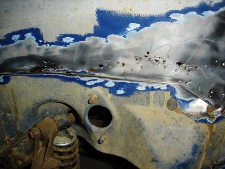

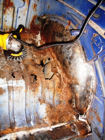

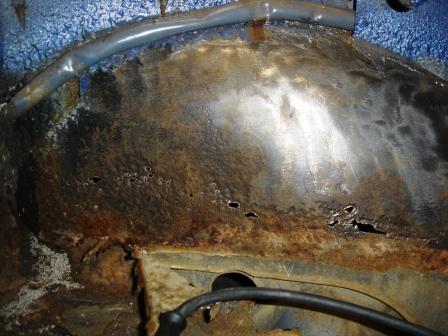

While wire-wheeling away the rust in preparation to remove the old rusted the rear package shelf:
I found many small pin-holes of rust on the wheel well, that go all the way through...
I applied a wire wheel to the "outside" (inside of the wheel well) and got both sides down to bare metal.
I do have a MIG welder but lack experience in this type of work.
A buddy from work (a HT in the Navy) told me:
"Put a copper bar tight up against the the opposite side, and weld them closed and grind it all smooth again, the fills will be stronger than the original metal."
Is it really as simple as this?

PostPosted: Sat Jul 07, 2007 5:33 pm    Post subject: Reply with quote
Not sure about it being stronger, or by using a bar or how simple it is, but i've heard that you can use a peice of cut-up copper tin behind a hole and weld it up. The welds will not stick to the copper and gives the weld something to stick w/o going all over the place.
I think that i saw this in an old eastwood co. catalog once. They had these little peices of copper tin called "plates" that you can clamp over the hole, and a spoon type tool that does the same thing. www.eastwoodco.com

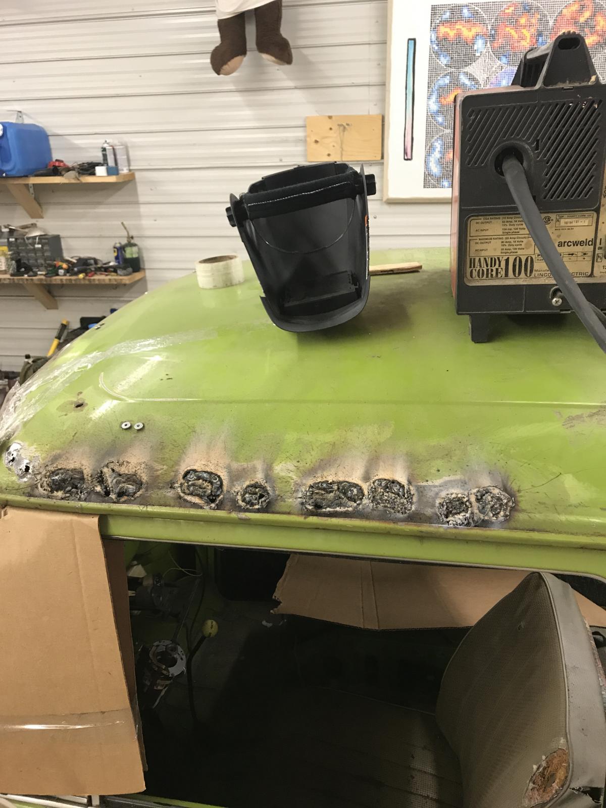

PostPosted: Wed Apr 17, 2019 1:42 pm    Post subject: Reply with quote
10 out of 10 buddy. This is a brilliant idea!
a.wilson wrote:
Here’s my crappy patch job on my Westy’s roof. I wish I knew this copper trick.
