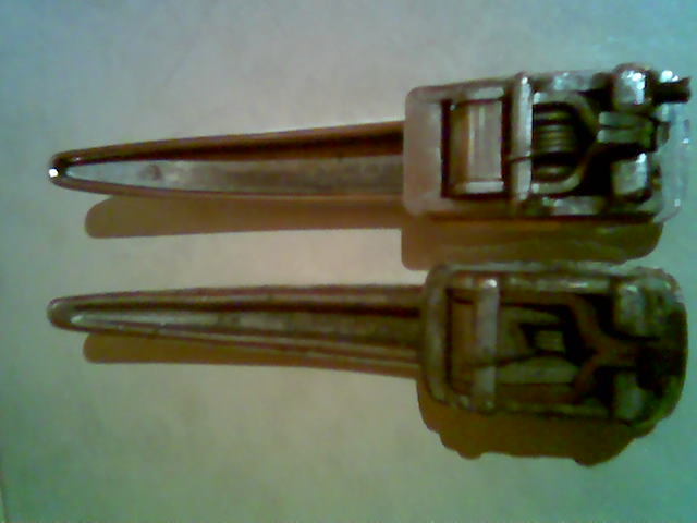

Hi Surfindo, yes, 55-59 is different, but they will fit on your bus, I know several people have them on their barndoor busses... when you grab these handles, you'll feel the difference on the inside: they feel much thicker on the inside of the handle itself, later models are not that thick or heavy... I can't give you the exact 211-.... numbers now, the only bus handle I could find here at home, is a very early one I believe, it's a L-211.052 from HUF which also shows the old KDF logo instead of a regular VW... but it came of a Barndoor... I checked the barndoor.dk also, in the 'details and changes', but there where no numbers, sorry!! I'll try to make a picture of that old handle and post it later this week, ok?

PostPosted: Mon Jul 02, 2007 3:07 pm    Post subject: picture.... Reply with quote
....sorry for the poor photo quality !! the handle above is a later one, 55-59, under it the old one with KDF logo, from a very early barndoor, this just to show you the difference in thickness of the handle itself...

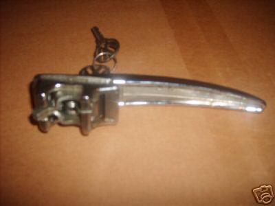

Not to open a new thread I'll ask this here.
I bought this pair this week and was wondering if they are early BD handles?

I posted some info here
http://www.thesamba.com/vw/forum/viewtopic.php?t=264689&highlight=handle
I'm still looking for locking handle myself

PostPosted: Fri Sep 05, 2008 1:46 pm    Post subject: handle Reply with quote
hi Hebster, I've got the same one, same number, also with KDF logo, but it came from a '51 barndoor bus... if you need them for an early bus, I think you found the good ones! ...try them first Very Happy G.

Hello!! I saw your Topic a long time ago, and yes, it's hard the tell what's correct, you wrote: '...There are also handles with the number L-211-051/52 these handle are usually sold as Split Beetle handles and are Huf and have a Huf lock and key. '
well, yes, many people think they're fro split beetle... I'm not so sure, never had a split beetle, only early busses, and I saw them more then once on busses! ...but we'll never be 100% sure I guess!!

Etah Pravdah Tovarish! Those are 50-51 Bus, but also early beetle? I think, cuz of the KDF logo?? I found a few set's while in Plook, Poland. During the Invasion of the 3rd Panzer Division.
