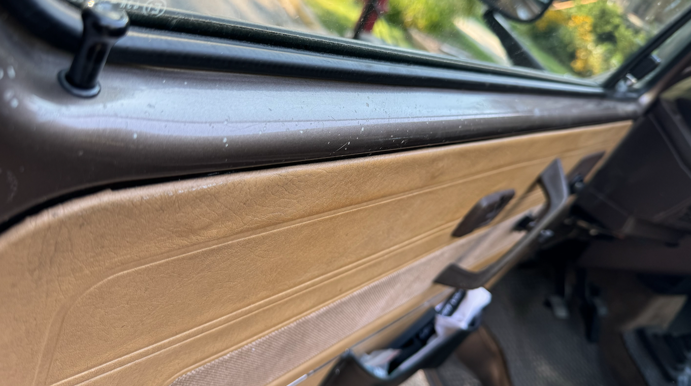

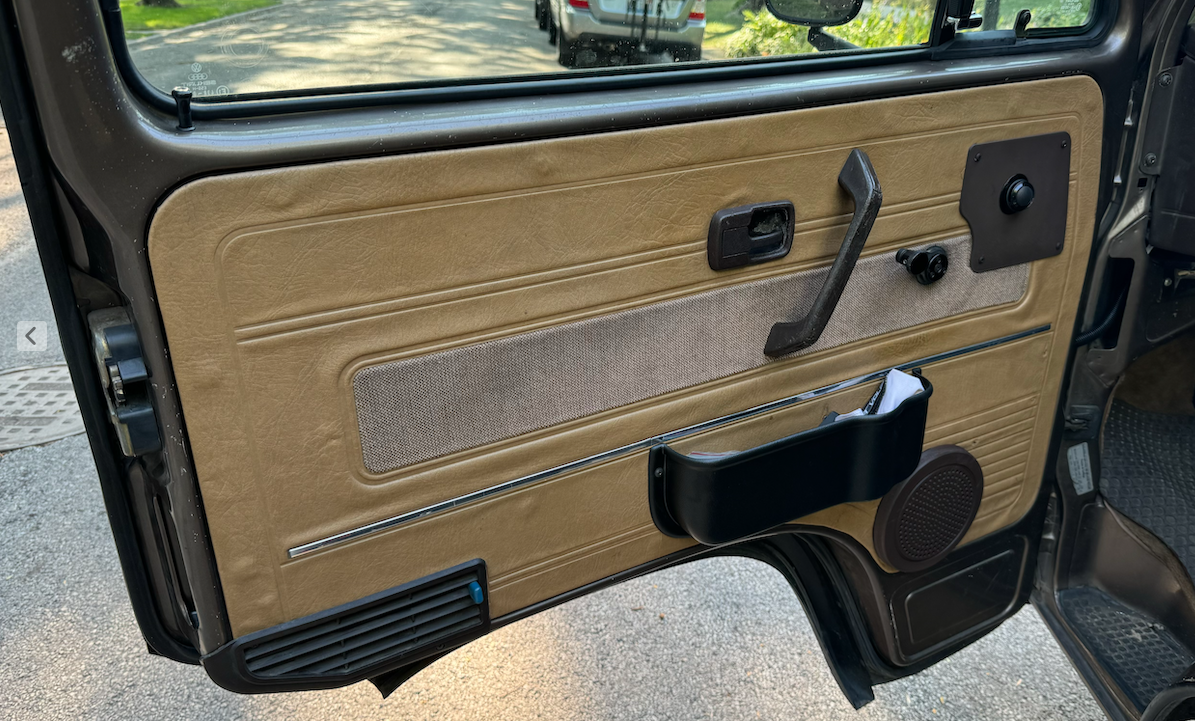

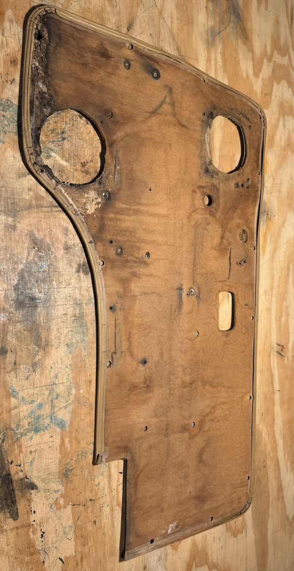

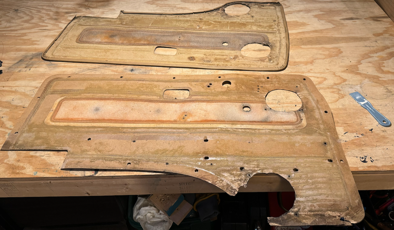

Digging up this old ass thread to share the "reskinning" project I did this summer on my severely water damaged front door panels.
Took the panels off and you can see how warped, deteriorated and moldy they are. OP had removed the moisture barriers at some point, so I had to replace with new ones. I don't have a photo of those, but got some new high quality ones from Stacy Schneider. and installed those first. But clearly the damage was already done.
From there I skinned the vinyl off the panel. The fact that this composite wood board was disintegrating made it easier to have the glue separate with a little coaxing from a dull plastic scraper.
The hardest part was not destroying the "chrome" which is actually a foil sticker on a plastic strip (like the ones on the front windows if you have the old style window seals with the channel. The glue is only on the embossed parts of the design.

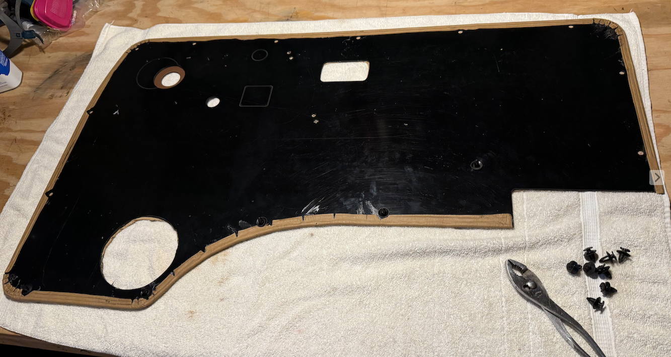

Got some super toxic but very sticky spray glue 3M hi-strength 90 and a new respirator and coated the ABS panel and the inside of the vinyl. Made sure to keep the vinyl flat so it didn't bend the chrome strip. I also did a lot of dry fitting to make sure I knew what approach I was going to take getting the vinyl on the ABS panel because I heard this particular spray adhesive is not very forgiving.
Anyway, got them together and it wasn't as hard as I thought it might be to get everything lined up. Used a roller and then put a piece of plywood over it and heavy things on the back and let it setup for 24 hours.
Next up was putting in new clips (used some of the old ones, but also got new OEM clips to supplement as some were broken and missing) At this point I also used a hot glue gun to secure the vinyl that wraps around to the back of the panel. This allowed me to work on a bit at a time and indoors. I also used hole saw bits to cut out for the manual window cranks and speaker hole. A silver paint marker came in handy for measuring location for the speaker. The ABS panels from GoWesty had everything else really well marked.
Skipping over a few things here as I had my son print me an ABS panel to cover the old speaker hole in the vinyl up by the vent wing window and then used SEM spray can to paint that panel (had already used it on the new larger speaker cover we made as well) and put everyting back on. This photo makes the clips look a lot more apparent than they look in real life, but now the door panels are straight and look great and I'm not breathing as much mold. Worth the time.
The first one took me most of a day and the second one I got done in about 2 hours. Overall very pleased.
