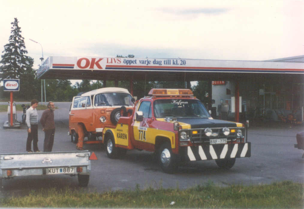

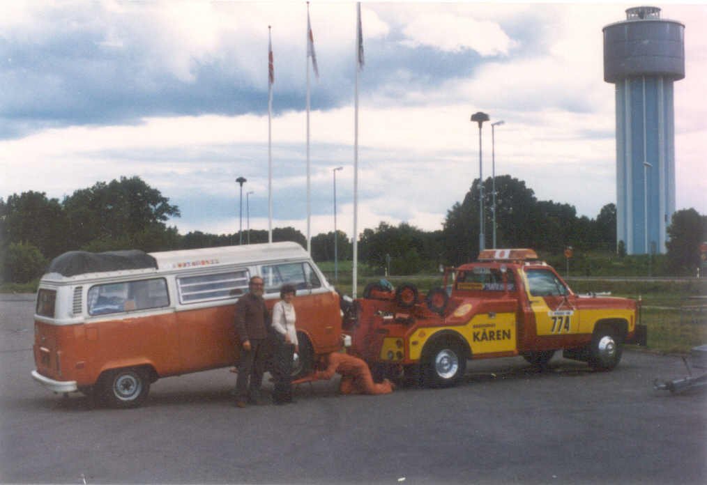

Our 1982 summer touring holiday, was in Denmark, Norway & Sweden. In Sweden, two hours after our departure from Västervik, heading south towards Kalmar, the engine suddenly died less than 200 metres from a petrol station. The engine turned over easily, but would not fire. Seeing that the fuel gauge needle was close to 'reserve', I suspected that we might have run out of petrol, as had happened on at least one previous occasion, so we pushed it into the petrol station and filled up the tank. After filling up, our renewed attempts to restart the engine, were equally fruitless, but this time I noticed the smell of petrol.
Suspecting that the Minnow Fish carburettor might be flooding (something that was mentioned in the troubleshooting sheet, supplied with the carburettor), I removed the fuel-level check-plug from the float chamber, which confirmed my suspicions. After removing the float chamber, I discovered that the brass float had partially filled with petrol, which I could hear sloshing around inside. This necessitated a telephone call to the Bärgnings Kåren, for which the petrol station, kindly didn't charge us.
A Chevrolet tow truck (not found in Great Britain! | featured as part of my ink-jet printed, full-colour, 1968~79 VW Type 2, 30th anniversary, iron-on, T-shirt transfer!) was dispatched, to tow us "four miles" (note that in Sweden, the word "mile", is used as a reference to 10 km!) further south, to Kalmar, in Southern Sweden, where at about 7.00 PM in the evening, in a small back-street workshop, our brass float was drained and then repaired using solder. Had our float been moulded from plastic, we probably would not have been so fortunate. As a souvenir of our tow, we scrounged a self-adhesive badge of the Bärgnings Kåren, which is now attached to the elevating roof, along with various others.
The combined towing & repair charges were quite expensive, so we didn't have sufficient AIT vouchers (provided as part of our AA 5-star Continental travel insurance), to cover the cost, so the difference was paid in cash. Several weeks after we returned to Britain, we received a letter from the AA, saying that the Bärgnings Kåren, was still owed the sum of money, corresponding to what we had paid in cash; suggesting either dishonesty on the part of the patrolman or some confusion about the paperwork. Either we are now black-listed by the Bärgnings Kåren, or the AA managed to resolve the issue, but we never heard any more about it.
https://assistancekaren.se/other-languages/
Preparation at the petrol filling station, for our expensive, 40 km tow to Kalmar.
