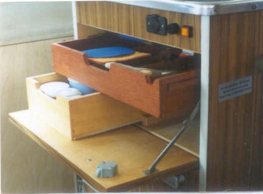

Retro-fitted a home-made, full-width, supplementary plywood cutlery (i.e. cooking & eating utensils) drawer, to my British specification, 1973 VW Type 2, Westfalia Continental campervan
The supplementary drawer was made using ¼ inch plywood for the front, back & sides, plus 1/8 inch plywood for the base and five two-thirds depth, internal dividers. The drawer runners, were made from off-cuts of rosewood.
Other illustrated items, include the momentary, push-button switch for the retro-fitted, Denton Greenwood "Evenflow" electric water pump, a Swedish-made, splash-proof, 12VDC accessory cigar-lighter socket, fuse holder for both electrical systems and a pair of hinged stays, for the fold-down flap.
