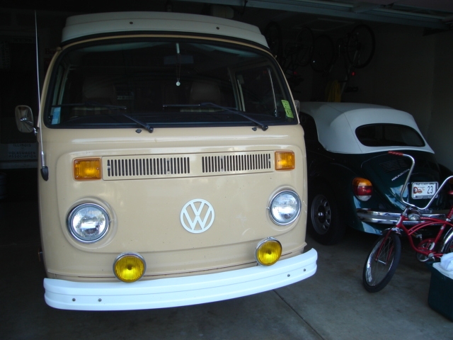

Here's our '79 -- I drilled holes on the top in the same location as the holes on the bottom. I mounted the lights before I put the bumper back on because there isn't a lot of room to get your fingers and a wrench in there.

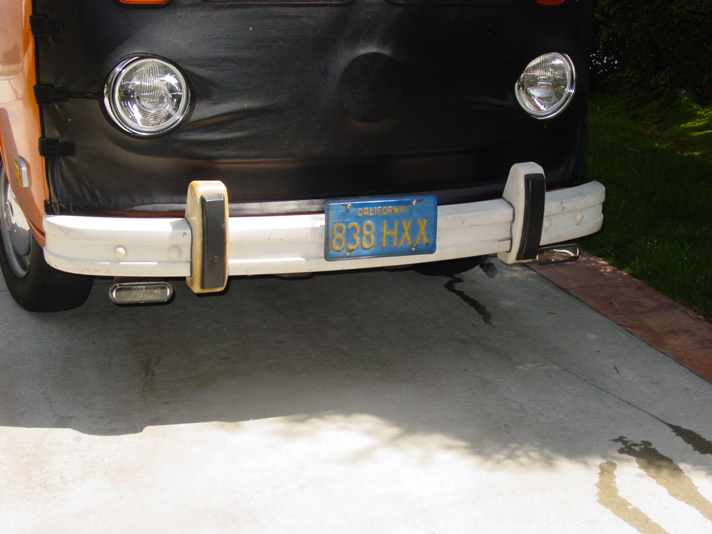

the look of the bumper WILL change when you flip it over. Rember that time you go too close to the high curb, and it crunched abit, or that time a big ol hunk of tire came your way, ricoceting under the bus? Or that time you lent the bus to some crazy kids? Well when you flip it over, youll see all the evidence of these exciting forays into newtonian physics. I discoverdd those bottom holes when I removed my bumper and thought that a PO had had lights, taken them off, and flipped the bumper. I flipped it back over and mounted my lights in the holes. However, on one side it was bent up enough to fit the bolt, but on the other it was still flat, and the bolt was too tall and hit the frame underneah. I used a crushed rubber spacer from my spare tire mount to space between the light and the bumper, giving me more clearence under neath.
My word of warning, paint is missing on that bottom side, and there is rust and dents. However the shape of the bumper seems to be complelty symmetrical. Do we need drain holes in the bottom of the bumper? If thats what those four were for, I'm going to say yes, and tonight Ill drill some.
anyone else know if those are drain holes?

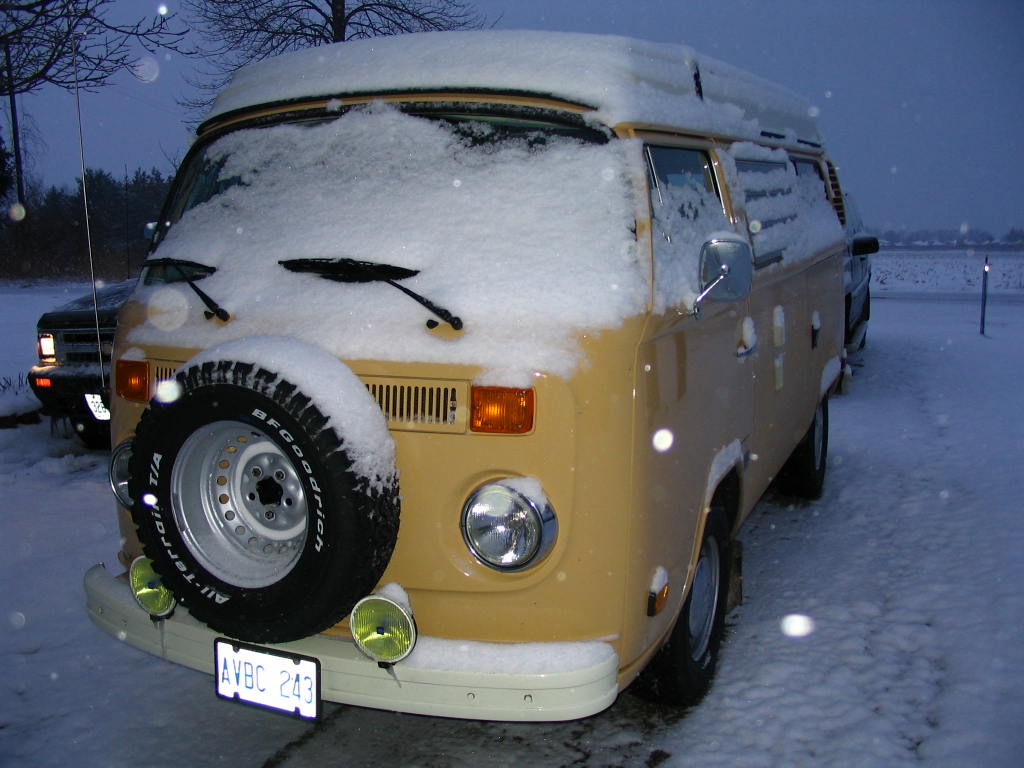

These Hella Halogens work great. They fit in the holes under the bumper and do not hang below the belly pan. Situated under the bumper, on the sides, they put out a bright wide fan of light that lights the road under the fog.
