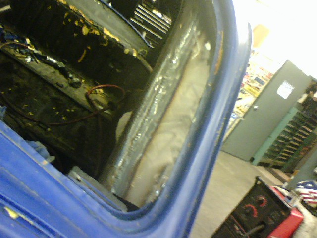

this is what i did to mine.

ive never been a believer in it, it basically makes it so that your body and cage are one piece and that basically means if anything happens your stuck.
ideally you need to build your cage into the frame and tie everything into it and make it basically function independently of the body, you body needs to be what gives the bug looks.
if anything i would make it so that your cage bolts into the body in various places to make sure its nice and snug.

Bajahucks that is kind of what i'm talking about but i'm thinking a whole lot tighter to the body but using flat metal webbing like you did to make it contour with the body and for the most part not even see the cage.
I'm seeing it being a LOT of work but i like the idea of more space inside and a "cleaner" interior. May not be any advantage on a full out racing vehicle but i'm just a weekender and I want looks and comfort along with a little extra strength in an accident. I dont wear a helmet when i'm driving my baja and i got think bangin your head on a roll bar gotta hurt and seems unavoidable even with typical tight cage (like i have)

The proper way is to tie the cage into every piece of the car that you can. If the cage is done right you will not get the body off anyways without cutting it off. If your not tied into the car right, the body and pan will move independently and things such as your rear shock mounts will move, i.e. shock mount points getting longer than the shocks are, etc. The pics of the cage tied into the A pillars is correct. If you are building the car for offroad, then thats what you have to do. If you want the offroad look for your street baja then get one of those "show" cages, stay on the pavement and it will be o.k. I know someone is going to say they buit a cage and "beat it up really good", but that is the right way......You wnat to limit flex as much as possible. Good job!

I will be tie plating the cage on my car to cut down on rattles.
Sure you may get some vibration noise thought the chassis with all solid mounts and such... but if the cage fits tight enough and you don't tie the cage to the body, it sounds like you have a metal bucket with a handfull of nuts and bolts bouncing down the road.
As far as removing the body... the sheetmetal plates connecting the body are not exactly permenant. Its just metal..... plasma cutter (wish i had one Very Happy ), 3" cutoff wheel, sawzawll... etc...
If they are built correctly, they will not be difficult to remove anyway....
Now, on a 5 car that comes apart 10 time a year, I completely understand the need to have a body that can be removed in a half an hour... but on a playcar or prerunner... its not a big deal (to me anyway) if it takes an extra 2-3hours to cut the plates should I ruin the body.
I'll take a little mechanical vibration noise over metal on metal clanking anyday.
Plus... its just another place to use my new dimple die set.... Rolling Eyes

very good point motorbreath. thats one of the reasons i did it also. i had the same cage in a other bug i had and it made so much noise. then i crashed it so that solved.
