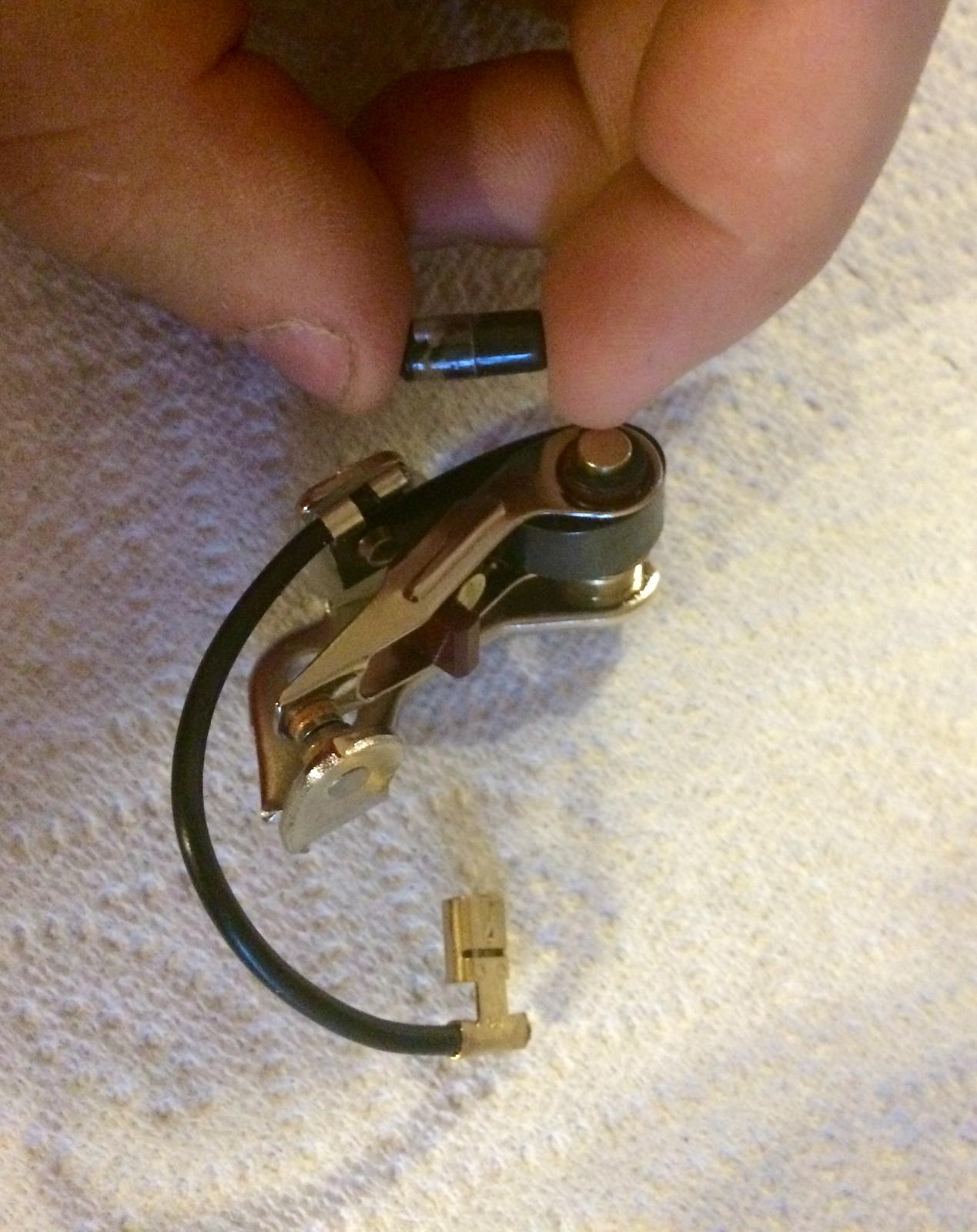

The new points I have bought have all come with a small capsule of grease in the packaging box, just enough for one or two applications.

The dielectric grease isn't really a good lubricant. It is made to seal and protect electrical connections, and that is about it.
For the record, this is the capsule of grease that comes with my points. It is small and easy to miss, as you can see. Now days I don't get Bosch points. Never thought I would say this, but I haven't been very happy with Bosch ignition products as of late. Coils seam good, but points and wires...there is better out there unless you can dig up NOS parts from back in the day. Points I get are made by Wells vehicle electronics, and wires are AutoZone Duralast Gold which are made with German made Beru insulators/resistors. Beru was another OEM supplier for VW ignition parts. I like the Durralast Gold wires because the Beru plug ends still have the spark plug seal. Bosch ends haven't come with the spark plug seals for a number of years now.
