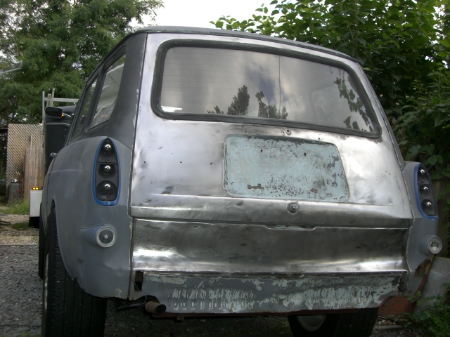

well ill tell ya
i took it down to that stage about 2 or 3 days ago(total of about 2 weeks)
and the only Rust colored stuff i see (i havent clear coated yet)
is where my oily dirty fingers touched
Understand the body on this square is TRASHED
It would be better to buy a whole other car and switch bodies
So i dont give a crap about this one
Man if ya'll saw ALL the rust and Crappy repair jobs on the car
MOST of you wouldnt have bought it
Let me tell you something
the PO Is Lucky as hell i gave him money before i looked to far into it
OR it would of sat there and completed the rusting
rust
nuts and bolts missing( like one whole side of the body to pan bolts)
rockers tacked in Mad
I Tell You
Just a travesty
But what ya gonna do but Drive n' Love them Rolling Eyes Very Happy
