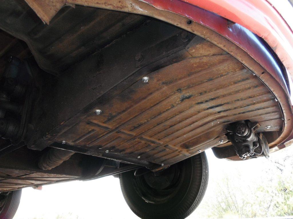

Posts: 71533
PostPosted: Fri Dec 18, 2020 9:57 am    Post subject: Re: Barndoor pedal pan Reply with quote
The one on my '55 looks like it used to black here:
It could be repainted but that seems unlikely to me given the wore off paint and surface rust
