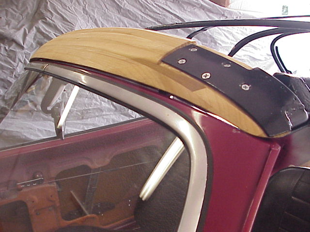

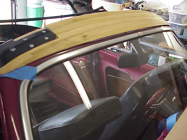

Using shims to obtain the 6 mm (1/4") clearance between the
main bow and body support pillar. Loosen the 3 frame mounting bolts
on each side @ rear of door to shift the frame.
Also push the top frame outwards until the main bow projects
about 2 mm from the body sharp edge on top of the quarter panel.
Retighten the frame mounting bolts.
Properly fitted header bow will have space between the bare wood and
the windshield frame: Specs are 7 mm at center, 2 mm at the ends.

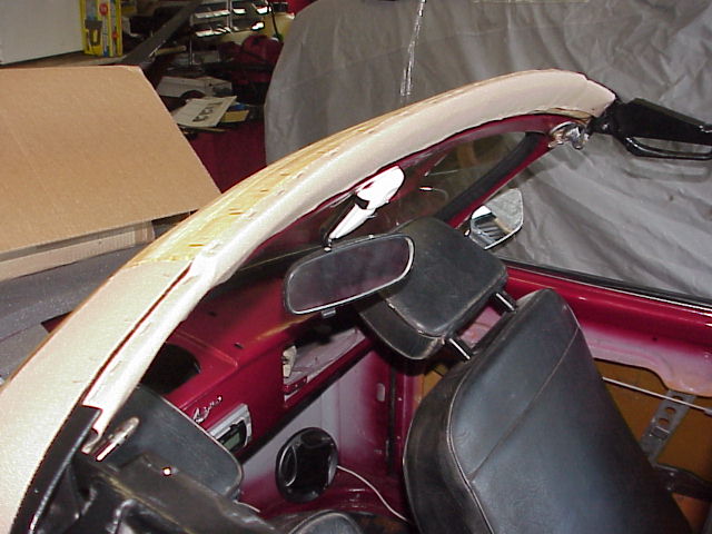

Cover the rear edge of the header bow with matching fabric
strip supplied with the top cover.
Also cover the corner plates. Staple positions are marked so that
the next layer of fasteners for the headliner can be staggered on top.
Positioning of the glass window hinge to body mounting to the middle
of the range allows for future adjustment, if needed.

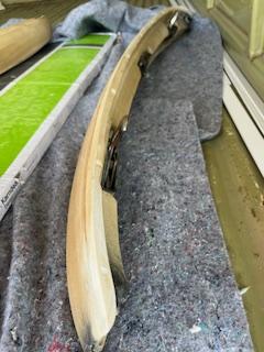

Hi Loren,
Vince is working on my ghia.
The front bow came from Sewfine as Vince stated and just needed slight modifications to the right side to match the curve in the corner cover plate.
The rear bow came from KGPR and needed to be thinned about an 1/8 of an inch to fit.

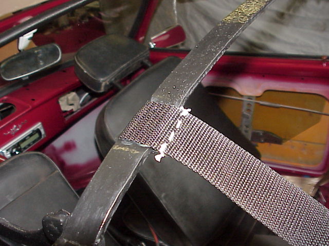

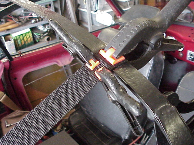

Glue a foam strip to the underside of the header bow at
the front edge. DAP contact cement on both surfaces to secure it
to the wood.
Glue one end of the webbing straps at the recesses in the main bow.
Sew the straps in place with waxed, heavy duty thread.

Fold the top forward but do not engage the front latches.
Temporarily lower the rear bow and glass window.
Mark a length of 660 mm (26") on each webbing strap from
the rear edge of the main bow. This is the specified distance
to the rear body flange.
Using one inner anchoring strip, attach each strap to the body
using 2 Phillips countersunk screws. Note: the third, inner
screw is fitted in a later step. Also do not cut off any
surplus material.
Right side, same as above.
Close and latch the top. Pull up the rear bow to a dimension
of 300 +/- 5 mm (12") measured from the rear of the main bow to
the trailing edge of the rear bow. Attach the webbing straps with
tacks in the recesses of the wood. It will fit tight!
Bows are now set in position. Check the latching of the rear window.
Make adjustments now, if needed.
Fold the surplus ends of the webbing straps back and glue them in
position.
I think the dimensions are backwards. They may be correct for earlier-model Ghias with the latch in the middle of the main header bow, but on later-model Ghias with two latches - one at each outside edge of the bow - you would want a thinner space in the middle and more space on the outside. The reason is that, for later-models, the top should contact the middle of the bow first, then closing the latches will pull-down the outside corners and you get a good tight seal all the way across the front.
I'm basing that on convertible Bugs. I haven't replaced a top on a Ghia, but I've done a couple Bug tops and that's how they are setup. The idea should be the same.
Ghiaddict, thank you for putting this post together. It has great information!
Lon
1969 Karmann Ghia convertible
1971 Westfalia camper
Ghiaddict
Joined: November 20, 2002
Posts: 2632
Location: Now in Honea Path, SC
Ghiaddict is offline
PostPosted: Fri Dec 11, 2009 4:07 pm    Post subject: Reply with quote
22manybugs wrote:
I think the dimensions are backwards...on later-model Ghias with two latches - one at each outside edge of the bow - you would want a thinner space in the middle and more space on the outside...the top should contact the middle of the bow first.
I'm basing that on convertible Bugs. I haven't replaced a top on a Ghia...
The dimensions I provided are correct.
Here is the appropriate page from the Ghia manual and you can see
it is a later model Type 14 with side latches:
I don't do Bugs and you may be right about the differences owing to
the shape of a Bug header and/or windshield frame. Don't know.
But this isn't my first rodeo when it comes to the Karmann Ghia top. Wink
