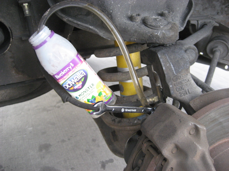

By the way, you can bleed these pretty easily by yourself.
I use a clear hose that fits over the bleeder, that way you can see when air bubbles have stopped coming out, and when the fluid is coming out clear, also it keeps air from being pulled back into the system.

UPDATE:
I bled the brakes, and got my pedal back.
This will need a little test driving to see if anything else is wrong..
