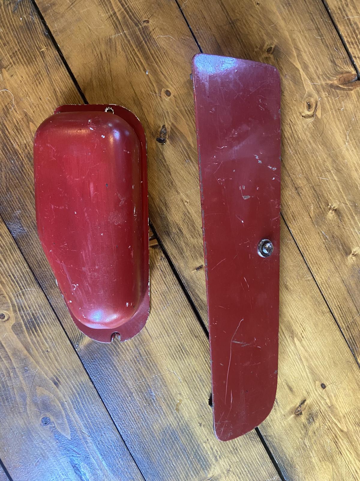

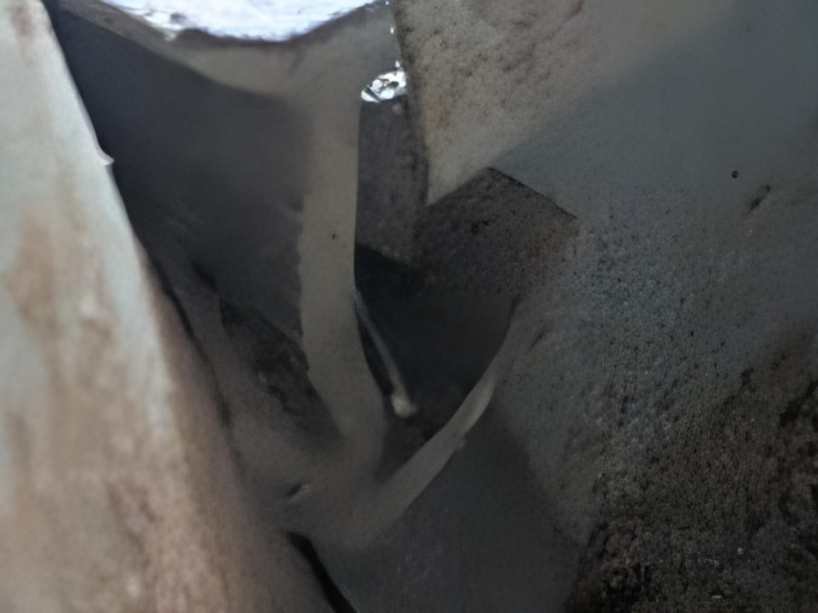

I searched and suprised to find we dont have a thread with this question for all the things we (I) didnt document when removing.
Been 3 years since I removed these..they look familiar but..
Where do these go on my '68 Coupe??
Mod Edit: Not a bad idea for a Sticky. Don't forget to add the date of your Ghia and if it's a Coupe or Convertible.
Disc
Joined: September 24, 2009
Posts: 632
Location: Europe
Disc is offline
PostPosted: Thu Dec 08, 2011 3:07 pm    Post subject: Reply with quote

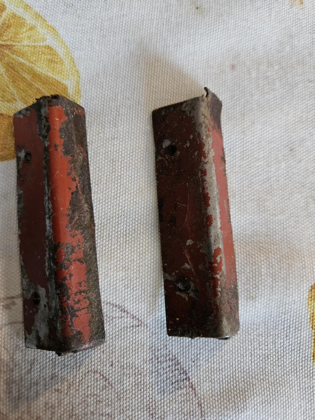

This is remains of door alignment wedge:
The glory never gets old, just need new paint.
Nick
c21darrel
Joined: January 22, 2009
Posts: 8236
Location: San Dimas
c21darrel is offline
PostPosted: Thu Dec 08, 2011 4:43 pm    Post subject: Reply with quote
Awesome Disc, Thanks. They were in the bag w/ door stuff too, guess my organization isnt completely crap afterall.

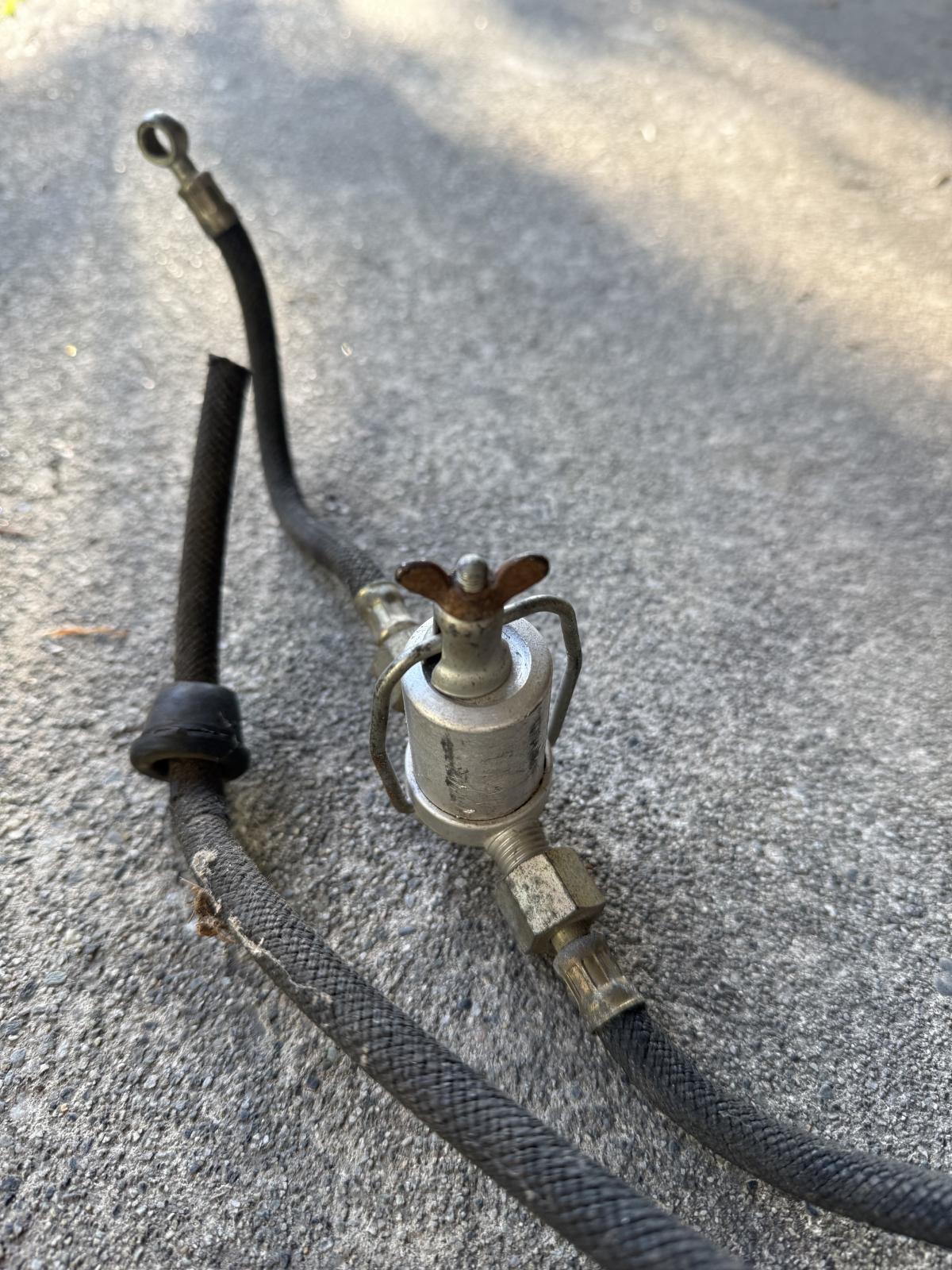

Where does this hose go to?? I have a stock air cleaner. Larger diameter hose, one end goes to the bottom front of the air cleaner, hose goes under the air cleaner to??????? Thanks in advance.

^^^Year? A pic wuold help to.

For a '73 Ghia, you will have a small hose that connects to the oil breather on the generator stand, and a large hose that connects to the preheater duct which collects warm waste air from the behind cylinders 1 and 2, and feeds it to the air cleaner. The duct should be between the pulley and the right heater hose.

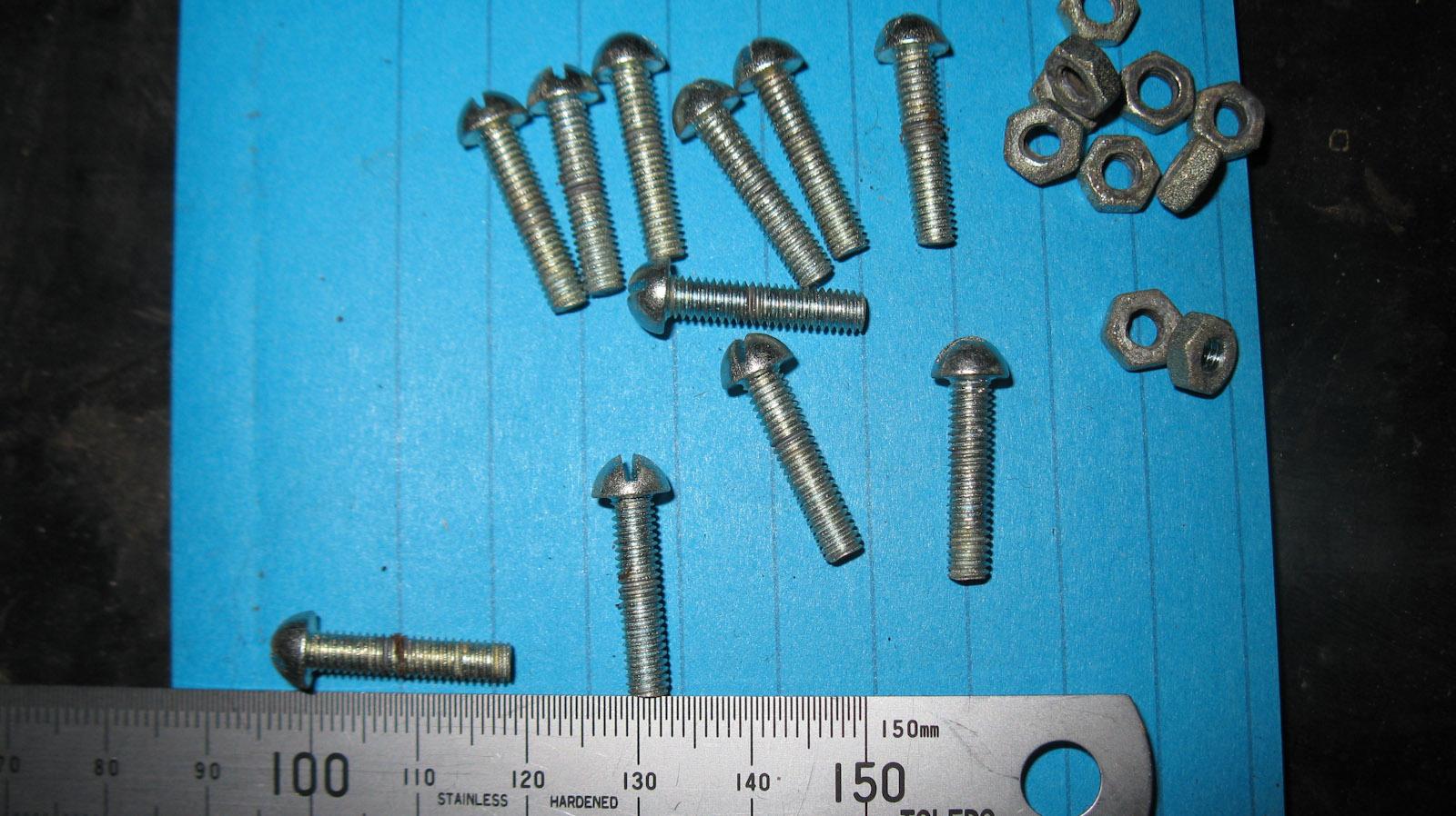

My memory fails me. Does anyone have a suggestion here these screws and nuts come from? There are 11 of them although it would be unsurprising if any are lost. They were off my '66 cabriolet and removed early in the project. I bagged them and when they came back from the electroplaters the labelled bag was a different one. Crying or Very sad
