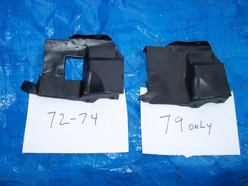

Tins
'72-'74 corner tin (Smooth):
(Notice the VIN number. It's a '74)
'75-'76 corner tin (Hole/Preheat System):
'77-'79 corner tin (Bump):
'72-'74 right front tin

75-76 Only Preheat System
#24: Cross over Pipe (Part of preheat system)
The more I get into it the more I realize '74/'75 were just weird transition years. Even parts vendors have the cut off date wrong on certain parts. Heater boxes for example; Bus Depot has these listed as fitting all the years minus '75-'78. I'm guessing in actuality the triangle port heater boxes didn't start until either model year '76 (August '75) or sometime after January 1976.

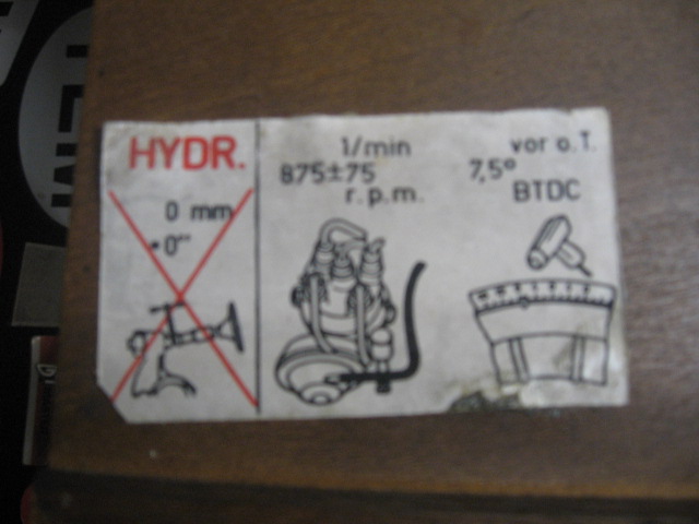

Thanks for the positive feed back! This took me a few weeks of surfing Samba and other sites to gather up what I did.
I know that some fan shrouds had a sticker from VW on them indicating NOT to adjust the rockers because they were hydraulic. Can't find a good picture though.
i have a 90% good sticker....ill try and get a picture.
