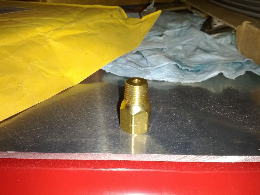

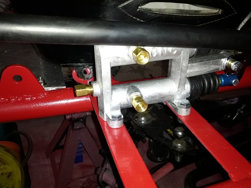

PostPosted: Wed May 02, 2012 6:42 pm    Post subject: Reply with quote
Thanks for all the comments. Thought I'd post some pics to clear up what I'm working with.
In the first pic below you can see three fittings attached to the body. Apparently I need to use sealant on the threads that attach to the body.
[/img]
Closeup of one of the fittings in next pic.
After reading through the posts I think I'm going to go with the red loctite unless someone has a better idea.
Thanks!
