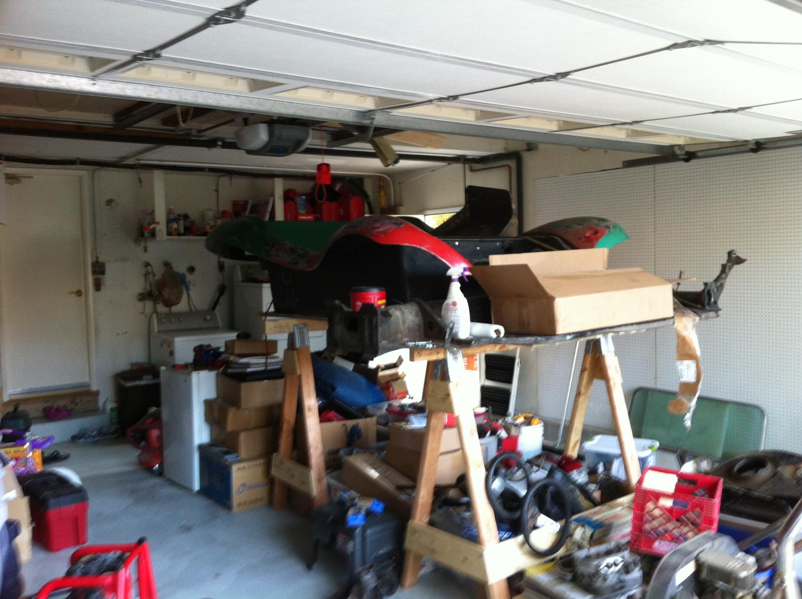

so now I am working on the pan
I built a rotisserie

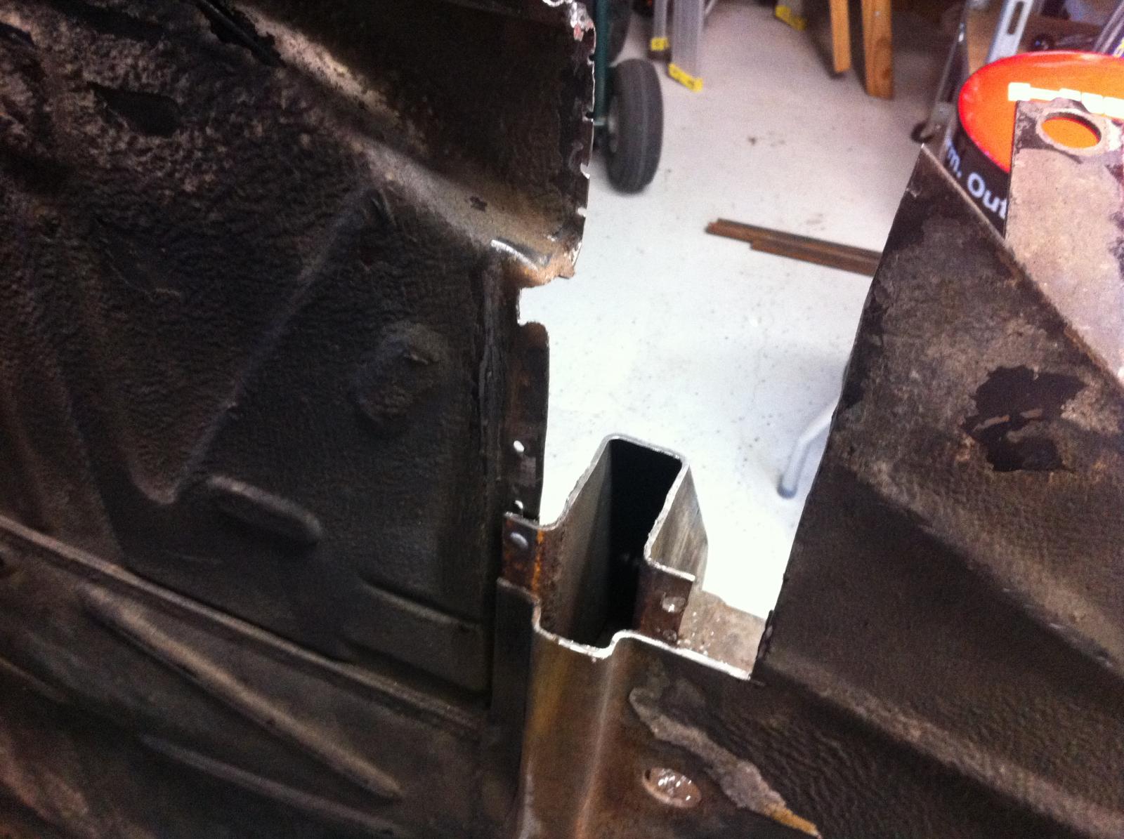

the pan I got was already shortened. I took some measurements and it looks like all is lined up. the bottom of the tunnel wasn't welded however.
the PO made a chevron style cut.

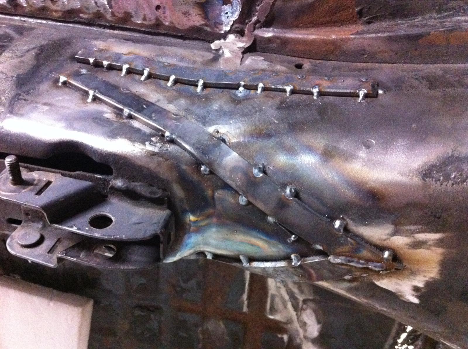

A buddy of mine is acting as my welding tutor. the bottom weld he did however, since it was a little messy.
before
after
ground down the weld then added some flatbar as reinforcement on the bottom
Used a torch to heat and bang some flatbar onto the top / side of the tunnel. just tacked them in for now

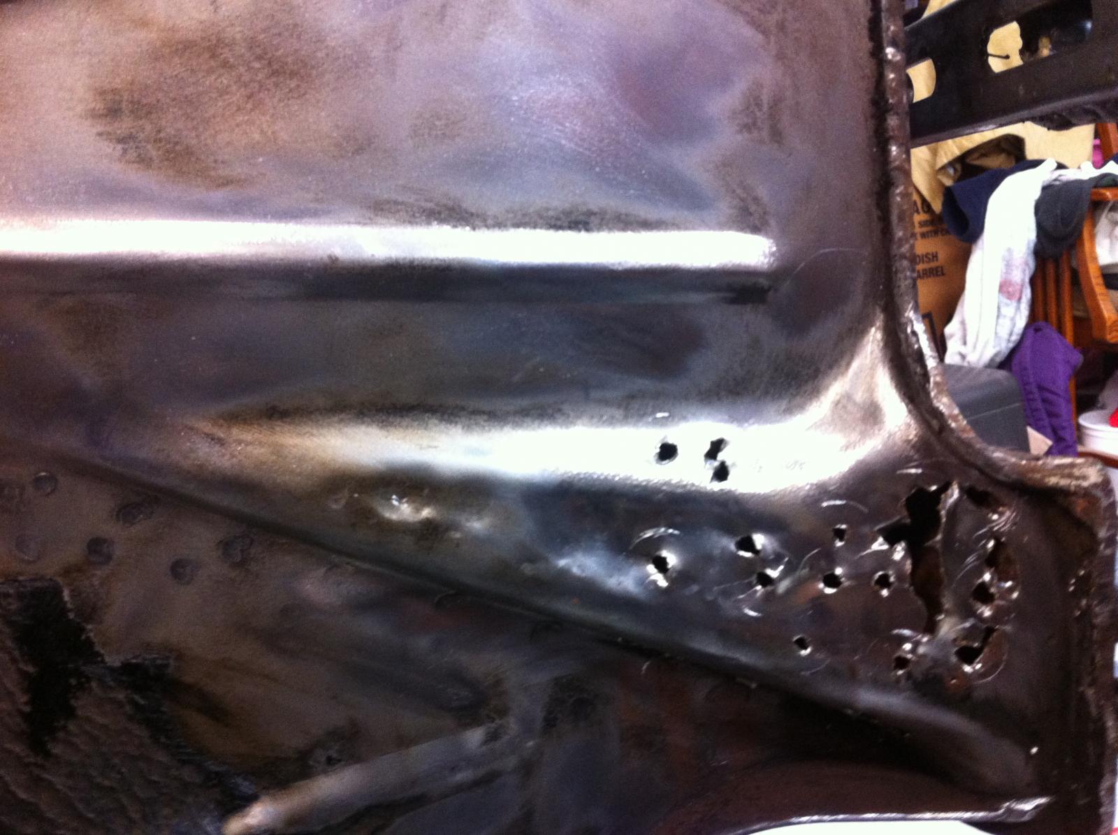

so now on to the rust.
the ends of the front "napoleon's hat" were rusted out and cracked, both sides
it isn't pretty underneath either
so I cut out the rusted parts. The front of the pans are OK however
some rust inside the napolean's hat. will use some POR-15 in here

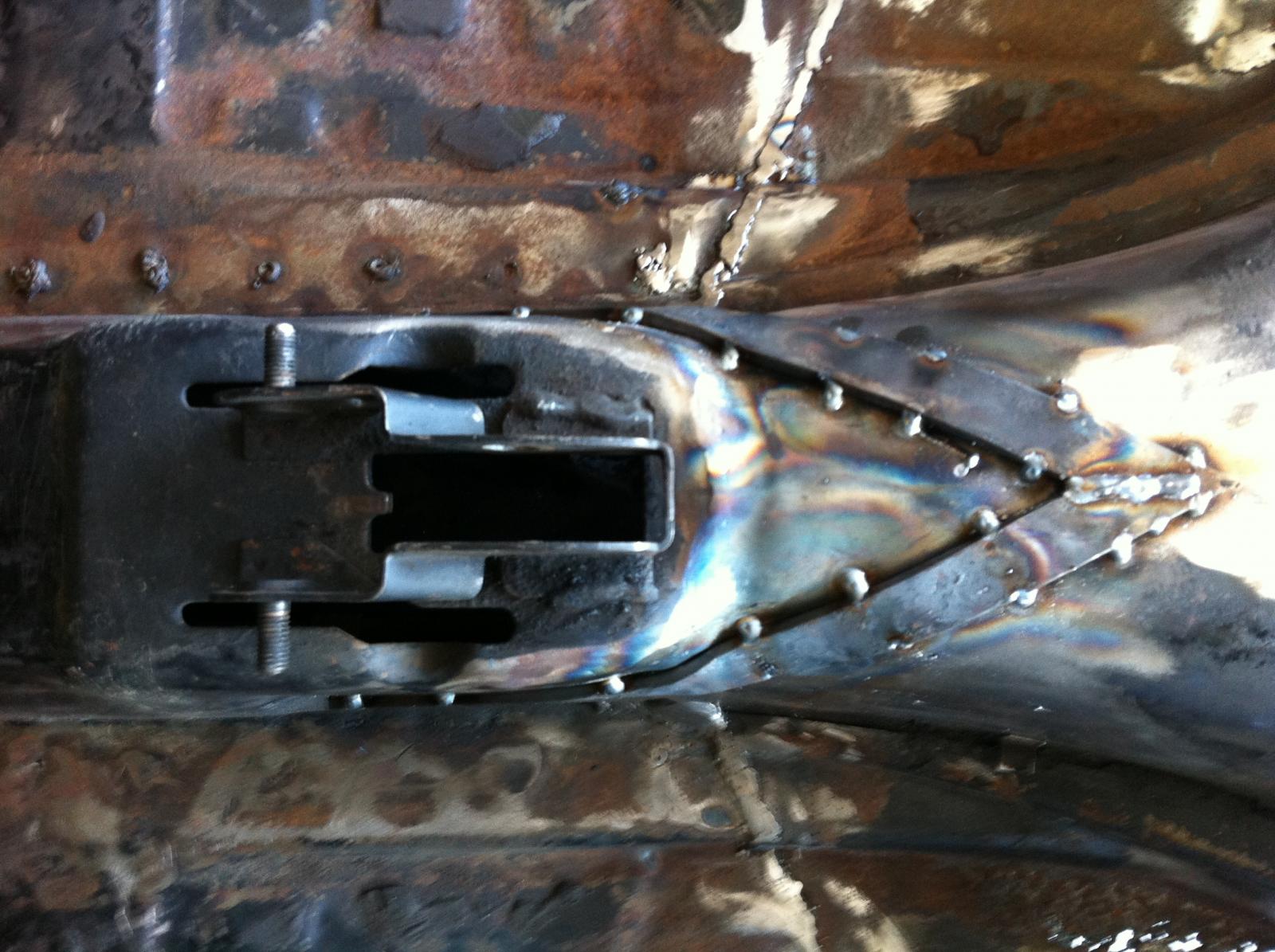

back of the pans had some rust issues too.
One side I was able to just fill in with weld and a small piece of sheet metal
the other side I had to cut out the bad metal.
I welded in some new metal. will add a picture soon

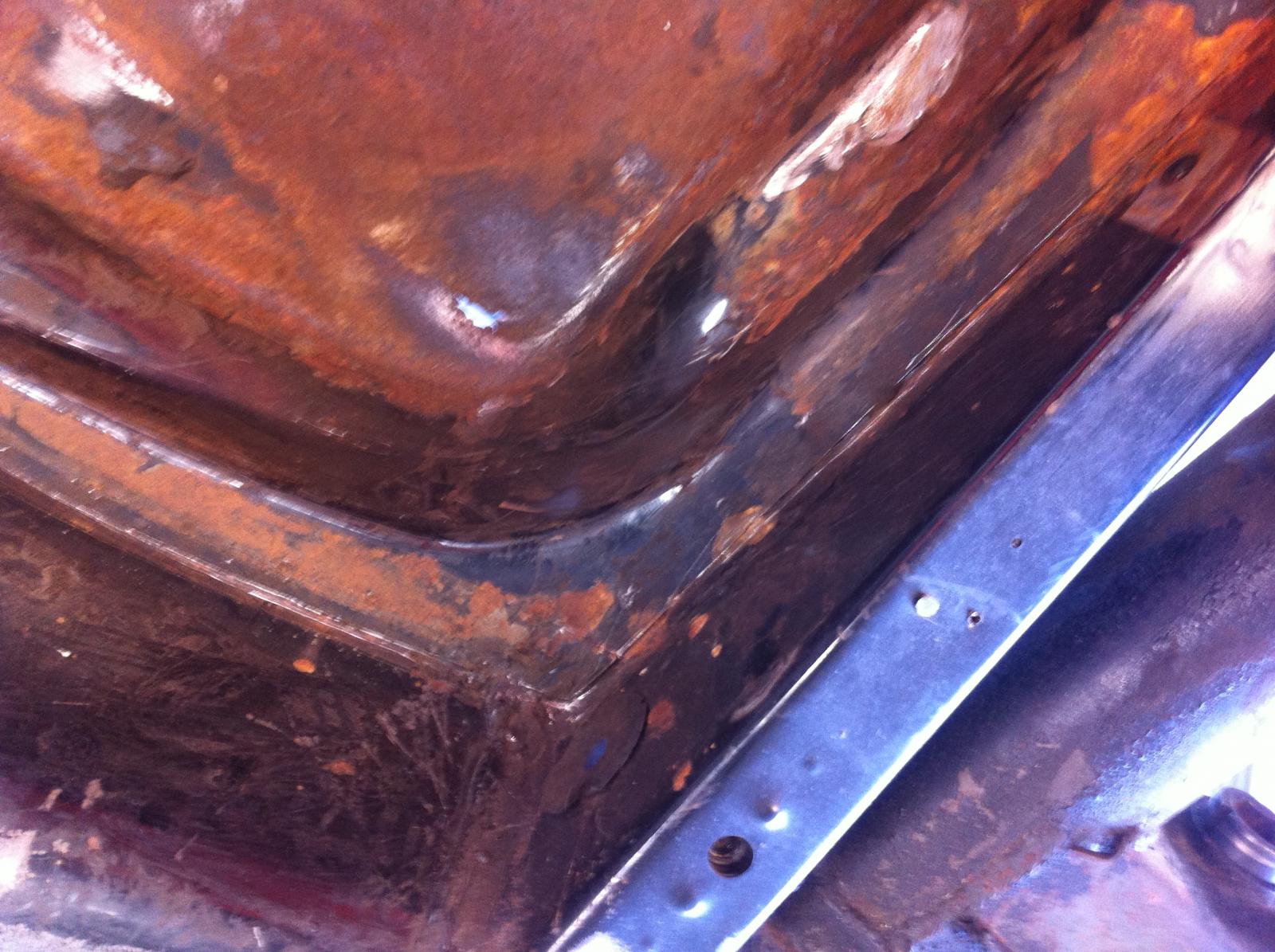

started to address the bottom of the frame head. there was a small rust hole on one side of the bottom framehead.
so I decided to wire wheel it and see what I am dealing with. Not exactly what I was hoping for. all these dimples showed up in the metal after hitting it with the wire wheel. a poke with a screwdriver, and the hole in the metal was complete. then another, then another until finally:
the rest of the bottom of the frame head looks OK. went around with a hammer hitting all over and the metal seems pretty strong. Just this one spot is hurting.
So I said enough of this and sent the pan, along with a few other items, on to my local media blaster. no more yellow front beam!!
I want to know what I am dealing with and don't want any more rust surprises.

so I am thinking on cutting the bad metal out to check out the integrity of the steel inside the frame head. If it looks OK, then my plan is to fill in the holes with weld and then weld the cut piece back in. Put some POR-15 inside maybe?
I have sheet metal I can reinforce this area with.
Anyone have experience with this kind of repair?
When I get them in that shape, I usually replace the full "bat wing" and move on. For me, it saves time and then I know I have gotten all the weakness out of an important structural frame area.

thanks Joe. so that is my dilemma. cut it all out and replace it all, or leave as much of the OE metal as I can and just repair the bad parts. this goes for the napolean hat as well.
By bat wing I assume you mean the frame head bottom plate?
If I could find a good quality OE bottom plate then I would love to remove the whole thing and just replace it. No brainer.
Of course, the one i saw at my local VW shop had thinner metal than OE.
The napolean hat I bought from there had thinner metal as well.
So I bought another napolean hat from another shop and it was the same POS.
so where is a good shop where I can get good quality parts for this repair?
my third option is look for a replacement frame head at a junkyard. No luck with this so far.
stumped.................
thank you all for your help

Yes, "Bat Wing" is the bottom frame head plate. Different one for the L&P -vrs- the Ball Joint. The after market bat wings are decent, they are thick metal and come pretty close to fitting.
I agree on the Nepol Hat. They are thin and do not fit very well. I buy them and graft in the parts that are rusted badly, (curved areas, flat areas I use proper thickness sheet steel).
Chances are any used frame head you get will also need repair in some area.

thanks Joe,
OK got it.
I am planning on splicing in the ends of the napolean hat. I will be using some DOM tubing around the pan perimeter to reinforce the pan and provide a body lift. I havent decided on a size yet. I saw a thread where you did the same thing with vwbowtieman that looked great. this tubing should overcome any structural deficiencies caused by the thinner metal on the napolean hat.
for the bat wing, well, I guess she is gonna have to come out. As much as I would like to keep the OE metal, it is what I cant see inside the head that worries me.
lets see what she looks like when she comes back from the blaster..........
