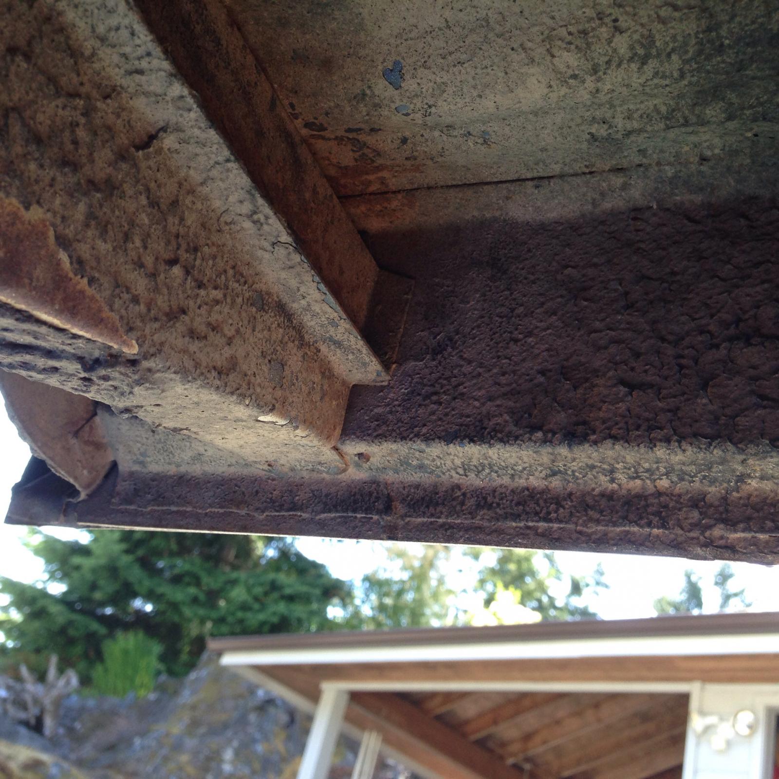

Im in the same situation. I want to protect the underside of my 72 bus.
I do not want to remove the factory undercoat as most of it is in good shape, but in some areas it has peeled off and is showing surface rust.
I was thinking of wirebrushing the loose areas, and the bare areas then applying a rust paint such as eastwood rust block, or POR15. But after that I wanted to put on a similar product to the factory. I do not drive my car in salt and try to avoid rain so its more of a peace of mind.
I was thinking the 3M undercoating spray or the eastwood undercoating spray:
http://www.eastwood.com/ew-rubberized-rust-encapsulator-blk-aero-15-oz.html
http://www.amazon.com/3M-03584-Professional-Rubberized-Undercoating/dp/B002H9CMCQ
Then there is this product that Ive heard good things about:
http://www.noxudolusa.com/product/noxudol-900-aerosol/
Any thoughts on these vs each other?
Right now it looks like this:
Some areas in question that I want to clean up:
There is a place in town that says they will do it for about $400, I dont mind paying the extra to have it done right. They can lay down a thicker material with proper guns and said they powerwash, then wirewheel any loose areas, prime exposed areas then apply an undercoating that dries hard.

All the rattle can spray on undercoats I have used were VERY thin, nothing like the original stuff. I have used this 3M schutz. Its the real deal and it works very well, seems to hold up well. Keeps noise down too. Good idea on killing rust first.
http://www.amazon.com/3M-08864-Schutz-Rubberized-Coating/dp/B000PEQGMM
