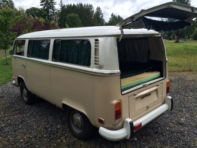

Last weekend I picked up a 72 Sunroof Bus. Im the 2nd owner and overall the bus is super clean, 70% OG paint and no rust. It also came with boxes of extra OG new parts. Door handles, interior bits, rubbers for windows, doors etc, extra chrome trim, sunroof cable (just one...boo), the orignal solex carbs, extra calliper and rotor, and other bits and pieces.
I wanted to get a westy tin-top but it was hard to find one as clean as this so Im going to camperize it.
I wanted to ask if there are any good threads or how-tos for camperizing a bus? I found interior out of a 76, thats pretty straight forward but my main questions are how to get the camping electrical to work, how to hook up the 2nd battery etc. Im not going to bother with the sink (I dont think) unless there is a easy way to do so. Id prefer not to cut a hole in the side of the bus for the hookup either, I was thinking I could run a cord out the door or a window to plugin.
As well I would like to remove the front tire. Its got the factory mount on it, which appears to be riveted in place? How can this be removed without causing much damage. Will it need to be re painted?

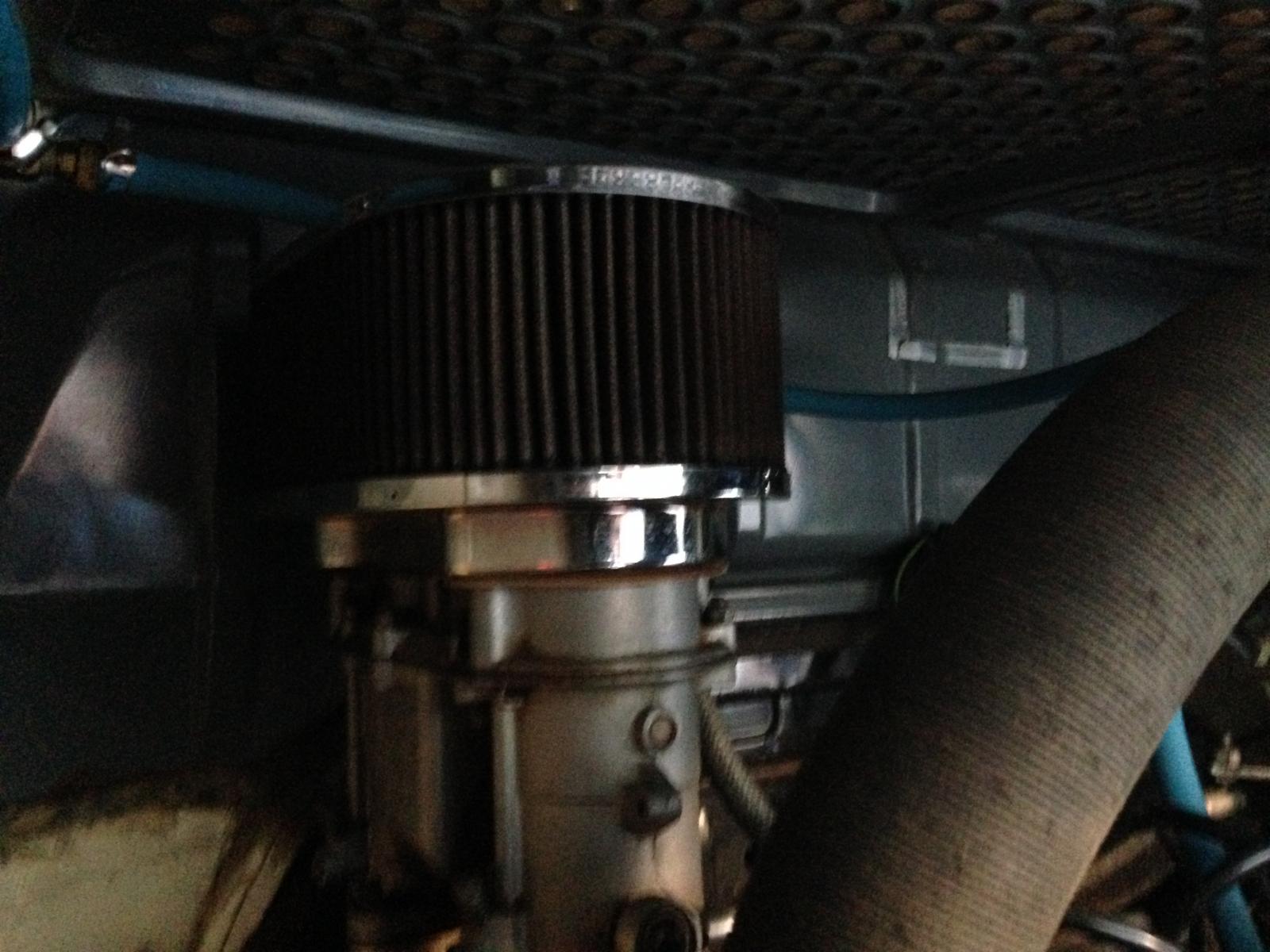

Here are some pics. Just realized I have none of the engine compartment ill get some up tomorrow.

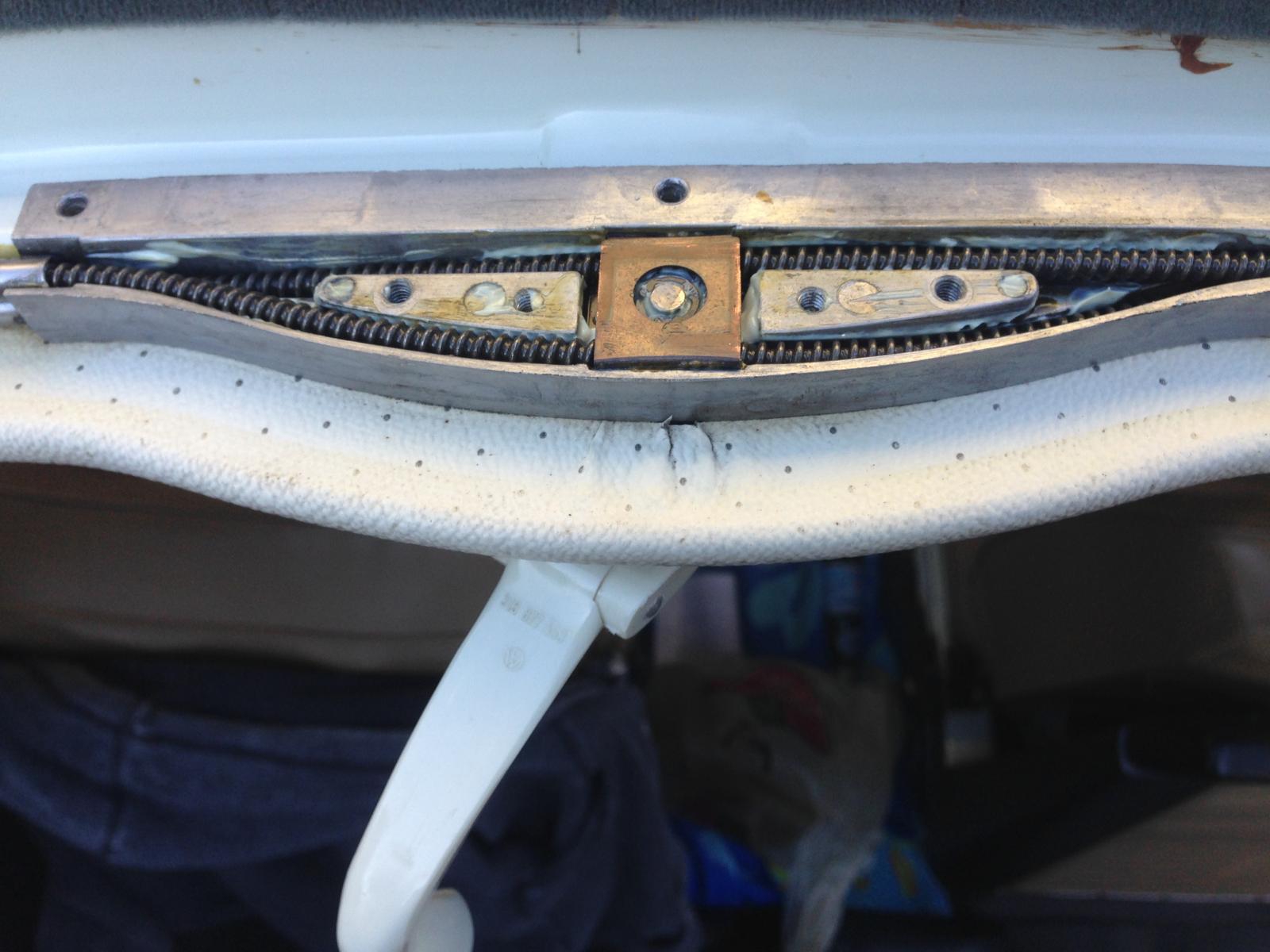

- Clean and re-grease sunroof cables - DONE

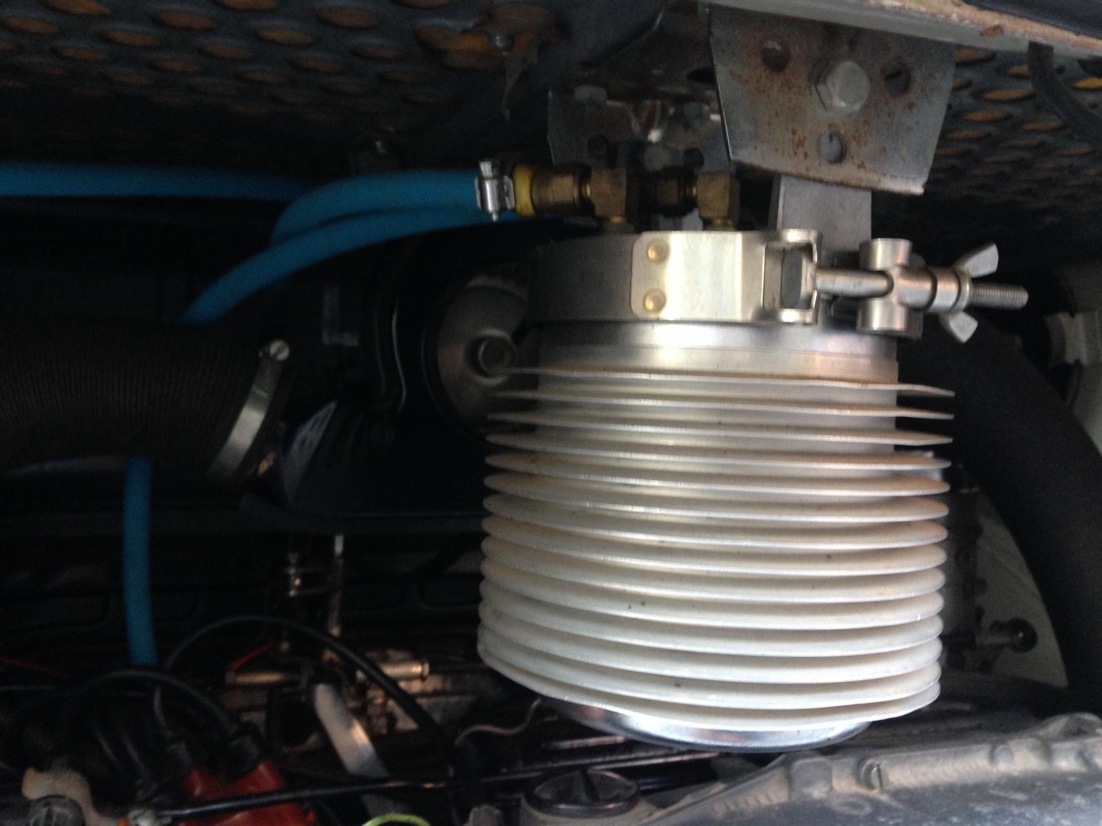

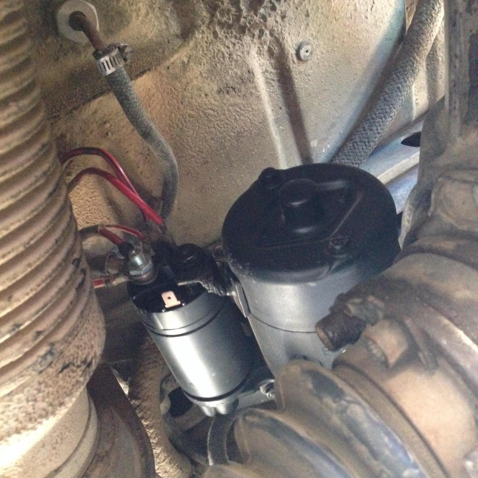

PostPosted: Tue Jun 24, 2014 6:16 pm    Post subject: Questions about wiring etc and the undercarriage Reply with quote

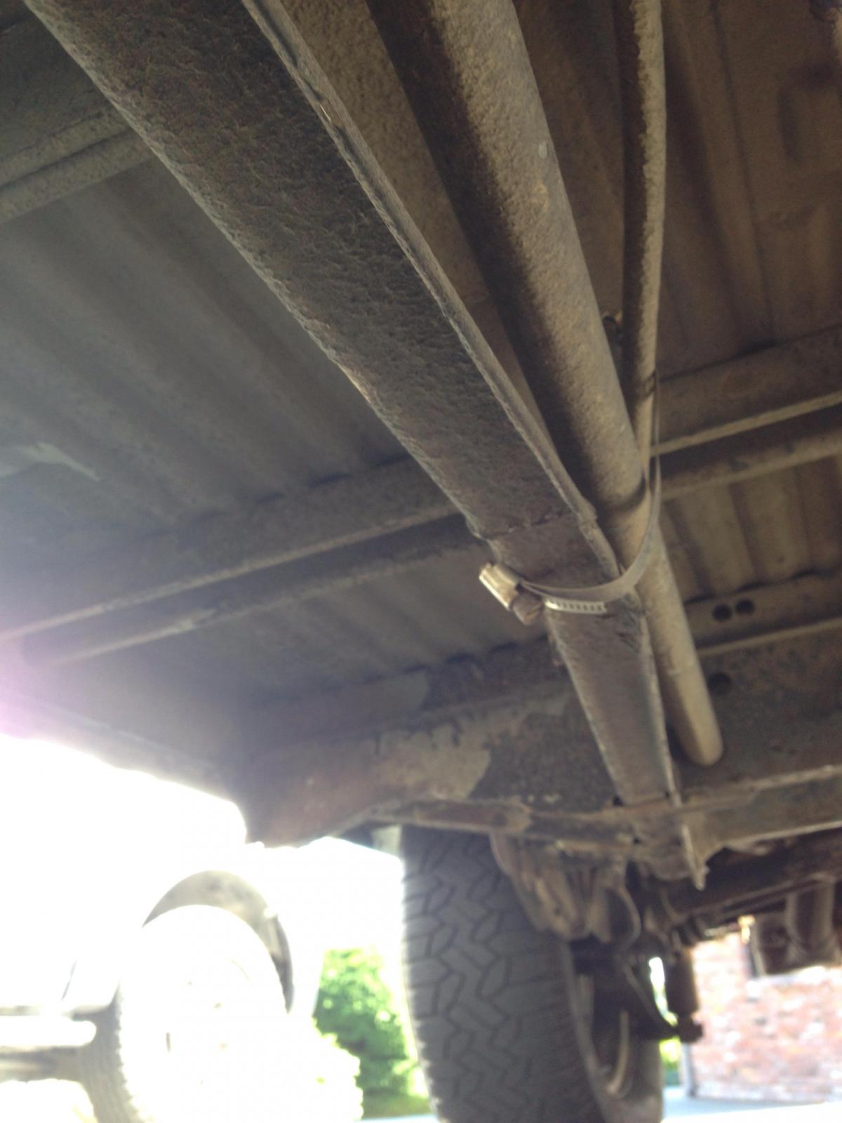

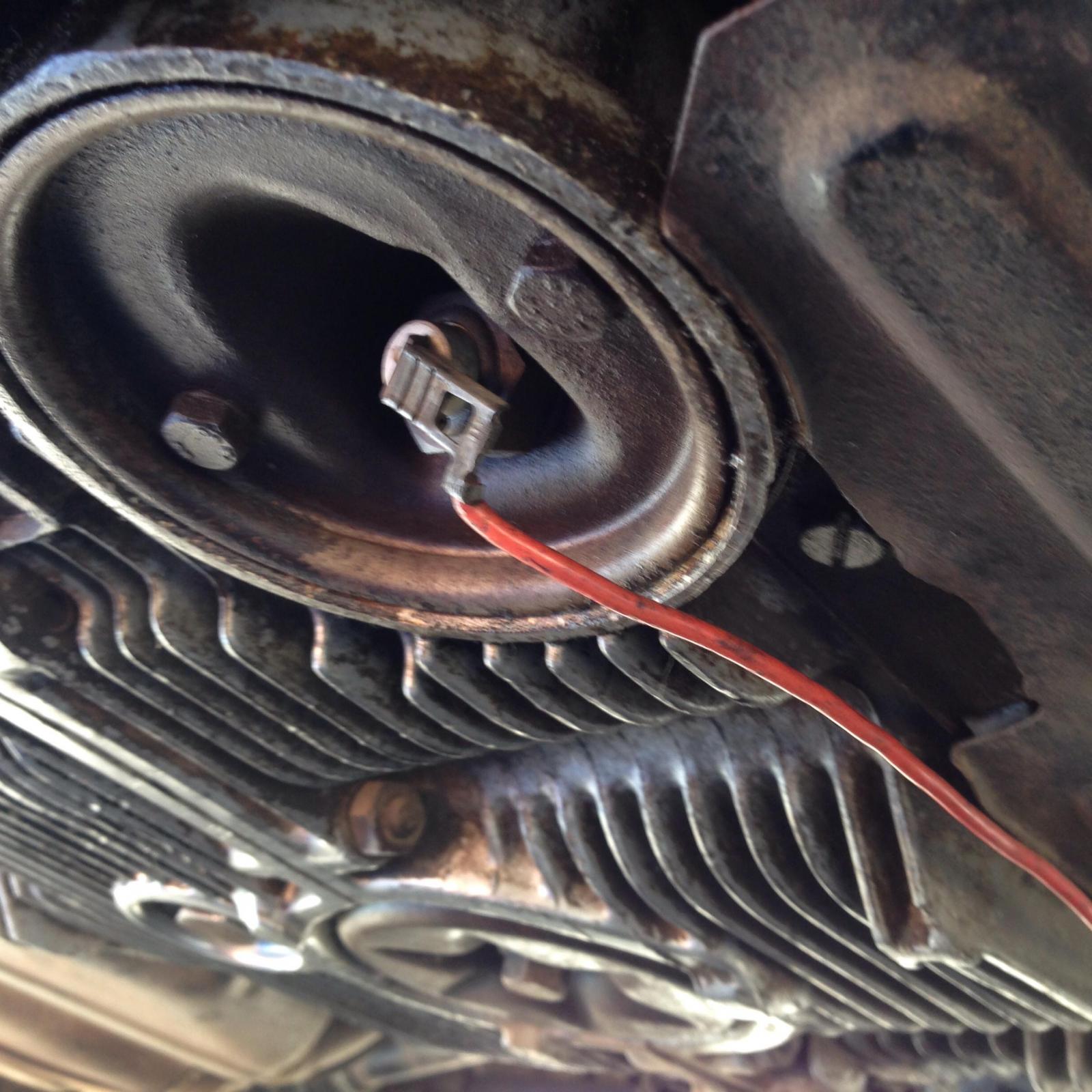

Also I took some shots of the undercarriage here and wanted to get some peoples opinions on how things looked in general. Apparently the fuel lines are in good shape, I had it checked out before I drove it home. But I want to see for my self and not even sure where to look, besides the ones coming off the carbs I then lose them. Is there anything else I should look into for safety etc?

What is this wire running to?
New starter? So does my bus have an electric ignition?
What is this line running down the side?
What are these three cables for?

I would strongly discourage you from making your bus into a camper. You could sell that bus and buy a camper easily. That being said it is your bus and you can bring down the value if you want.
That front tire was not put on by the factory. Unbolt the tire and see how the mount is held on there.
The first wire you asked about is an oil temperature gauge wire.
All buses have "electric ignition" when talking about the starter Laughing . Electronic ignition is referring to how your bus gets its spark for the spark plugs.
That line and those cables are for the power brake booster, clutch cable, throttle cable, ect
I would leave the underside of the bus alone...doing a good job under there is very time consuming and what you have now will last for years. Just make sure there is no bare metal showing or rust starting

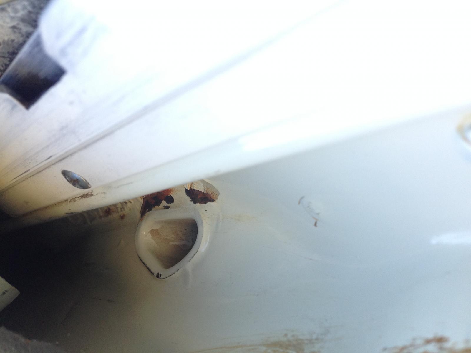

Really I was told it was put on like that from the factory, or dealership then I guess? The mount looks like this:
Sorry I must of sated that wrong I was wondering if its possible to tell from the starter if its got electric ignition. Any other signs? Sorry for being a noob! The oldest car I have had was a 76' Ford.
There are a few bare spots under the bus, where the undercoating has completely peeled away and its starting to get a bit of surface rust. What can I do about those spots? Thats more so what I am worried about.
Should I apply POR-15 Rust Preventive Coating?
Here is a spot for instance, left middle of the photo:

It's already got a mattress and curtains so the back seat must fold into a bed.
I'd say your bus is already a day camper of some sort already. This explains the front tire placement.
Check your rear seat and see if it has a z-bed kit on it. No one wit a Westy uses the fridge and stove as much as you'd think. The bus as you have it now is far more rare and desirable as is.
It also looks like you had one of the best previous owners known to man. Go find the dude you bought that from and give him a hug for showing the bus as much love as he did. All I see in those pic is care and work already done for you.
I wouldn't trust any braided line anymore. I would suggest adding *replace all fuel and vapor lines* to your "To Do" list. All your questions can be answered with some searching here. That would be a great idea before doing anything else on this bus. Smile
And, of course it's your bus and you can do as you like, but I would save anything original you remove, and do not do anything permanent, or even semi-permanent (like lowering). Not trying to nag, just offering advise!

Im not going to molest it. Again thats why Im here I want feedback. I don't want to do anything permanent to the bus that cant be put back to original.
Is anyone noticing the things I am? Most have PO horror stories-you do not.
I spent about 6 months finding the right bus. Thanks Smile
It does not have the folding seats. The seats have all been removed in the back and are safely in storage.
It has a makeshift bed the last owner built. Which I could live with, I just wanted to have it look cleaner with the westy bed and storage. I would not use the sink, stove, or fridge unit I would leave that out. I assumed that the bed, and storage wouldn't cause any major permanent damage? Correct me if I'm wrong.

The smaller one with the clamp on it is one of your fuel lines. It’s not difficult at all to do the ones you can see. Most of the vapor lines are behind the firewall and are not really difficult, but a bit tedious to get to. If you are going to enjoy this vehicle I would suggest you do as much as you can yourself. There are good mechanics out there, but odds are you aren’t near one. And, you need to find someone who is familiar with air cooled VWs and T4s specifically. It would be a good idea to become friends with local VW club members if you have anything nearby, and use the samba often and before you (or your garage) attempt any repairs.
Sit in the front with a friend and it’ll look fine. Smile A little high in the front with no load is normal.
FYI, I just put new shocks on the rear of my bus recently and it seems to have leveled it out a little bit.

PostPosted: Wed Jun 25, 2014 8:47 pm    Post subject: Engine Compartment Shots and Questions Reply with quote
Did these bus' come with rear seatbelts for the rear 2 benches? I did not see any sign of them being in the bus, nor are they in the boxes of stuff.

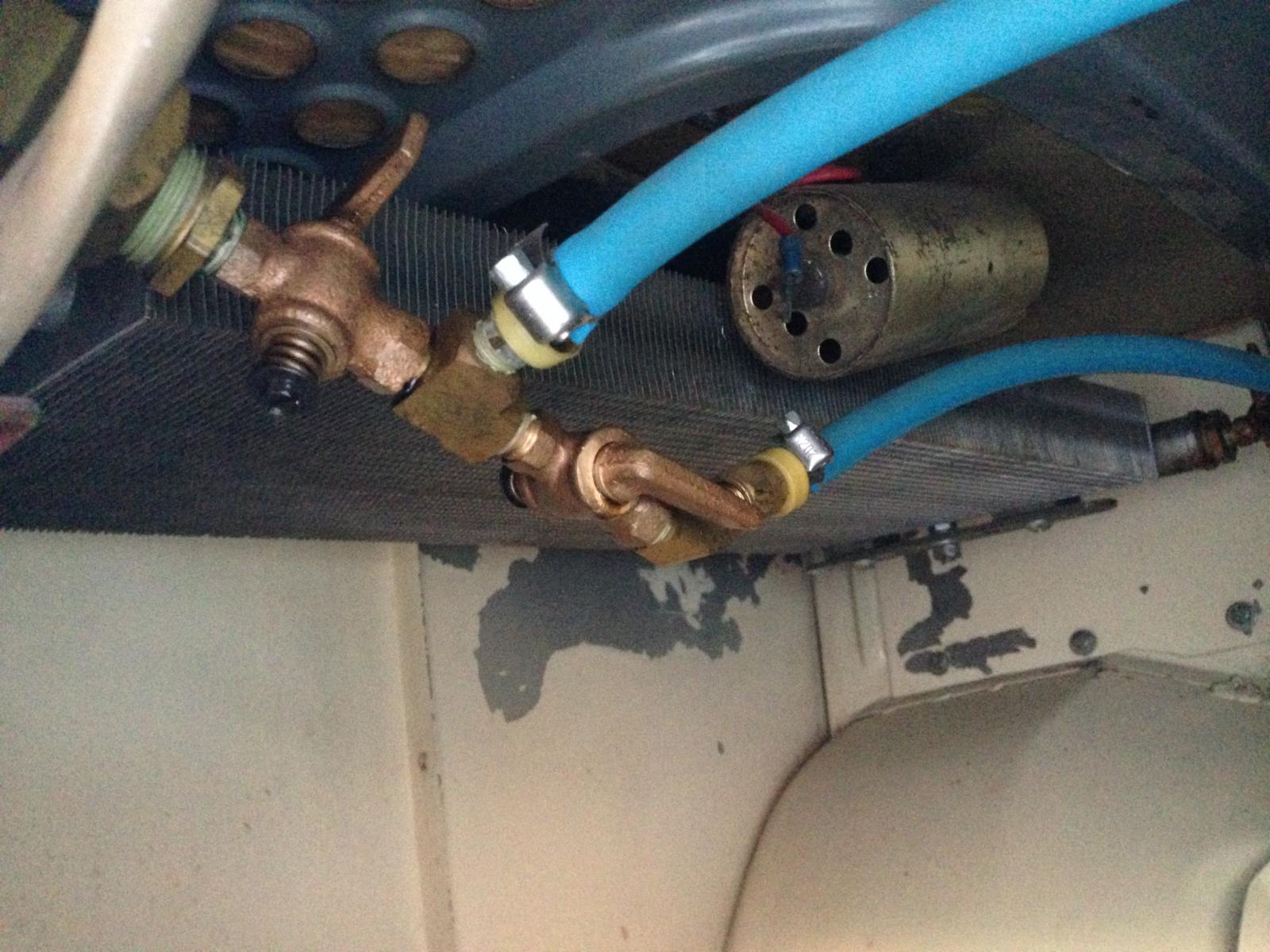

Here are some shots of the engine bay. Whats the deal with this oil cooler?
Any other notes from people?

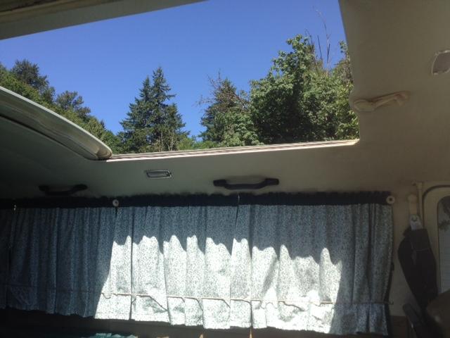

As well I cleaned up the sunroof today. Man it was clean already didn't have to do much, applied a bit of grease and cleaned a bit. Any thoughts on what I can do about these rust spots?

PostPosted: Fri Jun 27, 2014 7:55 am    Post subject: Reply with quote
Add *install engine compartment seal* to the TOP of your to-do list! Smile
http://www.busdepot.com/411813225
(smooth side down)

matt94gt
Joined: April 29, 2014
Posts: 245
Location: Victoria BC, Canada
matt94gt is offline
PostPosted: Fri Jun 27, 2014 8:29 am    Post subject: Reply with quote
(smooth side down)
Already ordered one. Thanks.

PostPosted: Fri Jun 27, 2014 5:36 pm    Post subject: Re: Engine Compartment Shots and Questions Reply with quote
Rears are easy to find in the classifieds or at swaps, middles are scarce like unicorn poop, the universal ones most VW parts sellers as well as any FLAPS or custom car supplier sell work very well and are more passenger friendly than the OG ones (stiff old webbing is hard to adjust).
Go to Canadian tire and get a little can of this stuff:
Sand and scrape off the loose crap and carefully dab on a couple of coats, then you can top coat a few days later with matching white when it's fully dry.
I'd ditch that whole oil filter setup, not only would it make maintenance in that hatchless 72 engine compartment a job for a double jointed gymnast with eyes on the ends of thier fingers the plumbing nightmare and extra hoses are a sudden engine seizing leak just waiting to happen, scary s**t IMO and the OG filter is very adequate by itself. Some hotrod dude would likely fund another order of parts for that.

With the rust spot on the hot air duct hole, get a dremmel and wire brush attachments, dremmel it down to clean bare metal as best you can, clean with white spirit, apply phosphoric acid and let it cure to eliminate the oxidization in the metal, then apply a zinc based primer with brush, sand it when dry, apply the white top coat(s) then lacquer.
That sounds like a perfect idea. Might have to get one from here:
http://www.delmarretro.com/Work.html
Unless anyone knows where I can find some z-bed hardware. I think Ill go this route thanks a lot!
