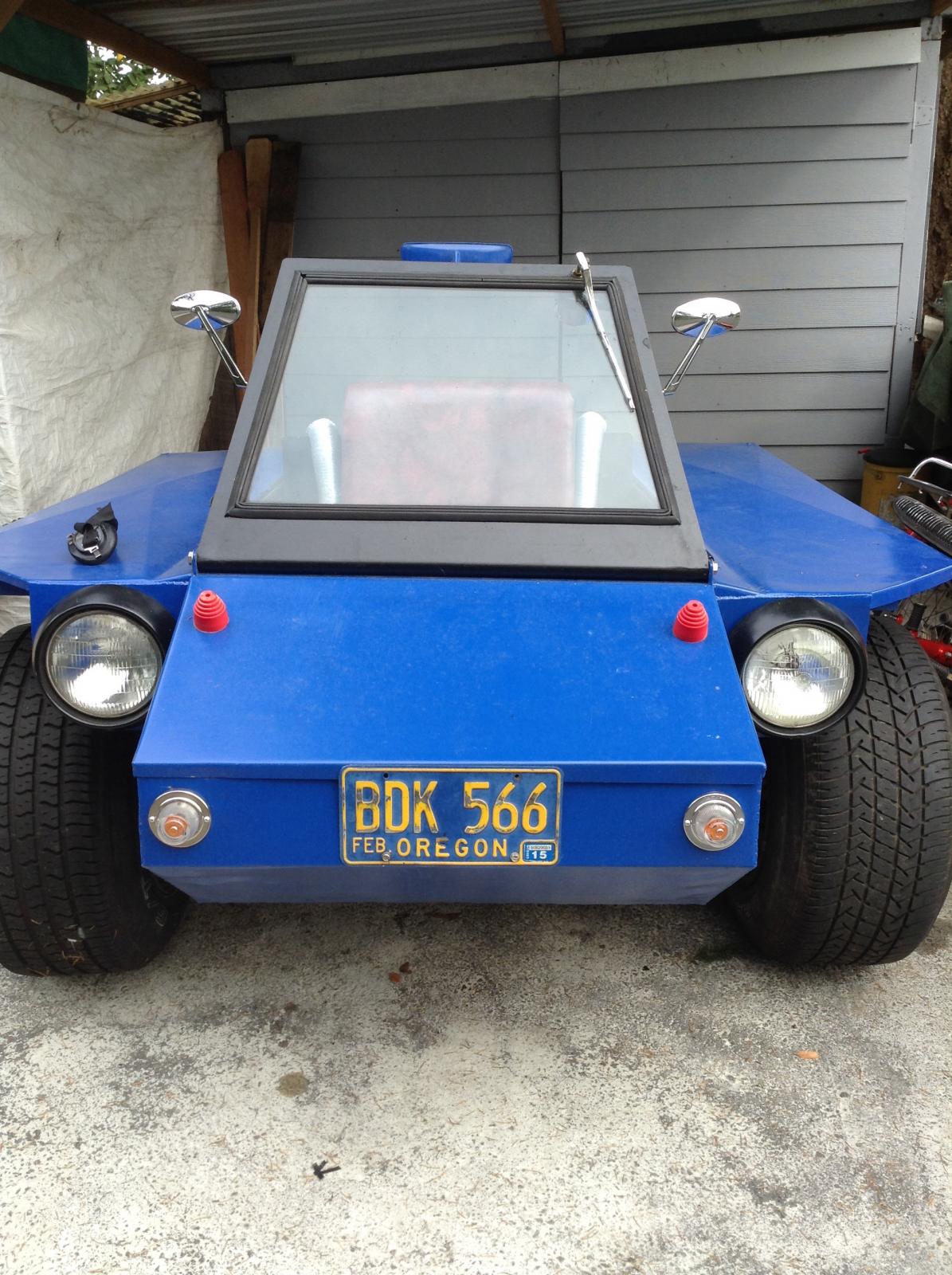

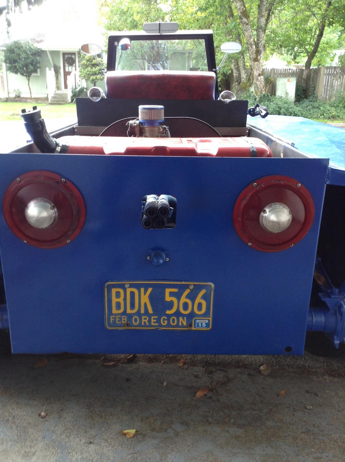

I have no clue where to look for reverse. My engine and tranny are reversed?
The shift linkage goes past the engine to the back of the tranny. So instead when your behind the car you see the tranny first instead of the engine if that makes sense. So I do not know where reverse would be. Any help would be greatly appreciated

I'm sorry but I tried for hours to put up some Picts and it's a homemade car

looks like a type 1 swing axle , so reverse at trans would be down and out so on shifter being reversed I would say to your right and forward
Just a guess not knowing more details ..

That is an awesome thing.
I'd say facing the nose cone, the coupling should be pulled outward and rotated as far as it will go counter-clockwise.
FWIW, I don't think that shifter will ever work well. I'd get a better engineered mid-engine shifter
