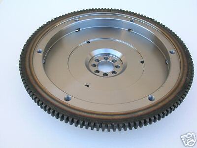

Hi all I need a lightened 8 dowelled flywheel but should I get a cast or forged one and why?
I'm not going to be racing my bug on a track at all and it will not be reved above 6000 RPM.

Saw this one on e-bay for $120, says it's supposed to be a lightened VW Flywheel. When I built my 1800cc Type 1 engine for my bus, I had an old stock VW flywheel surfaced and drilled for 8 dowels and balanced to the crank with the clutch but not lightened.
"VW Forged Lightened Chromoly Flywheel 8-Dowel Type-1"

The $79 cast flywheel are fine for a street engine if you're never going to drag race or see over 6000 RPM.
If your racing (street or track) or turning more RPM's then you should get a $120 forged chromoly flywheel or use a genuine VW flywheel.

IF you are racing you CANNOT use a cast flywheel, they are banned on NHRA tracks. There was a picture last year going around of a bug with the rear end blown off of it and the engine hanging on the accelerator cable after a cast flywheel exploded at the line injuring some people.

The cast iron flywheels are from mexican bugs. They are not very good, and not cheaper either. Get a modified OE flywheel from DPR, made of German STEEL

In NHRA drag racing the porsche and volkswagen flywheels were the only "STOCK" flywheels that were allowed to run on a turbo charged VW or Porsche engine. All other vehicles (chebys,fords etc) had to use an after market flywheel.
That should tell you something.
