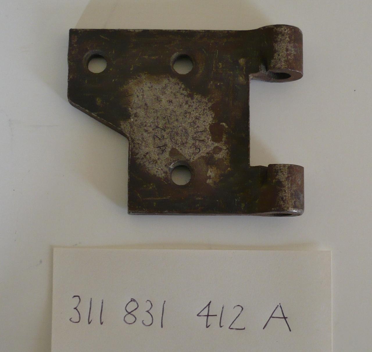

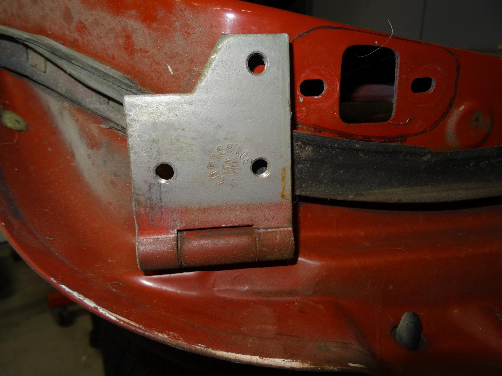

Anyone know the story behind the many versions of the 3 bolt hinge?
I bought a replacement hinge for the lower right side and discovered today that it's not the same as the hinge on my spare door.
315 831 412 stamped on the replacement hinge.
311 831 416 B stamped on the hinge mounted to the door.
Parts book lists them as follows:
311 831 405 D, Hinge half, upper left
311 831 406 B, Hinge half, upper right
311 831 415 B, Hinge half, lower left
311 831 416 B, Hinge half, lower right

Going off your pic, that looks like a "conversion" hinge, for allowing a late Fasty or Square door to be used on a Notch.
Notchbacks used 3 bolt hinges until the end of production, while Squares used them until very early into 66 production (then got 2 bolt hinges). Neil Mast (aka Notchback) has a great pictorial of the different doors type 3s used over the years, including the hinges supplied with them. It might be worth searching on here for the door changes guide, unless he posts it up. Wink I only say that, as there is a thread on the differences from a few years ago on here.

I did a search on 'door hinge', '3 bolt hinge', etc. and came back with what looked like half of the total threads posted since the site began. Rolling Eyes
Every 3 bolt hinge in the classifieds is the same as this one but for a different corner.
Your explanation sounds logical and I considered it but then wondered why these seem to be the only thing that can be found.

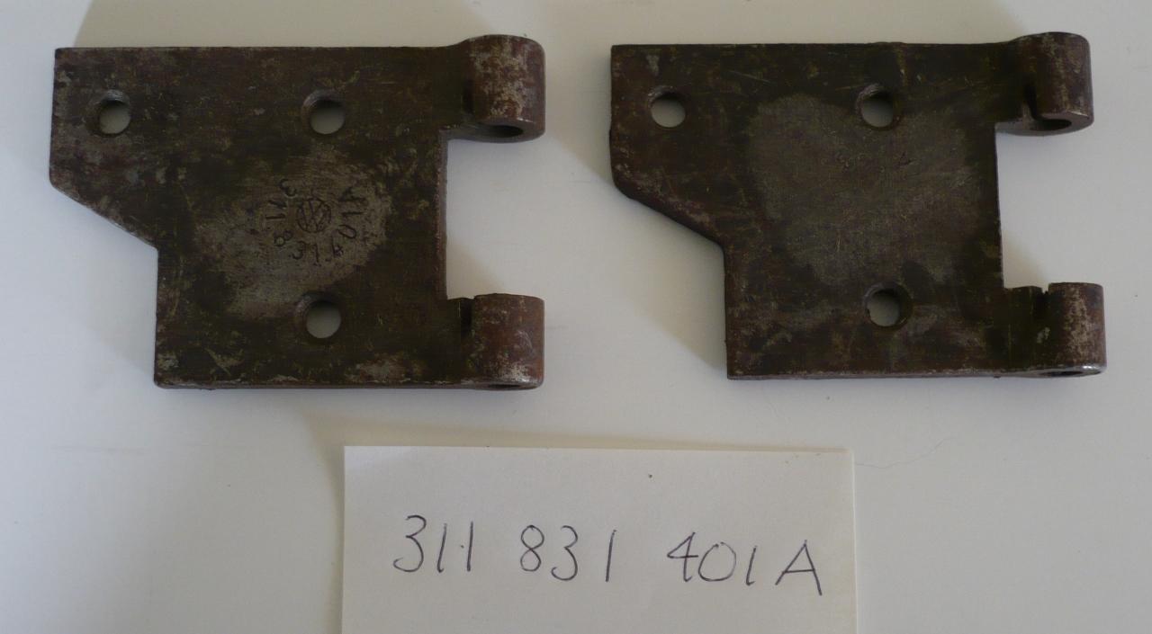

I tried to access the link, but was denied access, so I'm none the wiser.
I have some NOS hinges I want to sell but would like to know the applications to list in the ad.
Any help would be appreciated.

If the VW number logic is applied:
311 831 401A is the upper left hinge
311 831 402A is the upper right hinge
311 831 412A is the lower right hinge
The parts with 0 in the middle are upper hinges, 1 being the lower hinge.
The parts with odd numbers at the end are left side parts and the even numbers are right side parts.
This is how the previous hinges are numbered-there are quite a few variants actually-but they all follow the same 'logic' if you will.
vwed

Thank you for that.
So model/year wise, reading the above thread these would fit all notches up to end of production and squares to early 66 before they changed to two bolt hinges?

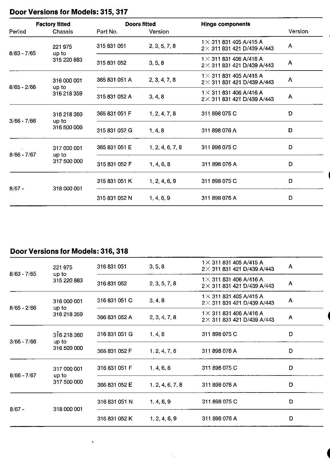

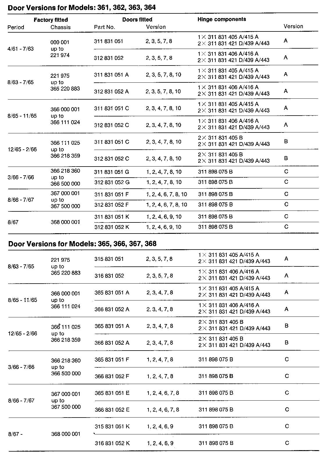

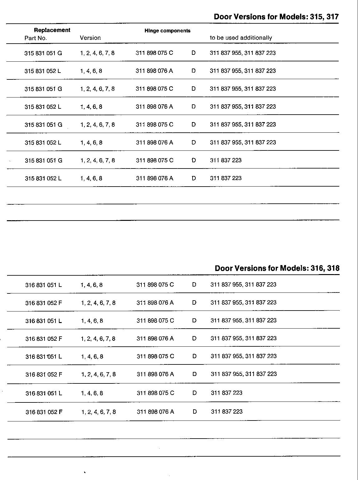

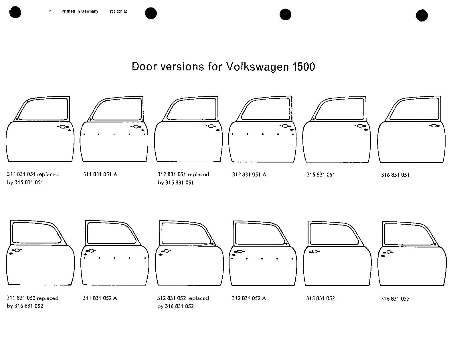

PostPosted: Thu Jan 14, 2016 5:14 pm    Post subject: Re: 3 bolt hinges Reply with quote
I finally uploaded the door information that was in Neil's link (now dead):
