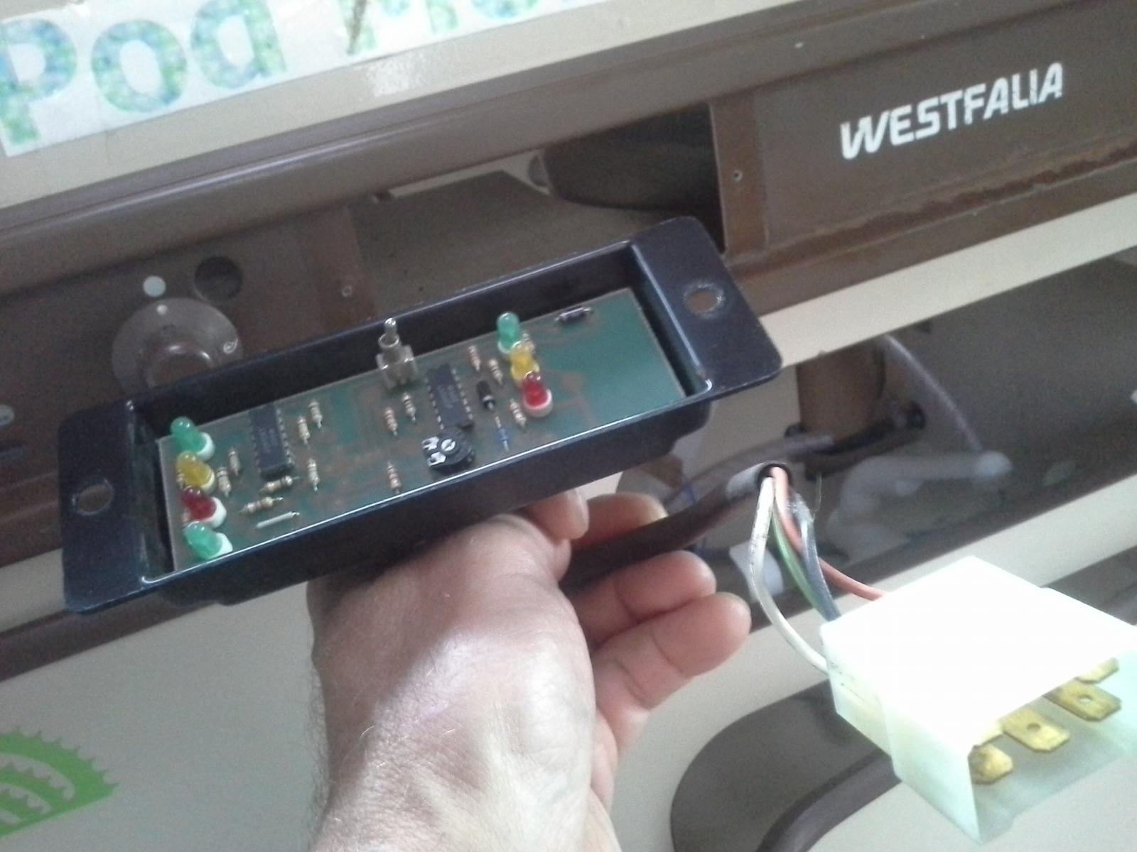

Only very early vans disabled the pump when the tank was empty. The photos show an led board without that feature so your pump should run even without the seniors wired up.

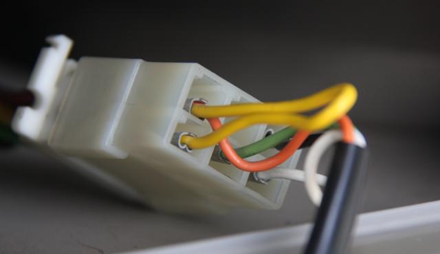

First, this should be a ground:
The pump's brown wire (ground) is connected to the black wire, which is connected into the level sensor black wire, which is connected to a ground point on the body/chassis (near the fridge).
billclimbs wrote:
next went to check the sensor connectors and they are not connected... Worse yet... I don't see where they would connect...
The panel connects to another white multi-pin connector, like this one:

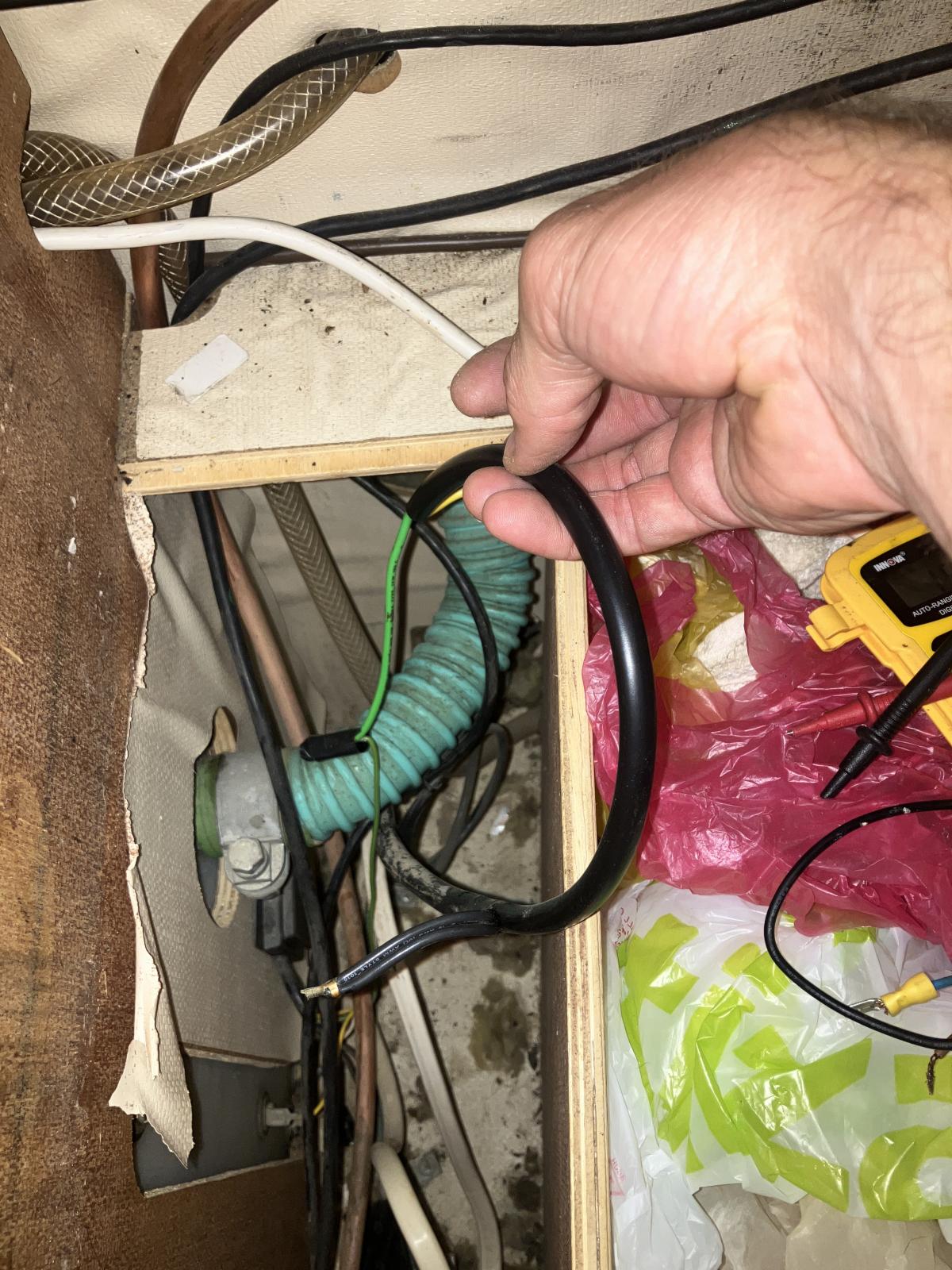

Hey guys I am perplexed with this in tank water pump in my 1982 vanagon.
I have the sureflow faucet and then the standard issue blueish in tank pump with the white power line.
So I have checked the voltage where the circuit meats the line to the water pump. Measuring at those connectors I get 12.8 V as shown and this is of course when the sureflow faucet is just left on to connect the circuit. I have taken the pump out and connected it to a battery and it fires right up no issue... When the pump is plugged into these wires that read 12.8 volts nothing happens. I have tried switching the connections and still nothing.
Every now and then the pump will work which is weird as well and this all started with it becoming intermittent. I just down understand where this disconnect is as I see 12.8 V and then the pump fires right up when connected to the battery.
Here is a pic showing the voltmeter at 12.8
Then there is also this green cord and then also the black one spliced off, what are these for? I think its something with the tank levels. I saw something in the forum about if the tank level thinks its empty the pump wont work.... correct me if I'm wrong but if the pump should be receiving these 12.8V shouldnt it just work. Im confused on this, not gonna lie

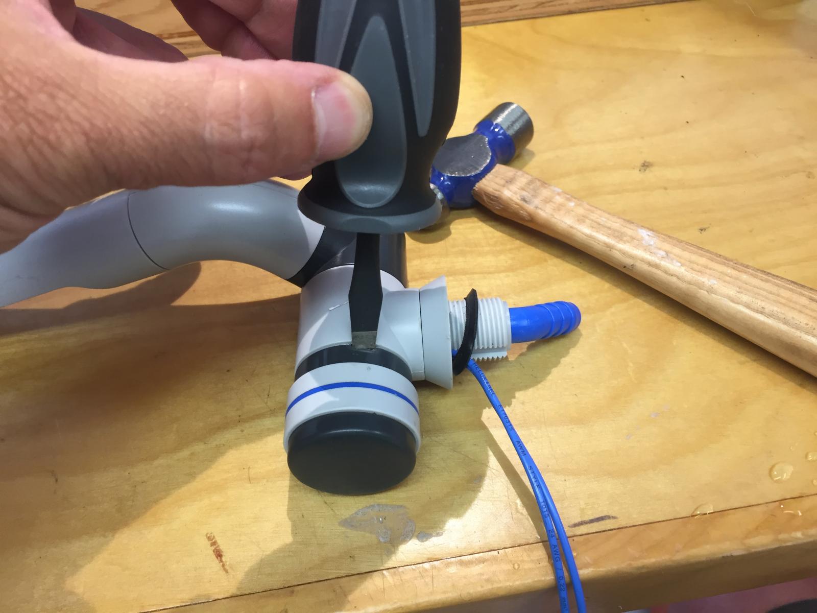

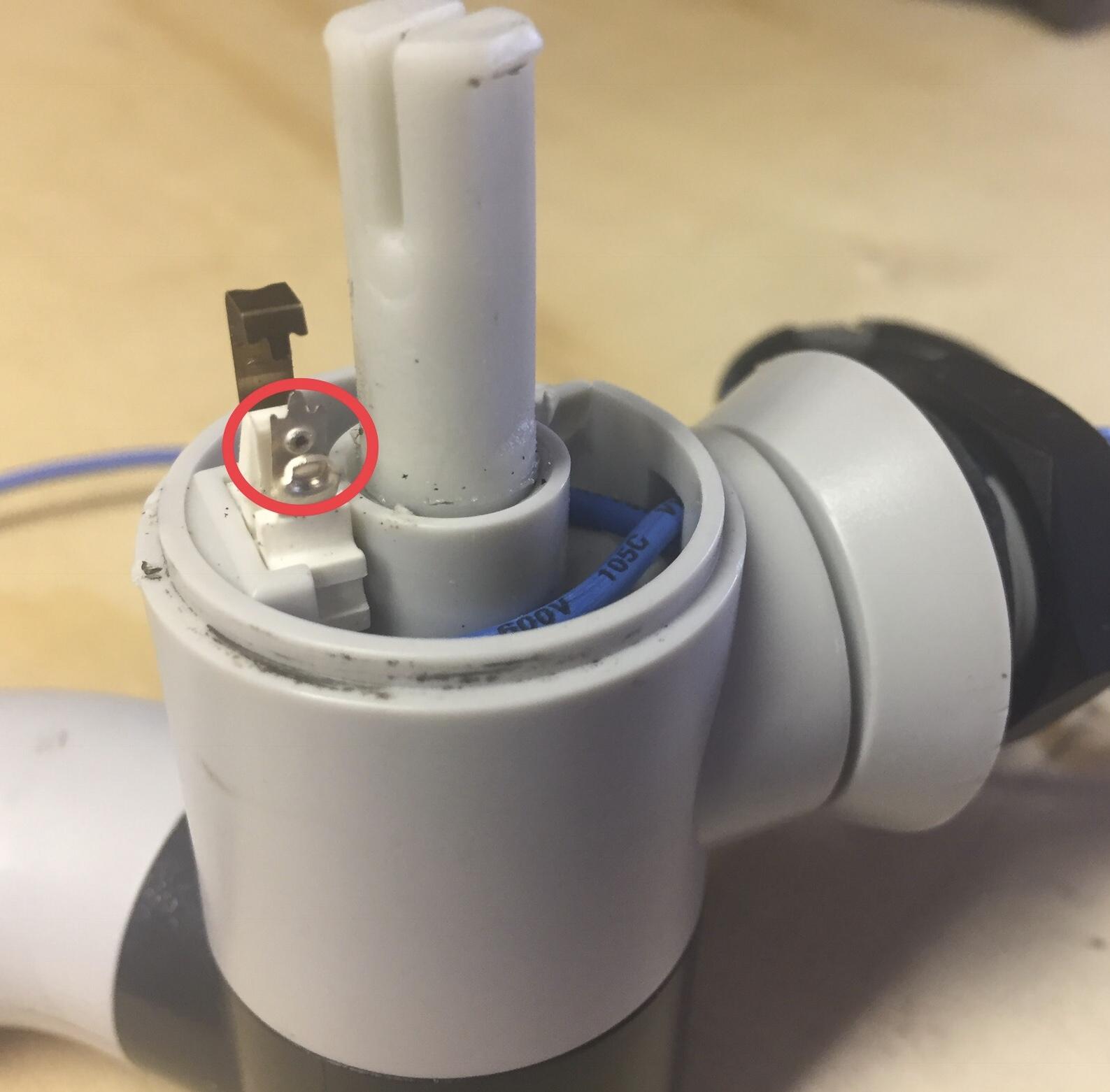

jimf909 wrote:
Just as I was about to bypass the Sureflo faucet switch with a separate foot switch I decided to attempt a repair. The tech at Sureflo said the faucet can’t be repaired and should be tossed if it doesn’t work. However, having dissected the previous Shurflo that failed last year I had some idea on how to take it apart:
Separate the knob from the faucet with a solid whack on a screwdriver positioned here. Remember, this is designed to NOT come apart. The first faucet I disassembled ended up looking much worse.
Clean the blackened contacts...
File down the knob retaining nubs to make future disassembly a hand-to-knob, no tools required affair...
Reassemble. Add an SAE plug to the faucet and van wiring harness to make future disassembly easy.
As to why two Sureflo faucets failed for me in less than a year:
- It’s not current draw while pumping water through the system, I read about 2.5 amps, similar to davevickery and w/in the switch’s 3 amp rating.
- My best guess is that a piece of the pump impeller broke and jammed the pump increasing current load (the impeller appears to be missing a part of itself). If it was a faulty Sureflo product I’m guessing we’d hear about more failures.
