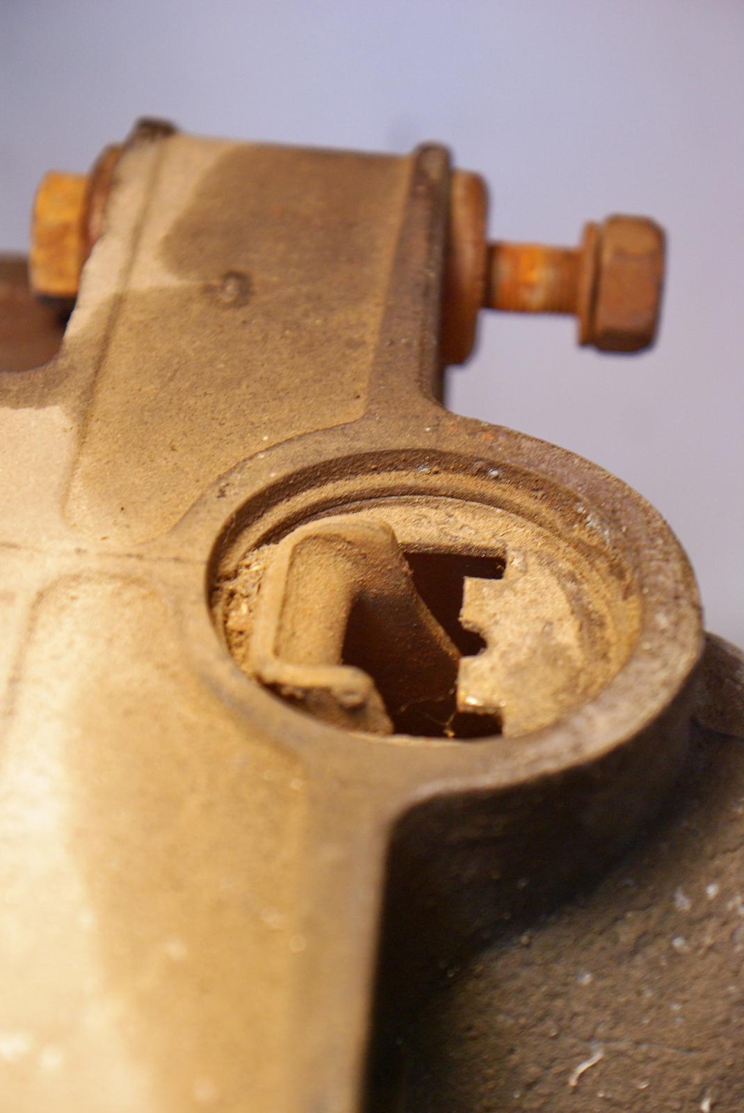

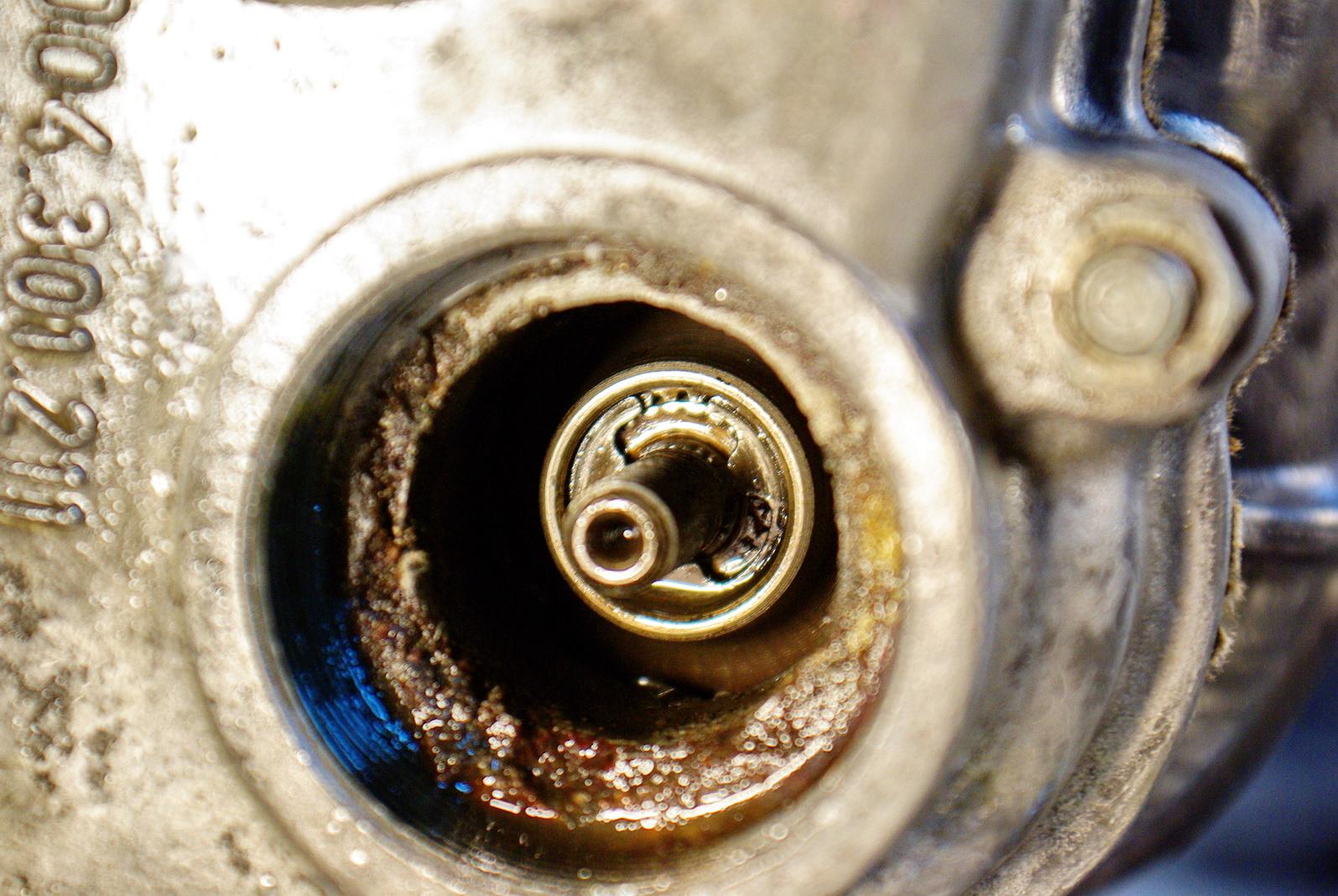

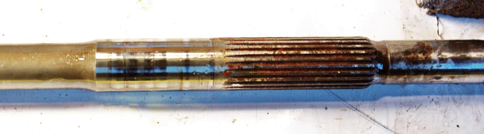

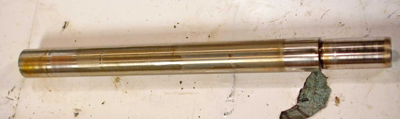

Finally checking in on this rebuild post. I have mine torn down to the differential. The countershaft and gear cluster are with a machinist. He mic'ed the counter shaft and said it was still in-round and with little variation along the shaft, and although it showed some discoloration, there was not wear that he thought worth replacing. But he/we are looking into the dimensions of the shaft as spec'ed in the Without Guesswork booklet, which he is borrowing now.
Using Torlon to replace the needle bearings, he is planning on lightly engraving a helical groove into the outer bearing surface to help it pump oil out. And then enlarging the oil hole and scooping it in the proper direction to aid intake.
Ray, would it be helpful to add another one or two intake holes?
+Rich K
raygreenwood
Joined: November 24, 2008
Posts: 23027
Location: Oklahoma City
raygreenwood is offline
PostPosted: Sat Oct 31, 2015 9:28 pm    Post subject: Reply with quote
That shaft is shot. The original shaft is case hardened. Its not a matter at this point of whether the internal 18mm shaft is still round and smooth with only discoloring...its that its not micron polished smooth like needle bearings require.
That discoloring is the case hardening ruined. You caught it in plenty of time.
The problem is that even with careful case hardening...the shaft was designed to be softer than the needle bearings so the needle bearing does not destroy itself. Both the needle bearing and the shaft were designed as wear parts for easy replacement.
The shaft will be JUST FINE...for using torlon. It does not need to have a hardened shaft surface.....just a relatively smooth one. i would polish it with 1500 grit....and clean it and reuse it.
No...I would not add any extra oil holes. The reason there is only one is that its in the only place you can put one without risking weakening the shaft.
With the torlon bushings...just widening that hole will be more than plenty. In fact....making the hole wider is not a real priority....but adding a shallow scoop to the side that faces the direction it turns will will help to cram oil in there.
You are really lucky. About another 5-7k miles...and the needle bearing would have been damaged. The maddening thing is that it will not even make any noise until its REALLY damaged...and even then is a very low howl or hum only in 4th gear...highest rpm and smallest gear on the shaft. When that hum starts...its because there has been wear to the 4th gear. It eventually shatters.
The Torlon bushings make this a permanent fix. Ray

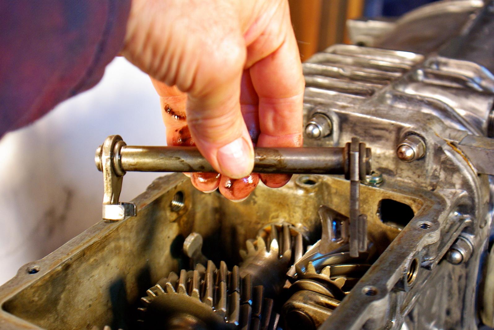

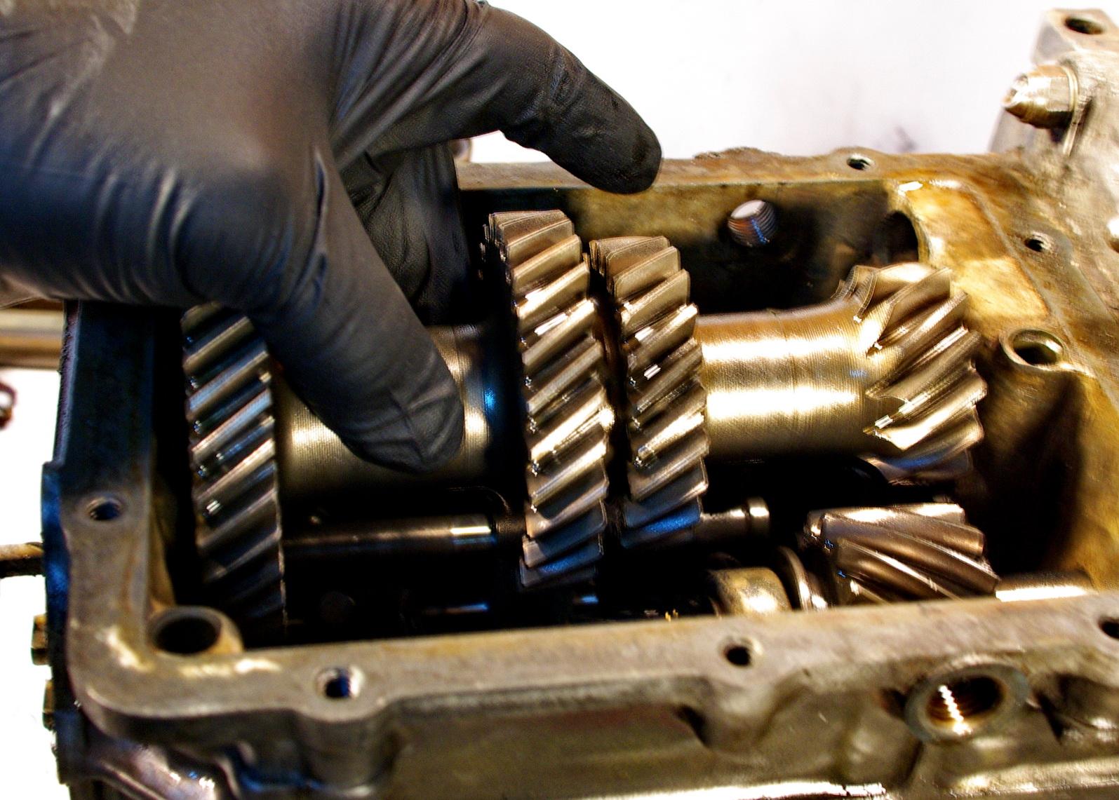

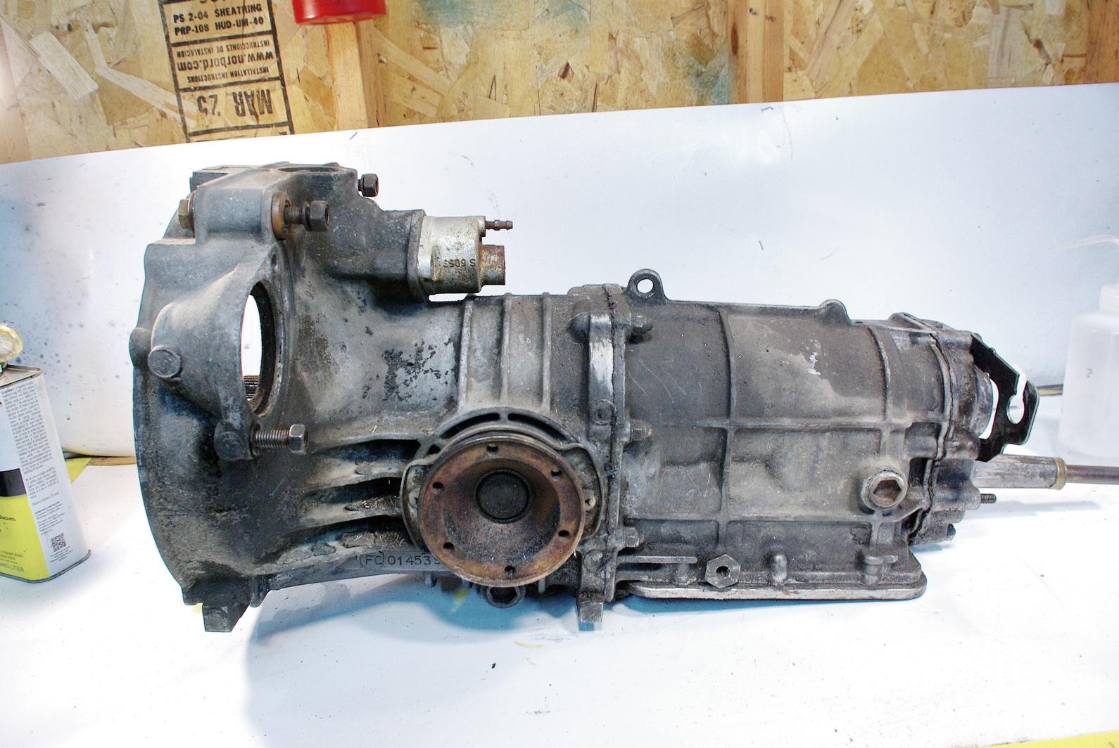

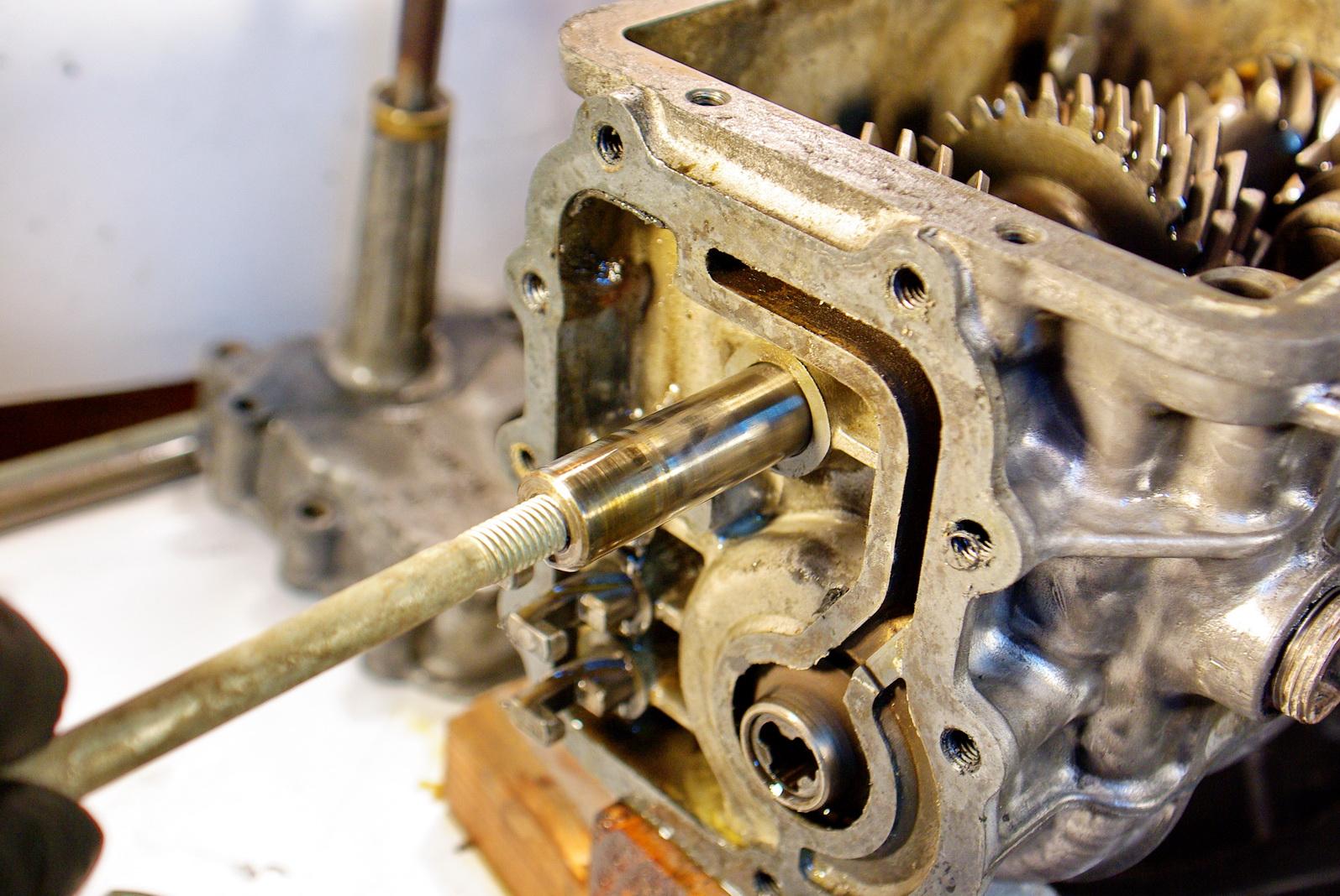

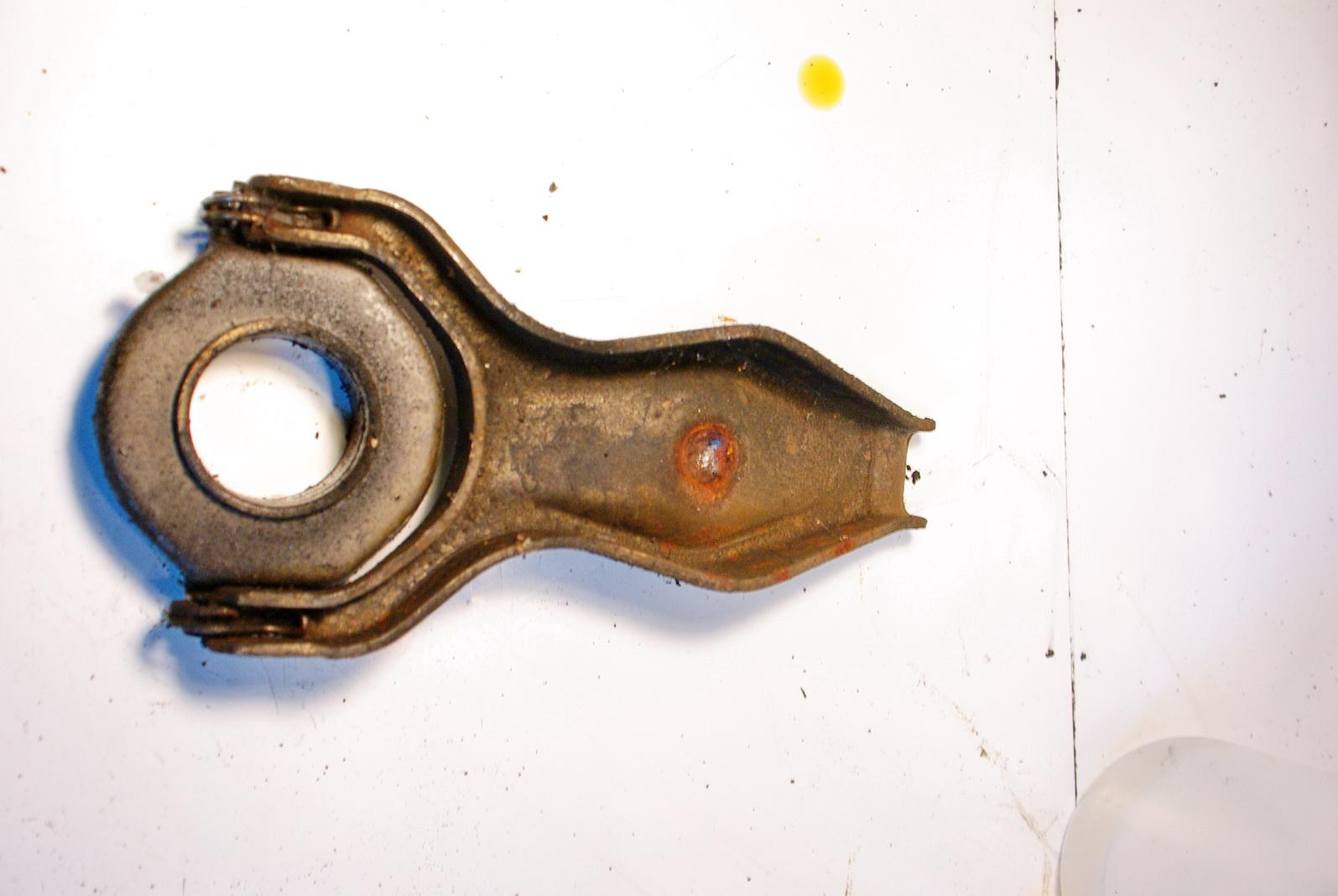

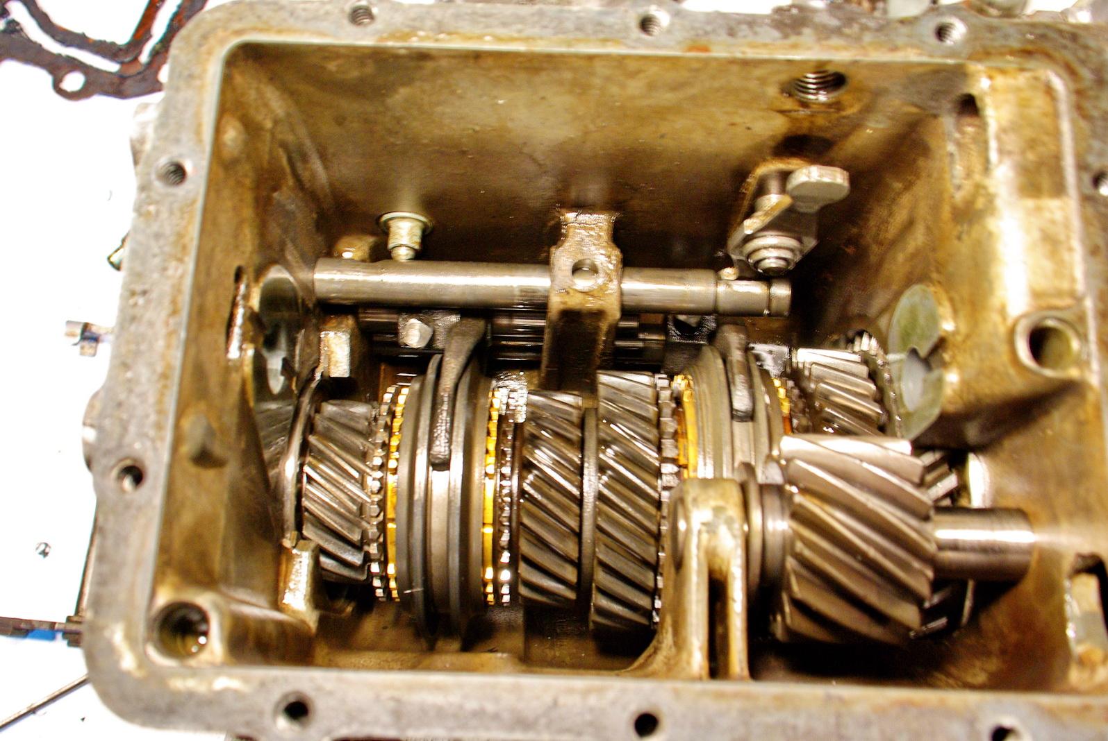

Update: finally really getting started. Today will just be a before and after starting picture set.
I pulled one of my three complete assembled 004 transmissions out last night to clean it up enough to open up and start refurbishment.
In my collection I have the transmission in the car (I have to check my logbooks to see what the status and condition of it was because its been so long).
I have another transmission complete that from the case sealant I can tell I have been inside of it but cannot remember what its status/condition is.
I have one totally disassembled in a box that has had some minor problems and mods. In the long run if its good enough it will be assembled as a spare.
The one I am working on in these pictures I acquired in September of 2011 from a gentleman and his wife who are total VW nuts in Maryland. It came complete with upper cross member, mounting bushings and starter attached.
All I have done is open the cover plate to inspect the counter shaft gear for spalling and wear. It was in excellent condition.
This one is an FC series transmission. The next major series were from May of 1972- FA series for sedans only and Fe series for wagons only
An interesting side note: There were three sets of final drive gears in the 004.
FC: uses 11:43....11 teeth on the pinion and 43 on the ring for a 3.909:1 ratio
Sedan and wagon
FA: uses 11:41....11 teeth on the pinion and 41 on the ring for a 3.727:1 ratio
Sedan only
FE: uses 10:39....10 teeth on the pinion and 39 on the ring for a 3.90:1 ratio
Wagon only.
I can only assume that having less teeth on the FE version allowed it to be stronger than the 3.91:1 in the FC version. I do know that the outside/end of helix teeth on the pinion gear were very thin and delicate. Any debris or foreign object entering the differential housing....or slip/mishap pressing on bearings can destroy the pinion gear easily by chipping that last tooth.

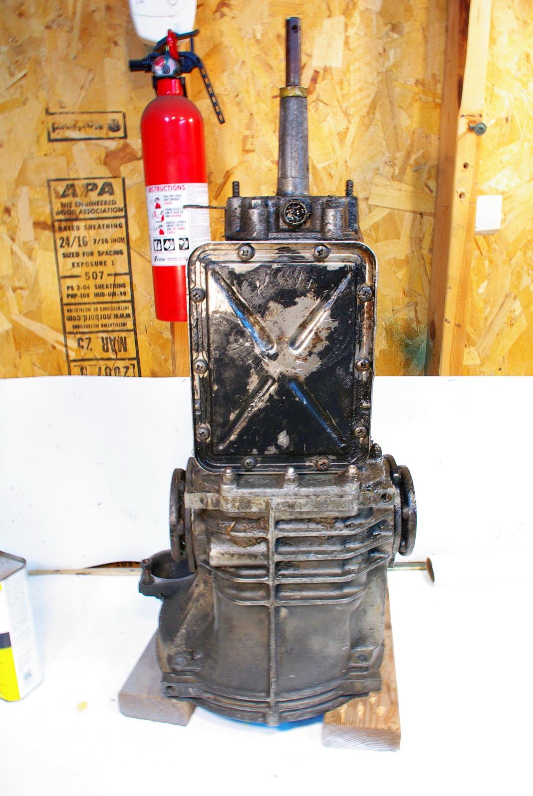

This will be a general walk around of the late model 004 transmission just for starters....to familiarize any of those who have not really been acquainted with them .
This is an FC series which was used starting from August of 1970 in both Sedan and wagon models. It has (according to the "Without Guesswork" book.....an 11:43 final drive gear ratio (3.91:1). We will see if that holds true when I get inside.
Apologies: sorry these pictures are a little rough. I changed my lighting and work location in the garage and am still working it out. The blue tinge is from the light contamination of the fluorescent lights interfering with my 6500 kelvin daylight spots. The camera cannot deal with two different light sources.
WARNING: I have been inside and refurbed numerous of these transmissions to various degrees. PLEASE DO NOT....follow along working on your own step by step.
A. This may take a while
B. There are numerous parts you MUST NOT loosen or remove....except in the proper sequence. I will get to what NOT to do in an upcoming installment. The issue is that the special tools and shop manuals for simple resetting of various tolerances in the final drive and one or two in the main gear transfer section......DO NOT EXIST. These are not hard to get around....but you must measure certain tolerances upon disassembly....in order so that you can know baseline relationships. I will explain all of that moving forward.

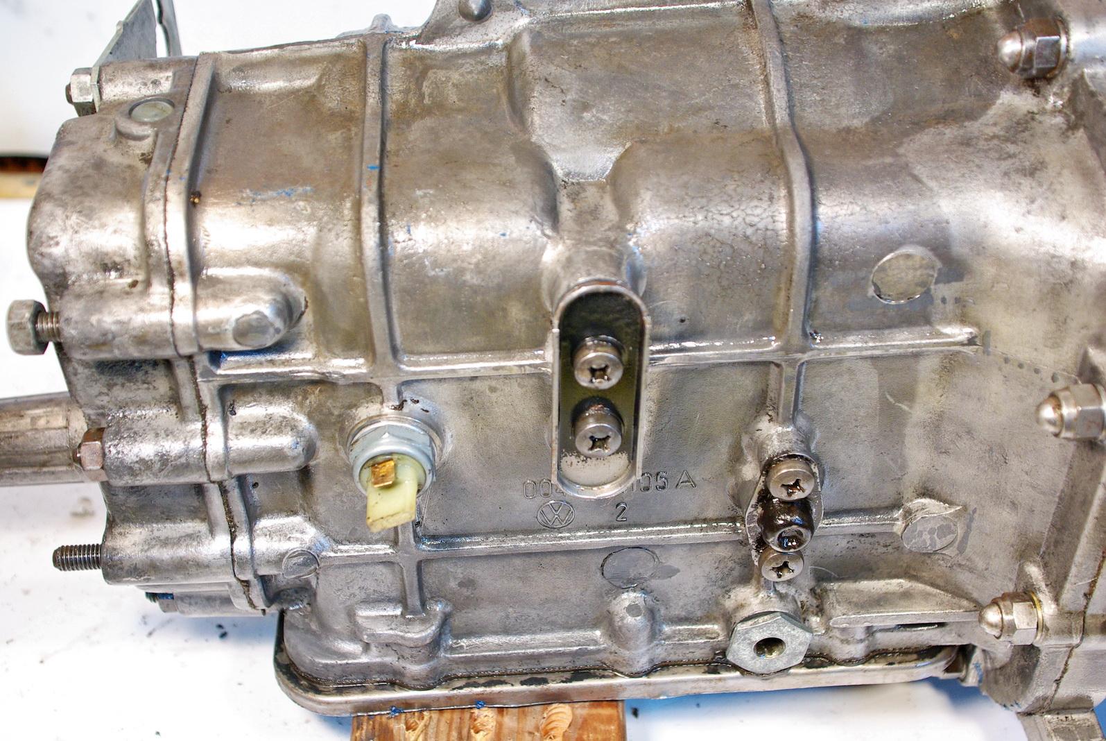

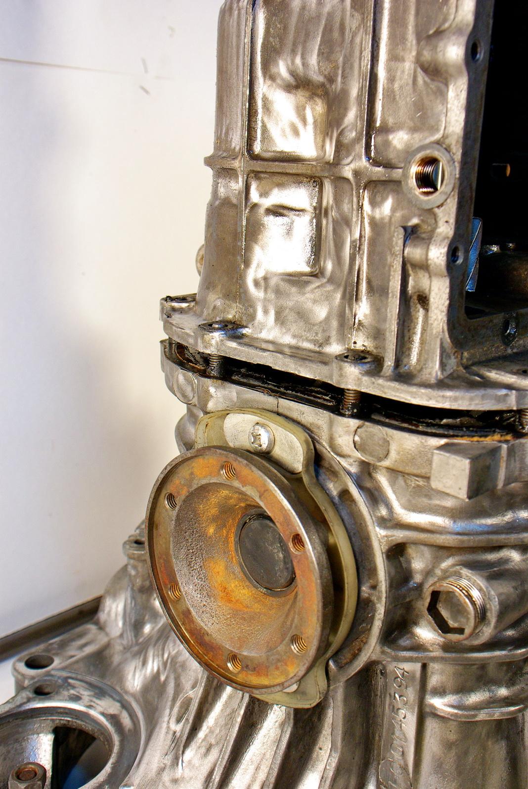

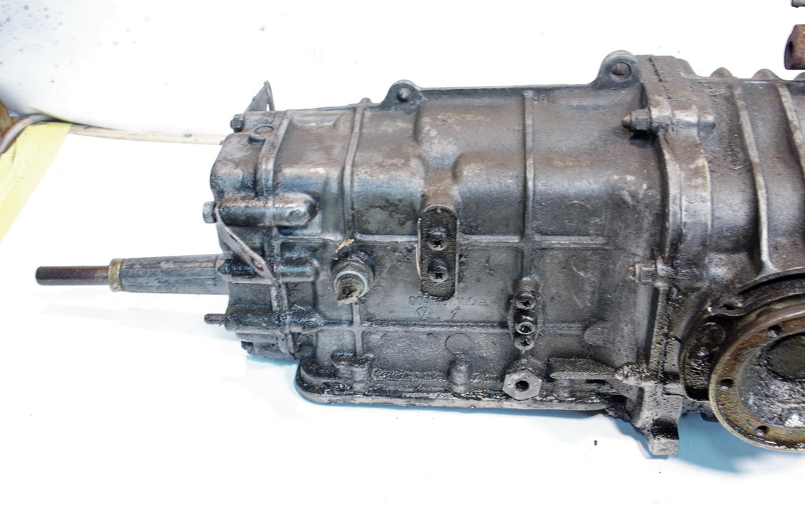

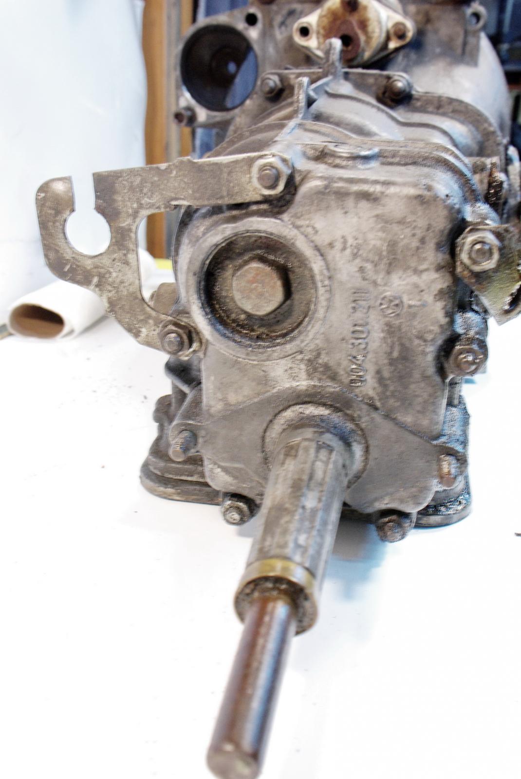

A general view of the whole monster.
Drivers side bell housing. Make note of the 44mm clutch slave, the brownish urethane bushing rings at the top corner of the bell housing attached to each end of the slip in tube bushings.
You will also notice the plastic flange locking plate behind the stub axle and if you look close it has booth screws and curved stiffening plates still attached. These are all must have parts.

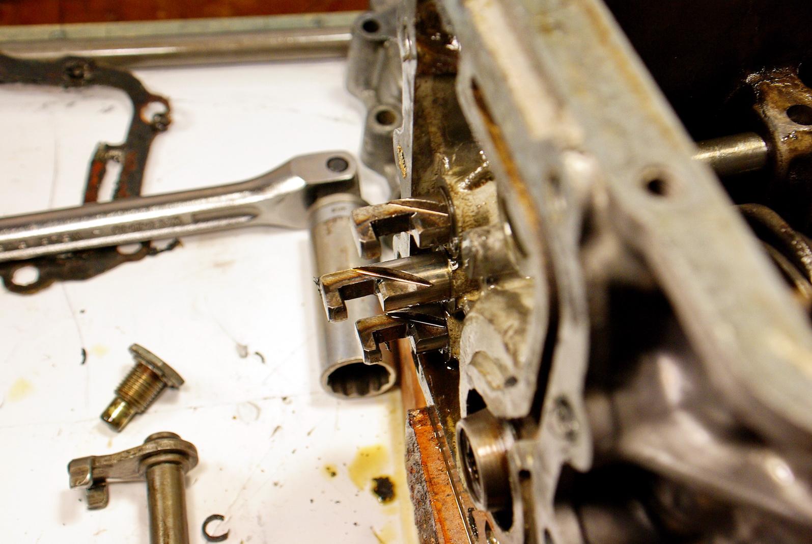

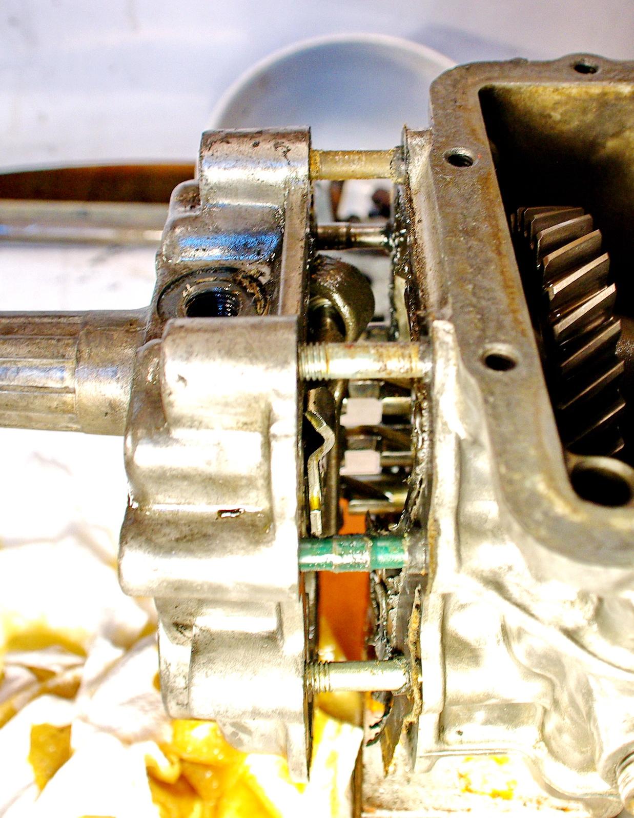

The aft section of the left side has five notable points of interest. From left to right:
1. You can barley make it out, upper left attached to the stud at 11:00 is a steel strap with a hole in it (a plate actually) bent to the right. This part...if memory serves ( I will verify) holds the harness for the reverse light switch.
2. the round plug is the two wire reverse light switch. Work hard not to destroy this. It is unique to the car/transmission. I will be working to replicate them or re-purpose another type.

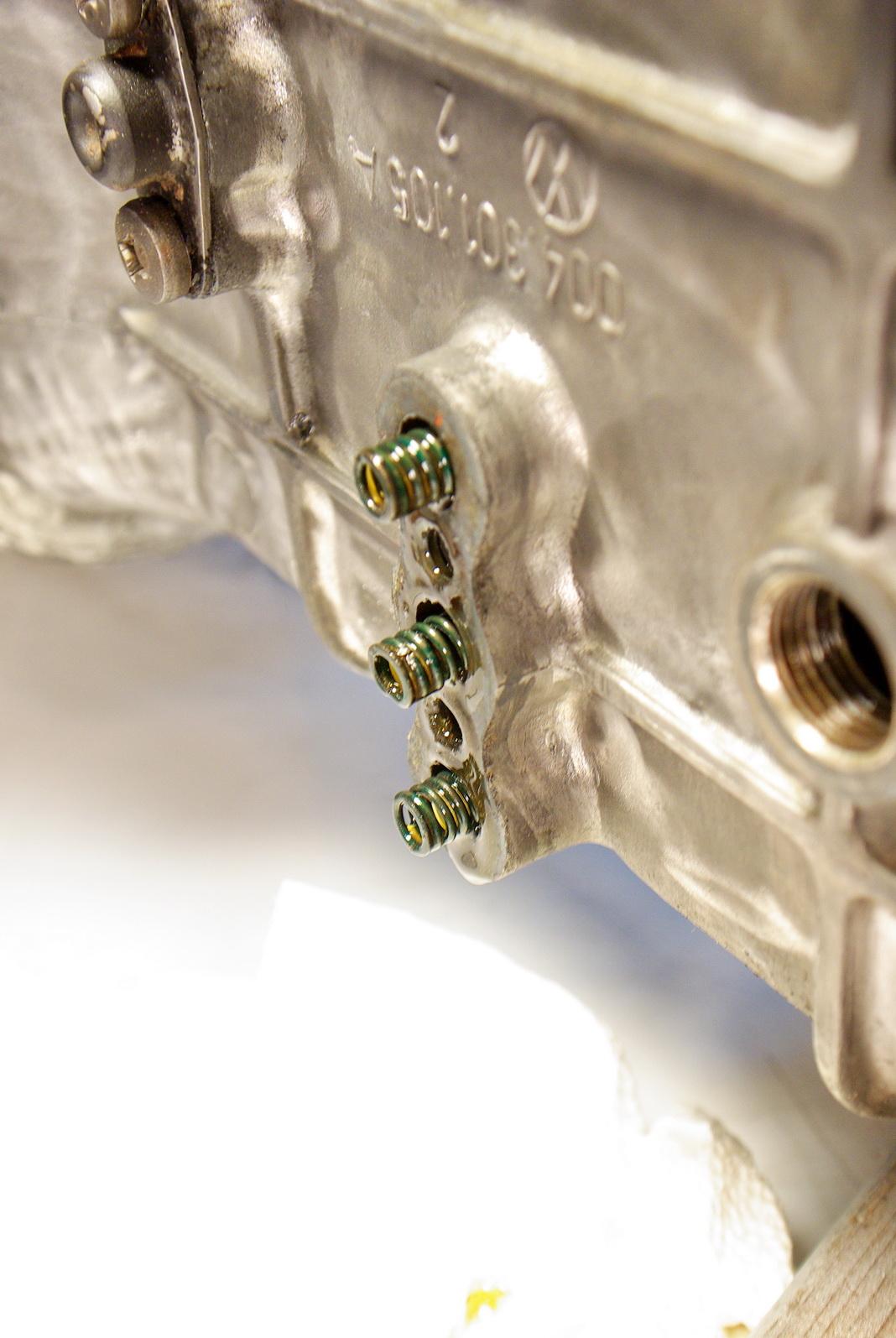

3. The long oval plate with the two phillips screws covers three horizontal bores and seals with a gasket. Underneath are three bullet shaped plungers and three springs. These are the detents for the shift rods.
4. The smaller/lower plate with two screws and a dome is the reverse idler gear adjustment eccentric plunger.

This is the tail cone end. Items of interest:
1. Upper left "u" shaped bracket. Dont bend this one up or lose it. It is the hold down bracket for the clutch slave fluid supply line. From the factory...there was a hard line all the way to this bracket. It used the same flange and spring clip the front and rear soft brake lines use to clip to the struts and rear trailing arms.
It was kind of a backward design. A 3 foot long high pressure brake hose bolts into the female connector of the hard line at this bracket. Since the only purpose of the hose was to give some flexible movement to the hose....and the hardline was there because there is supposed to be virtually no transmission movement...it worked....but becomes a major pain when shifting the transmission around when doing work with engine out and transmission in.
I replaced my rear metal fluid line from the mid joint aft...with a shorter line. I used a vanagon short fluid hose from the forward side of this bracket to the steel line and use a 3 foot rigid line to the slave from the bracket aft. More on this later.
2. The large round cap. This cap covers the special locknut and clip that covers the splined mainshaft where it connects to the pressed on hub that transfers power from clutch disc to the mainshaft.
This is really cool design. It means that if you WANT to remove the engine while leaving the transmission in the car.....look under the back seat...remove the cover plate. then remove the plug pictured. Remove the "C" clip and 15mm nut....and the whole drive shaft pulls out under the back seat disengaging from the clutch.
3. The stud on either side of the tail cone shaft is where the tail cone bushing bolts on.
4. The nut at 3:00 o'clock position is where the ground strap bolts on.
5. Right behind the bracket, next to the nut at the 12 0'clock position is the pressure/condensation/overflow vent...just a small hole.
Right/Passenger side overall view. The points of interest from left to right are:
1. Starter location on bell housing
2. The series and serial number at the 7:00 position under the stub axle
3. The drain plug at 6:00 position under the stub axle
4. The reverse cross shaft bearing/shoulder bolt to the right of the stub axle and lower edge of picture.
5. The oil filler plug center near the tail.

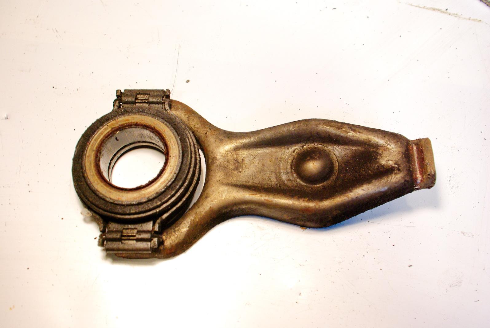

Front and back side view of the clutch TO fork.
General bottom side view of the trans case.
Detail of interest on the bottom side of the tailcone....the neutral safety switch. I have never found one of these hooked up or working. I generally install a flanged plug as its a common leak point.
Important detail....there is one long screw that holds the cover plate on. It has green machinist dye coloring it. It is totally different than all the other screws and is the shaft locking screw for the reverse idler gear shaft. DO NOT lose it.

On the bench after the vent hole was plugged!

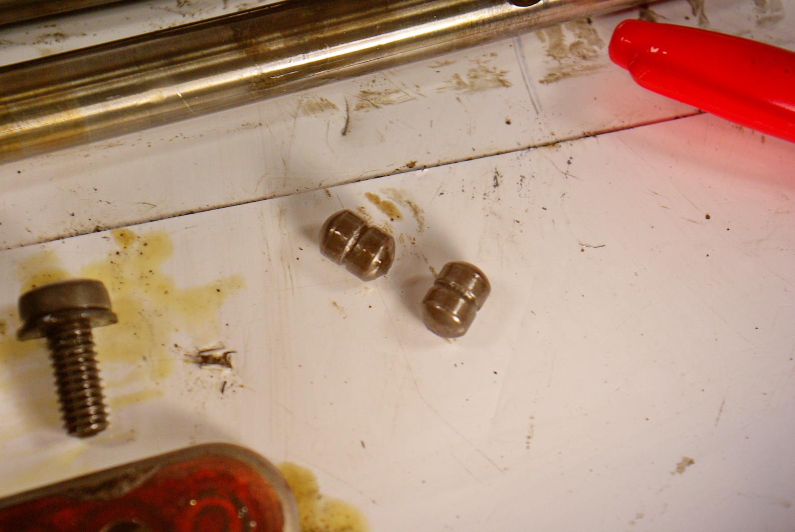

Removing cover plate screws. This one happens to be the "green" screw.
Just to show the difference between the green screw that locks the reverse idler gear shaft as compared to the others screws.

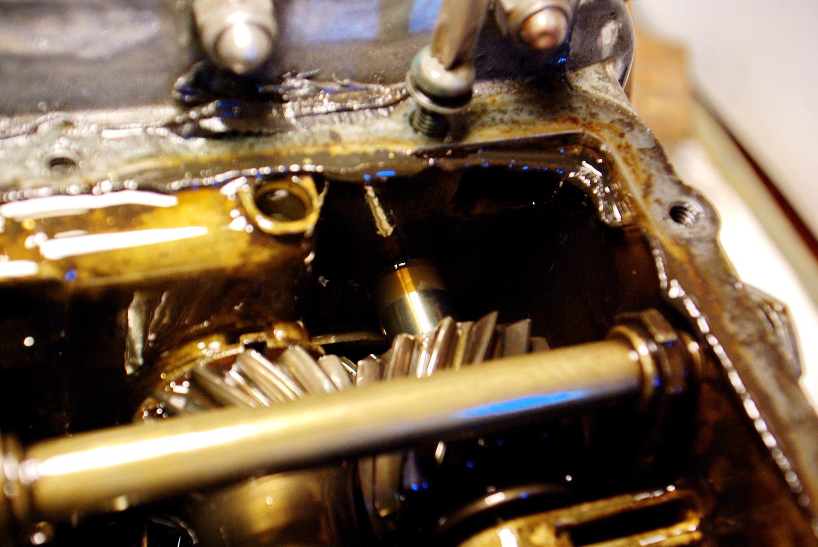

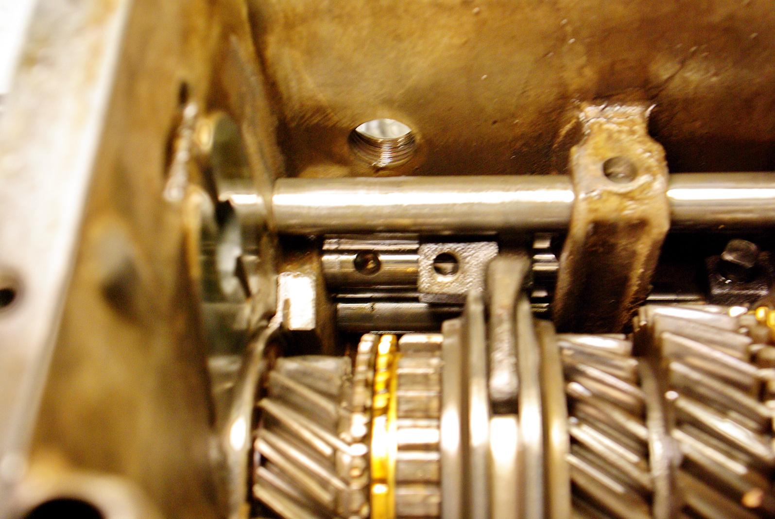

A view of the inside. The counter shaft is the main group of gears running left to right...all one piece. The bar or rod running top to bottom on the left is the reverse idler gear actuator pivot shaft.

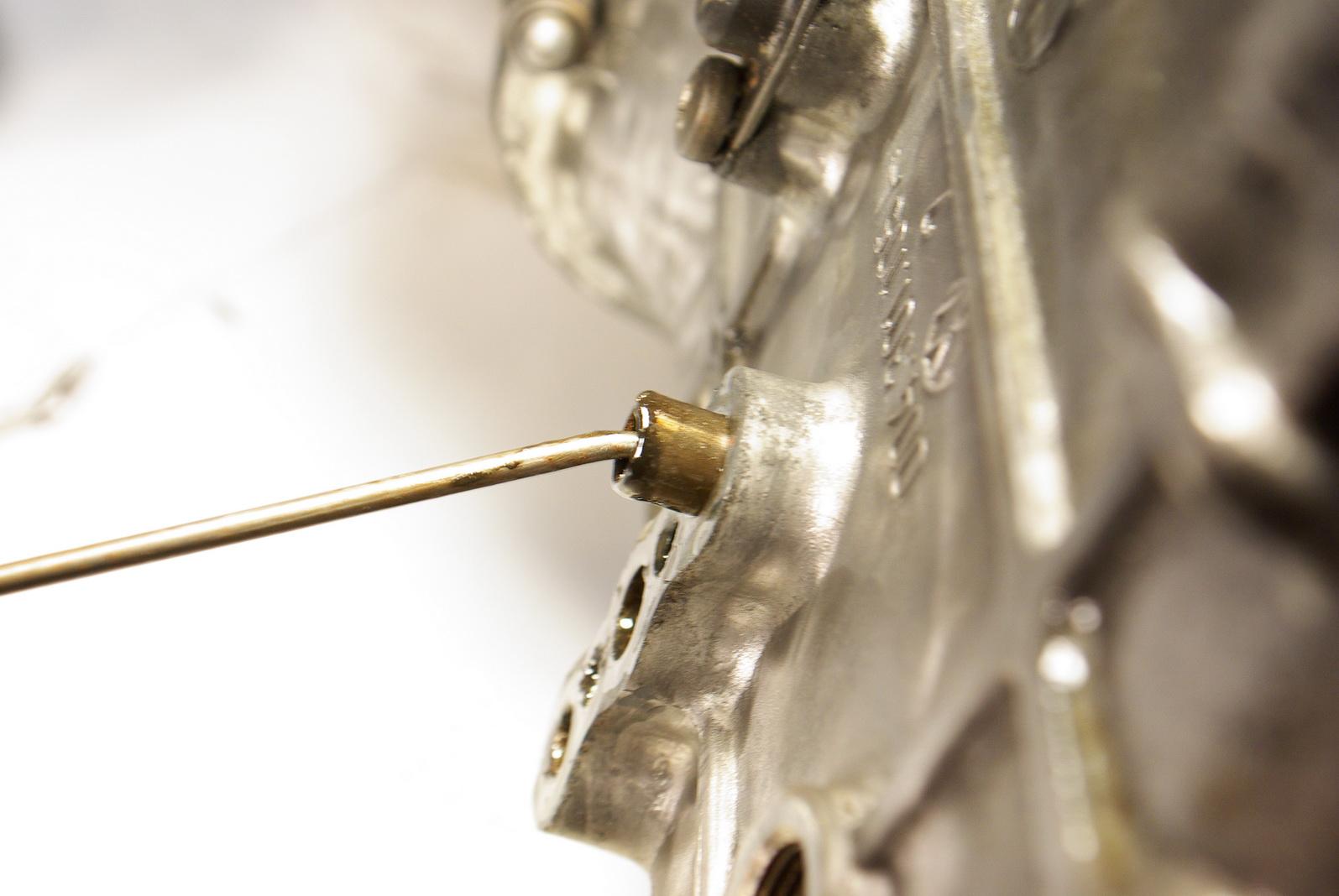

This poor picture is just to show the reverse light switch and its "off" detent location on the shaft...lower left of the picture.

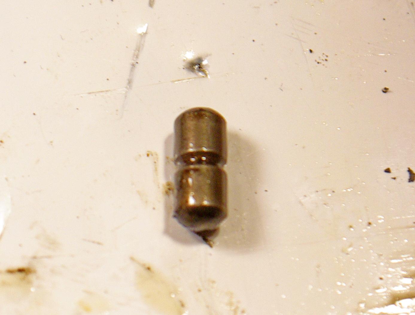

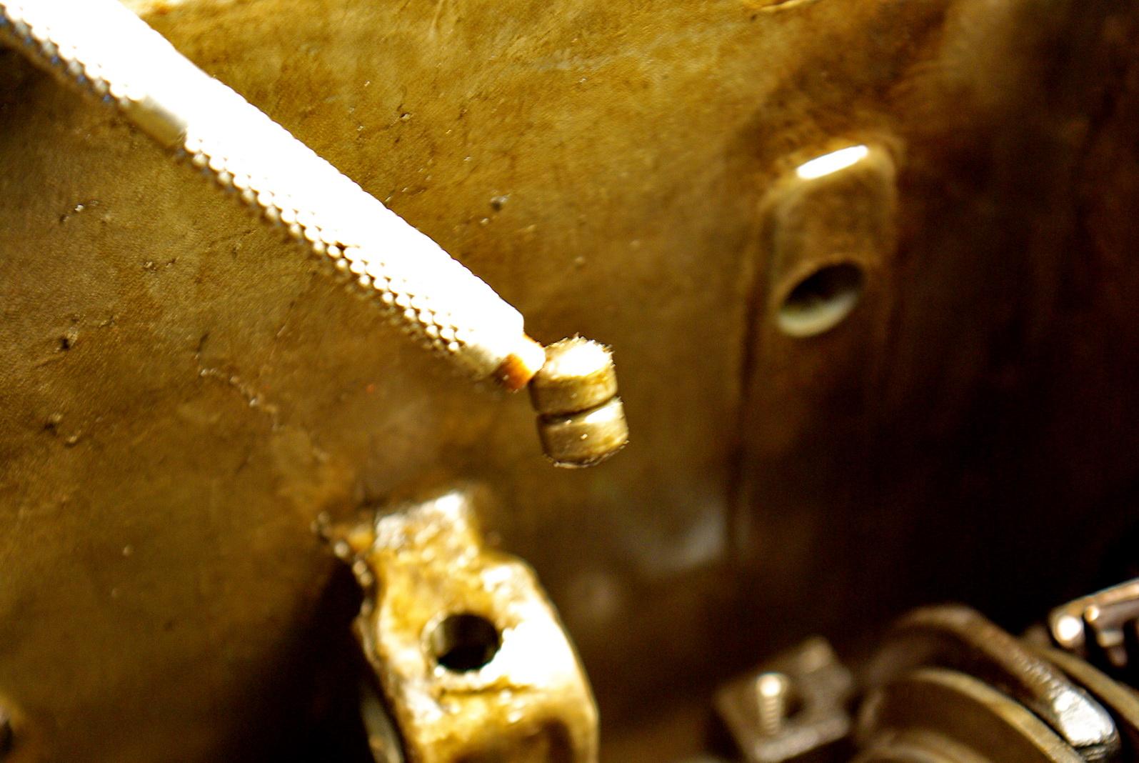

An important note .....look just to the right of the shift rod that activates the reverse light switch...and you will barely see a small square head, dog point bolt. You will need to spend $6-8 to buy a 1/4" drive, 12 point socket.
I will post the part # tomorrow. Its easy to get and buy in many places. It needs to be able reach down in a very tight area to remove this screw. the screw holds the 1/2 shift fork onto the shaft. If you do not remove this bolt you cannot remove the shift rods and therefore cannot remove the housing.
It cannot be done via a wrench.
This pictures shows the reverse idler shaft below and inline to the green bolt so you can wee what its holding. Once the plate is off...I replace the green bolt to hold the shaft.

Remove the round screw in plug from the tail cone. This is a 7/8" socket. It is 22mm.

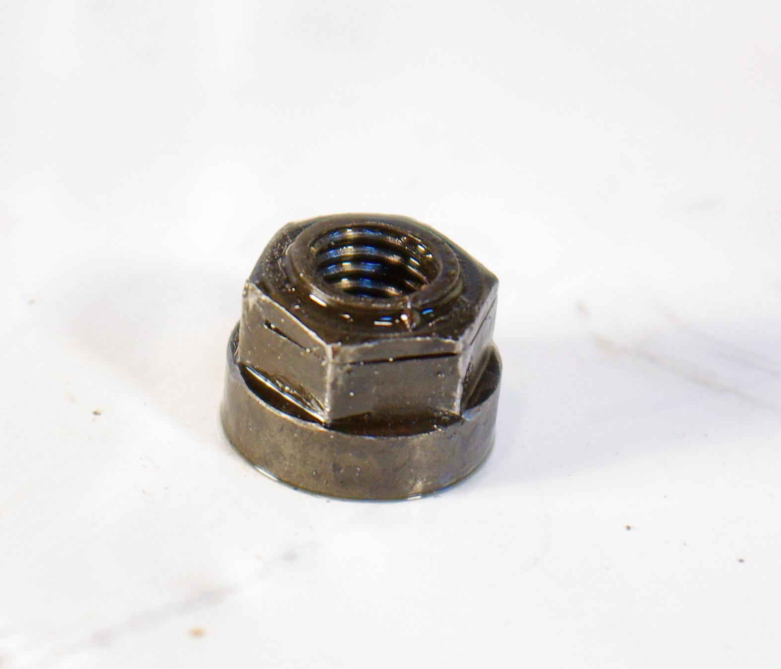

What you are looking at is the special locking nut and E-clip that locked the splined drive shaft to the mainshaft ball bearing hub.
The simplest way to lock the drive shaft is with an old clutch and pair of Vise-grip pliers (mole-wrench to you UK types Wink )
15mm socket and very little effort takes this loose
DO NOT LOSE THIS NUT! As you can see its a split lock nut. It deforms under torque to lock securely.
With the lock nut out of the way you can see the special Round E-clip...and this IS a special E-clip. DO NOT LOSE IT!.
In a pinch on the road...if you have to remove just the engine...you can take this nut, the E-clip and the drive shaft out...through the port under the back seat.

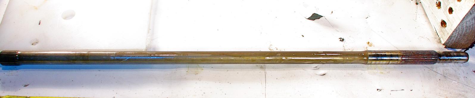

Remove the clutch disc and pull the drive shaft all the way out through the bell housing.
Here is the shaft.
The mainshaft hub end. It looks excellent.
The clutch end is not so good. The seal area to the left can be polished and has no rust in critical areas. I can remove the rust from the splines. As long as it still fits tight in the clutch splines with no appreciable axial play...it will be fine.
The pilot bearing area I can polish but it will likely never be usable with a needle bearing again. That is not a huge worry. If I have to use this shaft I will put a solid bronze or torlon bushing in the flywheel.
On that last note....the driveshafts from any 004 trans can be swapped in about a minute. There are no special tolerances or adjustments.
Also, this shaft may look spindly for power transmission...but I can assure you they are very hard and very strong. I cut one years ago with a hacksaw. It was extremely hard and dense. It was very similar to cutting an induction hardened shock absorber shaft.
Remove the nuts from the tail shift housing.
Remove the neutral safety switch if you have one.
Then you can separate the tail shift housing. You will need to pull the middle shift rod rod outward slightly and jiggle the shift hockey stick to disengage the tail assembly. This will be frustrating. DO NOT PRY. Take your time.
IMPORTANT NOTE:
The very best way to remove...and especially re-install....the tail shift housing is to remove the studs. This is what the jamb nuts in the tool list are for.
The method outlined in the Haynes manual for re-installing the tail shift housing is horrible. That method WILL insure that at least one time ...if not twice...you re-install the tail shift housing with its gasket and sealant... if you choose to use any....goes on perfectly...but then you are incapable of selecting ANY gears.
You will then have to remove the tail housing and start over. The Haynes method requires that you position the shift rods in and out just perfectly...to allow mating the sliders up...just perfectly.
Its a very risky method. It takes so much time and screwing around...it almost always results in a leaking gasket even if you get the shifter rods aligned perfectly.
The easier method is to remove the studs...put them in and order location. There are three types of stud. Just to be anal about it I measure the amount each stud protrudes outside of the tail shift assembly.
Putting the wrong stud in the wrong location or screwing it back into the case too far with not enough threads sticking out to hold brackets, lock washers and nut...is also a frustrating do-over situation.
I did not have jamb nuts on hand so I removed the tail housing the hard way. I first measured their outer protrusion and then removed, the tail housing and then removed the studs and stored them in order
The inside of the tail shifter housing. Looks similar to most other types
This confirms that at one time the tailcone at least...was removed and resealed...with too much "goop".
The sealant peeled away easily.

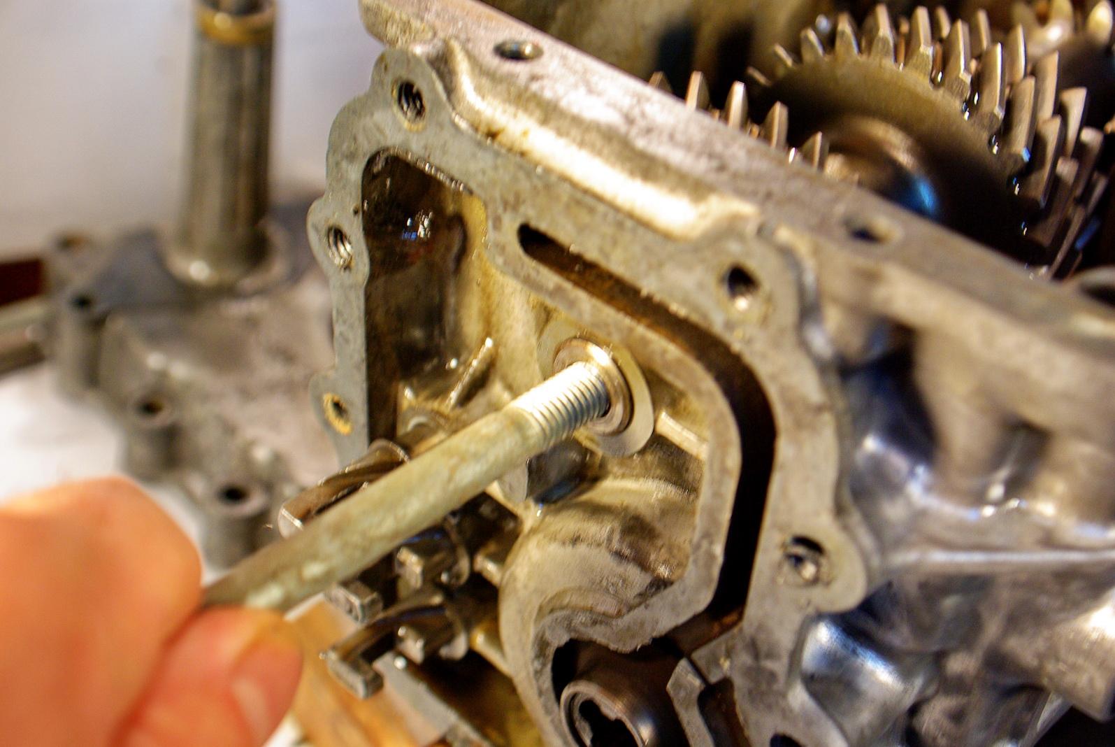

next step is removing the reverse gear actuator cross shaft bearing bolts which are the large 24mm hex bolts in this picture
You can use the appropriate sized socket ...24mm...or use an 8mm Allen key in the inside.
The bearing bolt and sealing ring.
IMPORTANT NOTE: There is a flat sealing ring on each one of these bearing bolts. DO not destroy or lose it. It is reusable. You will also find that there is virtually "0" torque on these parts. The torque does NOT lock these bolts in position. The bolts simply seal against the washer and are locked in place by a special "detent" in the gasket and metal cover plate.
You simply tighten them so that the washer makes sealing contact and the point of the hex is at 12:00 position. The cover plate does the mechanical locking.
Jiggle the shaft and remove it complete.
On the workbench.
Notice that the reverse gear selector pivot on the right and end comes out...DO NOT LOSE IT! It frequently falls down in the case while you are removing the cross shaft. This is one of the places the magnetic pickup comes in handy.
This transfer pivot arm is what the cross shaft was attached to on one end. This pivot is on an adjustable eccentric shaft. DO NOT REMOVE IT RIGHT NOW.
Take your camera and photograph which way the bends/angles go on this part. It will fit either way but will only work one way. Ask me how I know!

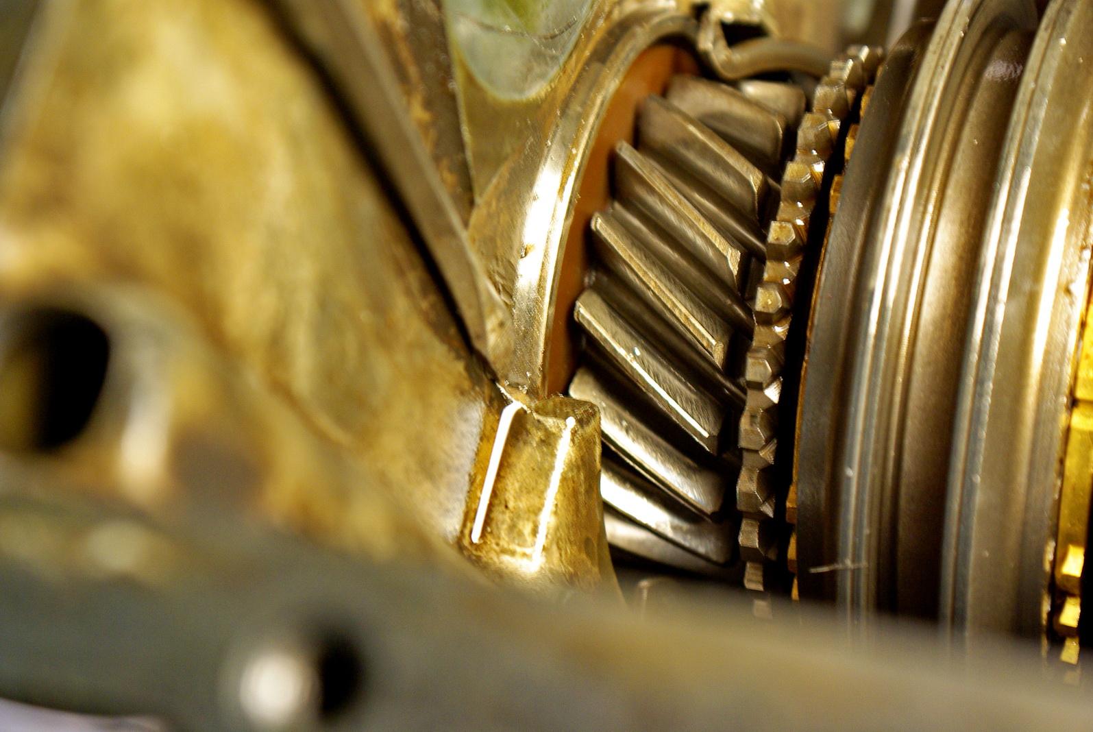

The slot on the gear in the foreground (the reverse idler gear) is where the pivoting spade fits in. When you move the reverse shift rod, the transfer pivot moves the reverse slider gear and engages and connects the reverse gear on the counter shaft.
A blurry view of the back-up light switch and the shift rail locking screw. You can remove the back-up light switch now Leave the shift rail screw alone for the moment.
Important Note!: before removing the counter shaft, take your feeler gauges and check the play between the countershaft end faces and the bronze thrust shim. You only need to check one end. Push the counter gear to one end and insert your feeler gauge. The smaller end is the easiest to check this on.
The listed tolerance is .002" to .014". A tight feeler gauge drag is what you are looking for....just short of a no-go. This one is at .011"
Insert the 10mm bolt in the threaded hole iin thee counter shaft end
Screw it in about five turns.
Pull outward. It should take very little force. It typically takes less than it should. We will be doing a modification to insure that this shaft never rotates. If it begins to rotate it will eventually destroy the case.
From this picture you can see the dull colored area where the needle bearing has been. While this is still serviceable...with the needle bearing that is on it now, it has enough wear marking to insure that no new needle bearing can ever be put on this shaft. The needles themselves (we will show later) already have lines on them. The needle bearings can also never be reversed on this shaft or they will destroy themselves in short order.
While it is currently serviceable....it is very, very, very poor economy to NOT fix this problem and replace the needles NOW. This issue will be the destroyer of almost all type 004 transmissions. It has been the issue of all of the ones that have ever broken. When that happens it is NOT repairable.
We will be either replacing the shaft...or installing Torlon bushings that do not require perfect shaft tolerances and polish.
The shaft removed. the locating step diameter is 15mm.
Lift the countershaft out. DO NOT let the bearings fall out of either end. Do not mix up the bearings or turn them around.
End view showing needle bearings. You can see that there are no oil relief grooves in these gear faces to allow oil to flow through the bearings and out of the gear. We will be adding them.
The bronze thrust washers showing some of the wear that has left us with .011" end thrust.
The back of each thrust washer has VW part #'s and thickness in millimeters. I think there were at least 10 different sizes available. We will measure each one to find out what it lost to restore the tolerances.
The gear case with the countershaft, thrust washers and reverse crosshaft removed.

The rings the pick is pointing to on the gear sliders are important. they tell which way the slider MUST go. We will examine this in detail later but is just another reason why you cannot simply disassemble these transmission indiscriminately.
Note the special snap ring the pick is pointing to. This will have to be removed before removing the mainshaft ball bearing and hub. The case can be removed with the snap ring in place but its easier to remove the snap ring with case in place and being held down by the weight of the transmission.
Shift rail removal:
Sorry for the blurry picture. You need a 1/4" drive, 12 point socket of either 5/16" or 8mm size.
NOTE: REMOVE THE RAILS/RODS STARTING WITH THE REVERSE ROD AND WORKING YOUR WAY DOWN. This is important so you can remove the detent balls between each rod as you go. You can start with any rod but it makes it more difficult because the detent balls fall out of place and lock the other rods in place.
Start by removing the two Phillips screws on the larger/onger sheet metal cover.
Remove the cover and gasket to expose three springs.
Remove the springs.
Pull out the three detent plungers with a pick
CAUTION: Notice the mark I made on this cap to index it to the case. DO THIS...with a dremel or a file BEFORE YOU LOOSEN OR REMOVE THE SCREWS.
Once the screws are removed. DO NOT REMOVE THIS CAP!!!!!!
With the cap screws loosened and turned almost all the way out....push the shaft outward from the inside with a pick or screwdriver.
You want it to protrude like this so that you can remove the shaft with the outer cap STILL ON.
Wipe it with clean solvent, dry it and make a mark with a sharpy next to the index mark.
This is why you need to mark the shaft. The cap is splined to hold the shaft in position. The shaft itself is an eccentric shaft. This sets the reverse idler gear adjustment. Its not hard to adjust but can only be properly done to be noise free....when the trans is in the car. You will have to set it by factory specs, then usually drain the transmission, pull the pan and readjust to make sure "real" clearance is correct.
Its usually simpler to "assume" the adjustment is already correct...and it usually is. So...preserving that adjustment is a time saver.
Remove the transfer lever now.
You can now pull out the reverse shift rod...the top one in this picture with the snap ring on it.
Now remove the 8mm, square drive, dog point screw holding the fork onto the shift rod in the middle.
Remove the large fork from the middle rod.
Put your 1/4" diameter magnetic pickup down this hole and pull out the detent ball. You can now remove the shift rod.
You can go ahead and remove the screw from the other fork. Just dont remove the rod yet.
Put the magnetic pickup down the hole again and remove the second detent ball.
as you start removing the last shift rod and pulling it out of its fork...you will notice that it uncovers a 4-5mm detent and hole in the rod. If you are quick you can catch that detent plunger with your magnet. If not, just be sure to fish it out of the case.
Last shift rod out of the case...note the detent plunger on the end of the magnet.
Remove the fork now.
All three shift rods out with all detent balls and plungers.
Just so you understand what plungers, detent balls and springs exist inside of the shift rod system so you are sure to get them all. This is the cross section of the detent system with the outside of the case on the left.
If you have not already done so...it is time to remove the snap ring. Notice the small gray flat blade screwdriver pointing to the upper snap ring ledge on the extreme left of the picture. Start here to remove the snap ring it is easier on the higher side.
I use a small screwdriver and an O-ring pick. Let it drop into the case and fish it out later.

The complete mainshaft gear stack and differential.
Interesting. This is the first gear set in a 004 that I have ever found with gear markings. this notes that it is a Gleason gear set, 11/43 which means its final drive ratio is 3.909:1 (3.91:1).
I also found these markings. They "may" be from the factory but I have never seen any like that. Its most probable that this gearbox was opened by a competent transmission shop for new bearings and that these are the differential position marks.
I will inquire with people who know more than I do.
More to come. Ray
