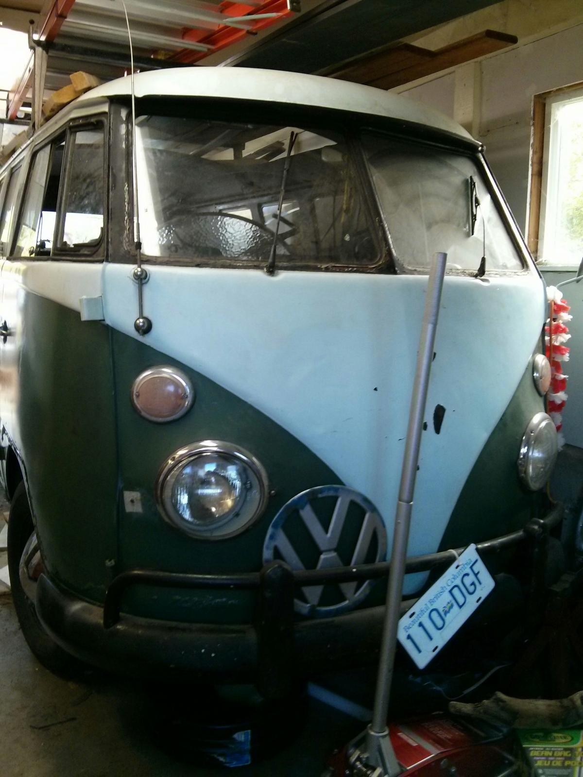

Picked up this light grey kombi in July. It was stored for 12 years in a garage. It has 3 popouts each side, which I think is a. It unusual for a kombi. Just trying to get it back on the road for now. I spotted it 2 years ago l but the owner wasn't ready to sell. But persistence paid off.

very nice bus with unusual L345 for 1964. Mcode 114 confirms that the 6 pop outs are factory. Looks like it would have had grey hardboard panels in the back and rear seats.
Has a giant hole been cut in the roof or are my eyes playing tricks on me?

Your eyes are just fine Crying or Very sad . but it was 2 grand and almost running. The motor was rebuilt just a year or two before it went into storage. Needs the usual rust repair for a northwest bus.

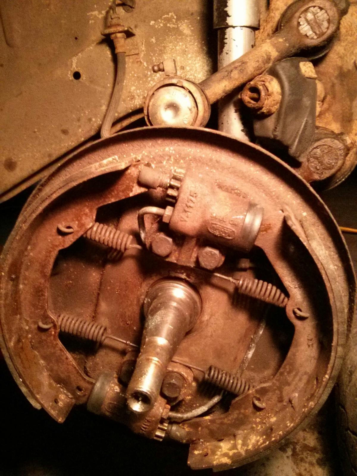

I also took a few weeks worth of evenings to clean up the front brakes.
Before:
After:
Ok, maybe the befor e and after is of different sides but you get the idea.
I don't have a sandblaster or good compressor so I use oven cleaner and a toothbrush, then drill or angle grinder and wire wheel, then treat with Ospho.
