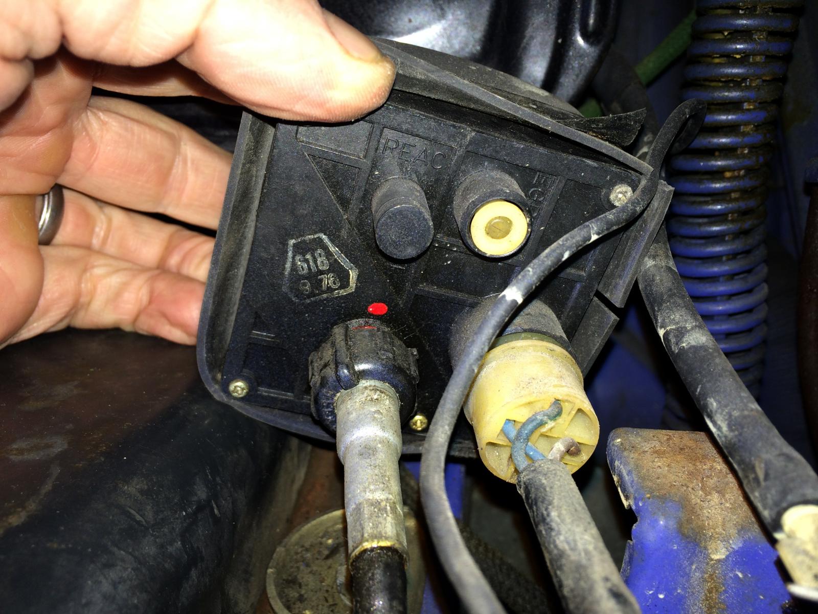

This part is inside the trunk, right near the brake fluid container. No idea what it is. Can't find anything in the book. Anyone know?

its a mileage counter.
trips the 'egr' light in your speedo every so-many miles to reimind you to change the filter.
there is a reset button on the box to turn the light off.
