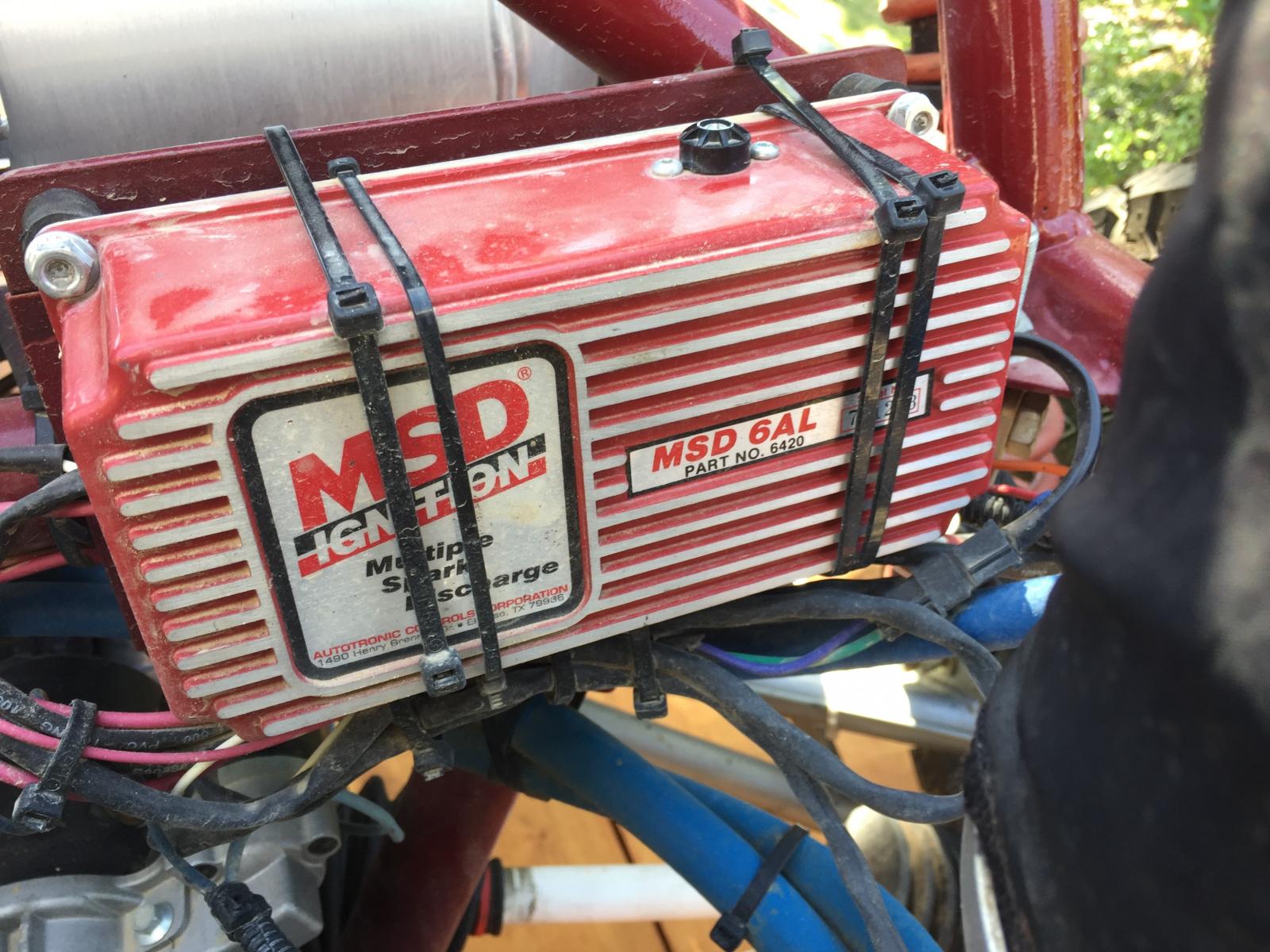

So I've only owned this buggy for a month and I'm going off what I know. See specs below. Compression check excellent, we've adjusted the valves, synced the carbs and she idles and revs nicely. Under load on acceleration she sputters and pops a bit: does not run smooth from 2.5k-3.5k rpms. Loves to run up high in the rpms and rolls along fine at 2k rpms.
Engine: 2276cc, Engle cam, HiRev Dual Spring Lifters, EMPI Big Valve Heads, EMPI Fuel Pump with Regulator, D8EA spark plugs, MSD 6AL Ignition, MSD Blaster Coil
Carburetors: Dual Weber 44 IDF
idle jet: 60
main jet: 135
Air Corrector: 175
Emulsion tubes: F-11
My thought is that the main jet is too small as is the air corrector. Thoughts?
