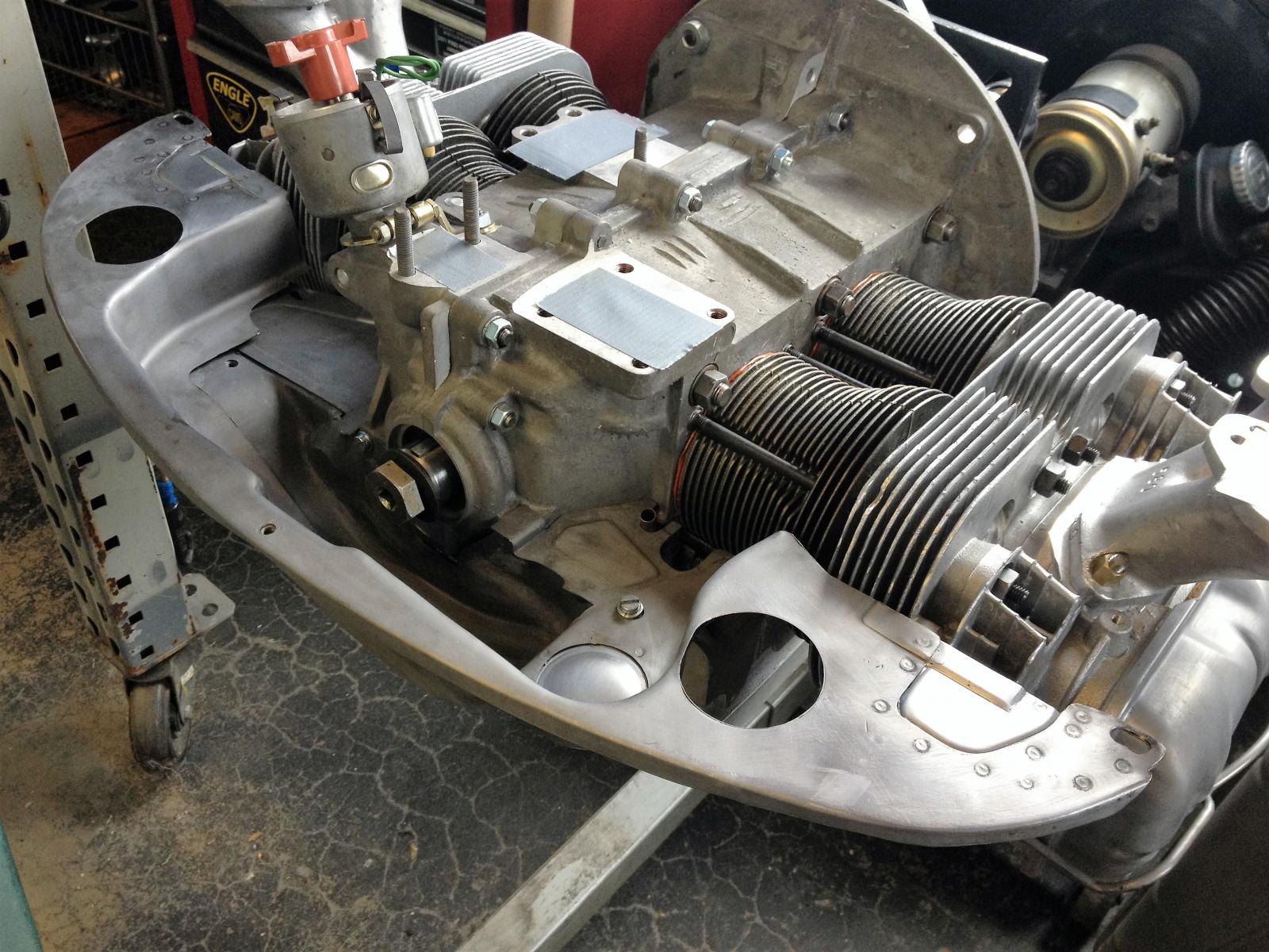

Does anyone know all the kit built by OKRASA?
I know there were the following models, But there were other kit?
- TS30 for 36HP
- TSv1200 for VW1200. 36HP or 40HP ???
- TSV1300/30 for 36HP
- TS34 for 40HP
- TSV1300/34 for 40HP
- TS40 for VW1300
-- TS1500 for VW1500
-- TSV1600 for VW1600
- TSV1600HS for VW 1302 and VW1303
- TV1700 for VW1500, VW1500S, VW 1600L and VW1600TL
- TSV1700 for VW1500, VW1500S, VW 1600L and VW1600TL
- TSV1800 for VW1500, VW1500S, VW 1600L and VW1600TL
- TSV1800H for VW1303 convertible
- TSV2000 HS l for VW1302 and VW1303

I made corrections. Do you know of any other kit?
- TS30 for 36HP
- TSv1200 for VW1200. 36HP and 40HP ???
- TS34 for 40HP
- TS40 for VW1300
- TS1500 for VW1500
- TSV1600HS1 or TSV1600HS2 for VW 1302 and VW1303
- TSV2000 HS1 for VW1302 and VW1303
Person has additional info ?

I'm not sure if mine has been identified. Any help would be appreciated.

I like the linkage for the Zeniths. Do you have any more pictures of it?

Can you take more pictures (intake manifold, linkage, carbs, etc....)?

From what I understand, the original owner purchased the car and immediately took it to Oettinger where the modifications were done. He said it was faster than the Porsches on the Autobahn. The car is a 66. I don't think the motor has been out in decades.

Current plan is to install this American style, vintage speed motor in it while the Okrasa gets restored.

The carbs seem to be 32NDIX.
The heads are dual port or single port ?
The intake manifold seen to be single port

Okrasa heads, dual port. Steel manifolds.

I don't know Okrasa or Oettinger kit with carbs 32NDIX
The attachment of the intake manifold to the cylinder head is done with 2 or 3 fixings ?

That's what makes it unusual! I've had other experts tell me the same.
Three studs as per Okrasa.

This kit looks a bit like the Sauer (apart from the intake manifold)

In the Sauer photo above, what is the thing sticking out by the lower pulley?

I don't know. Crankcase ventilation??????
On this enlarged photo there are 3

I made a mistake I see 4 on the picture.
