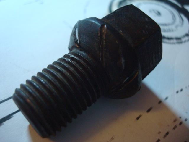

Cdennisg shared this genius idea
modified lug bolt for paint/powder coat removal
I used a cold chisel to plow a few grooves in a lug bolt. a quick spin with a drill and socket and the freshly coated lug bolt holes are shiny and free of paint, awaiting fresh contact with a lug bolt seating surface.
