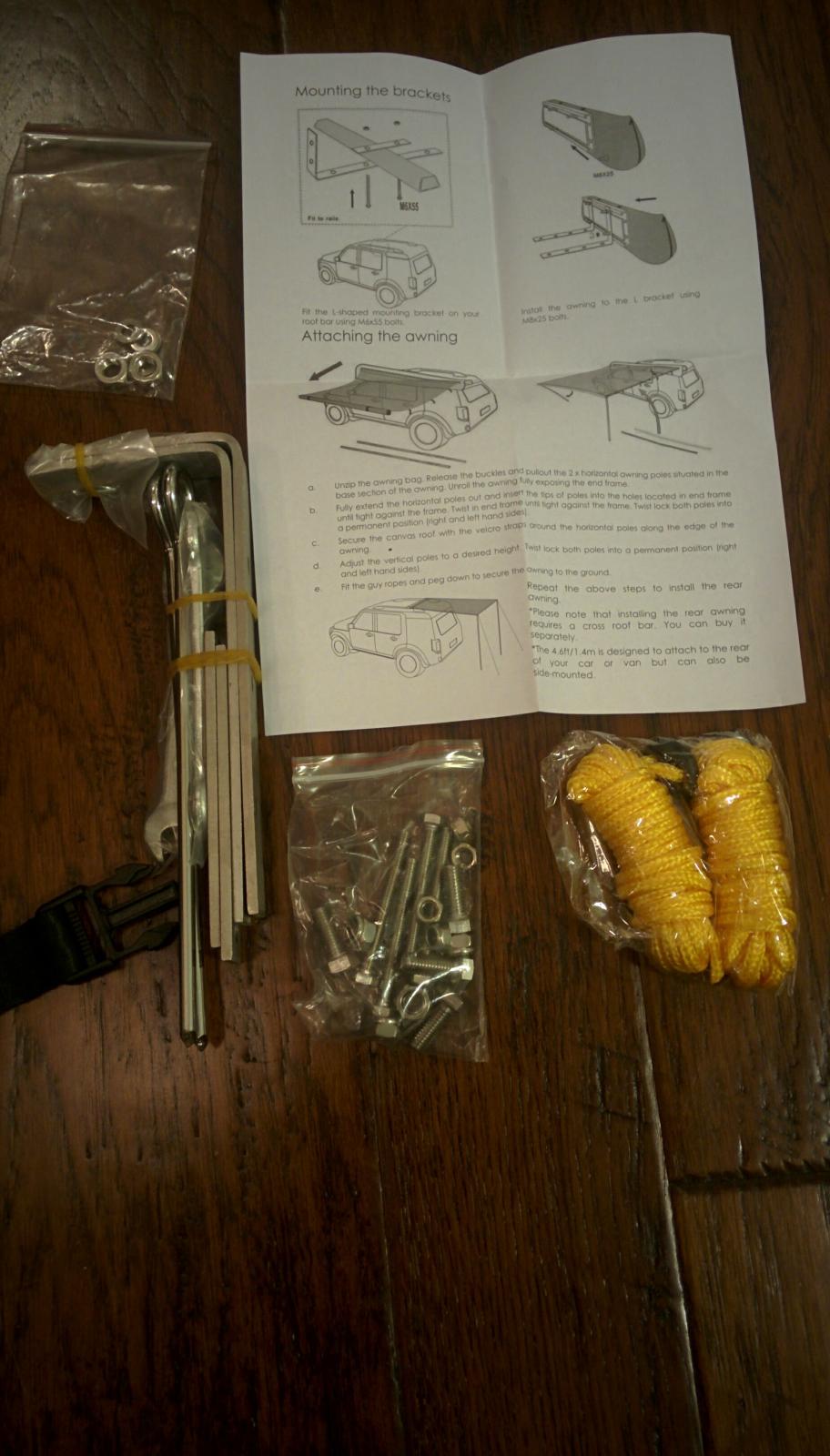

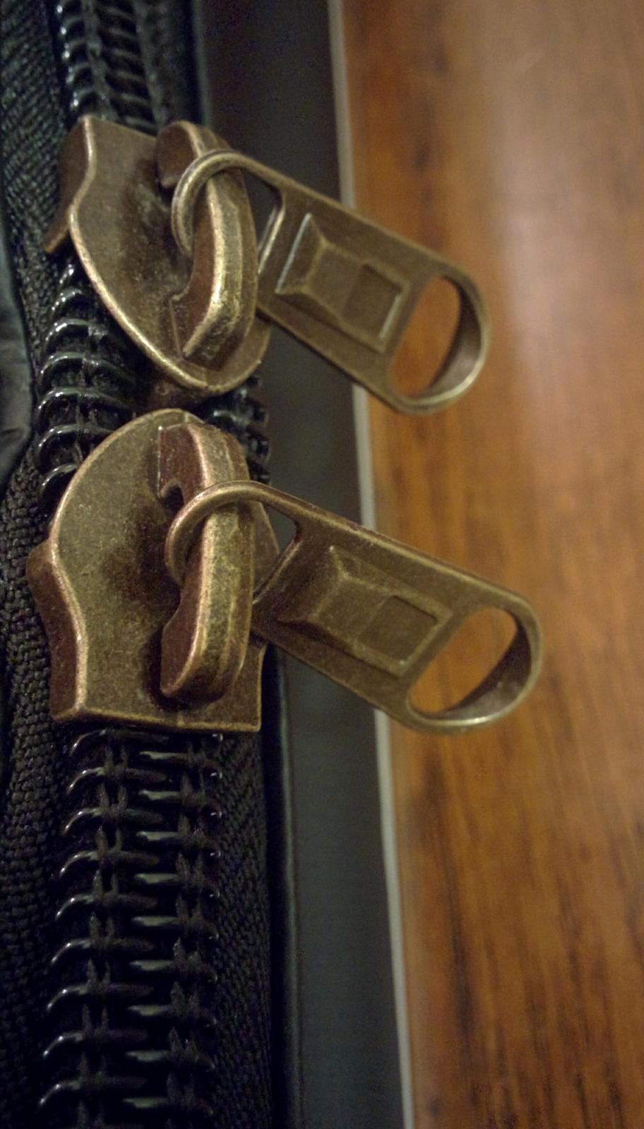

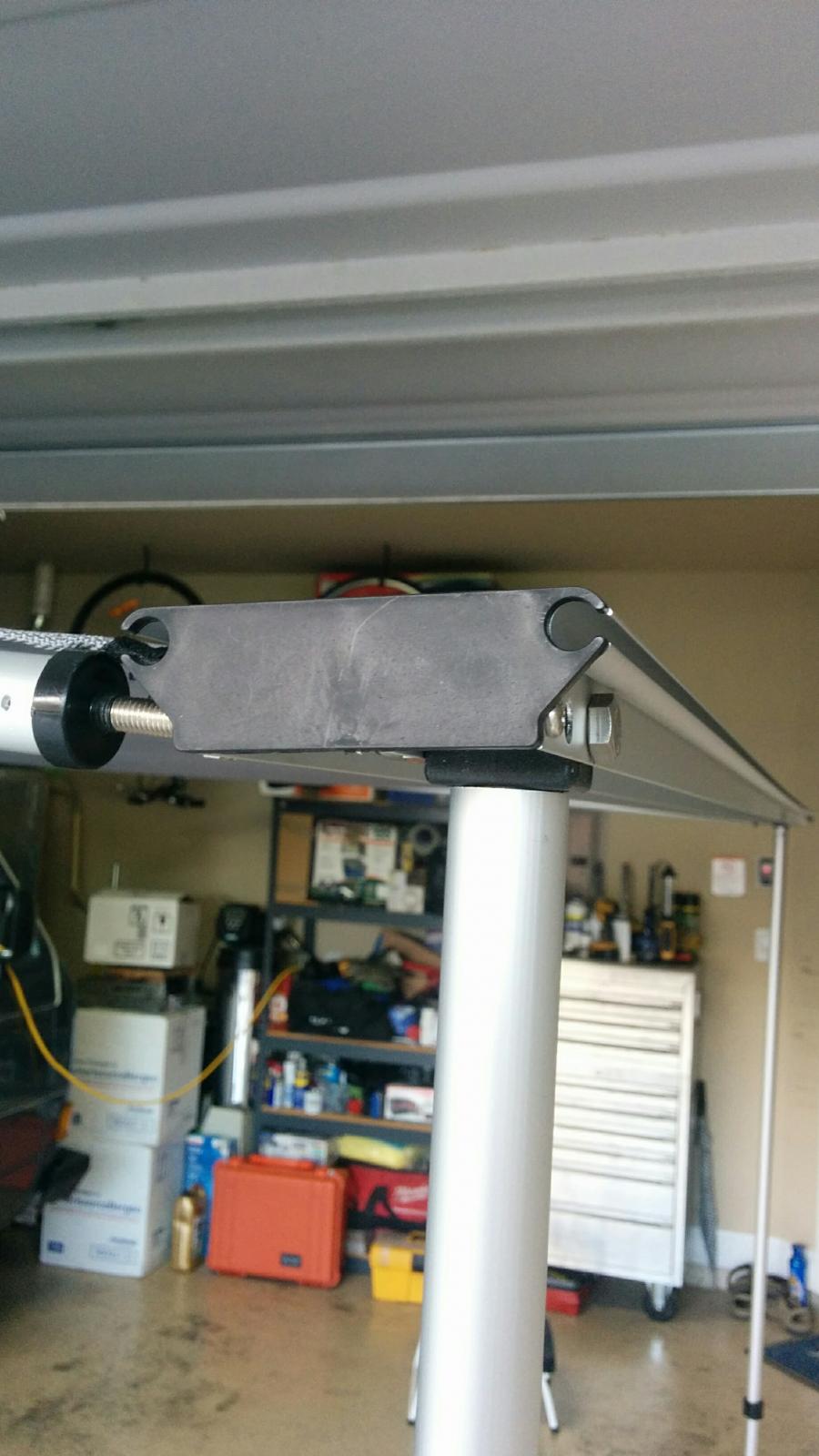

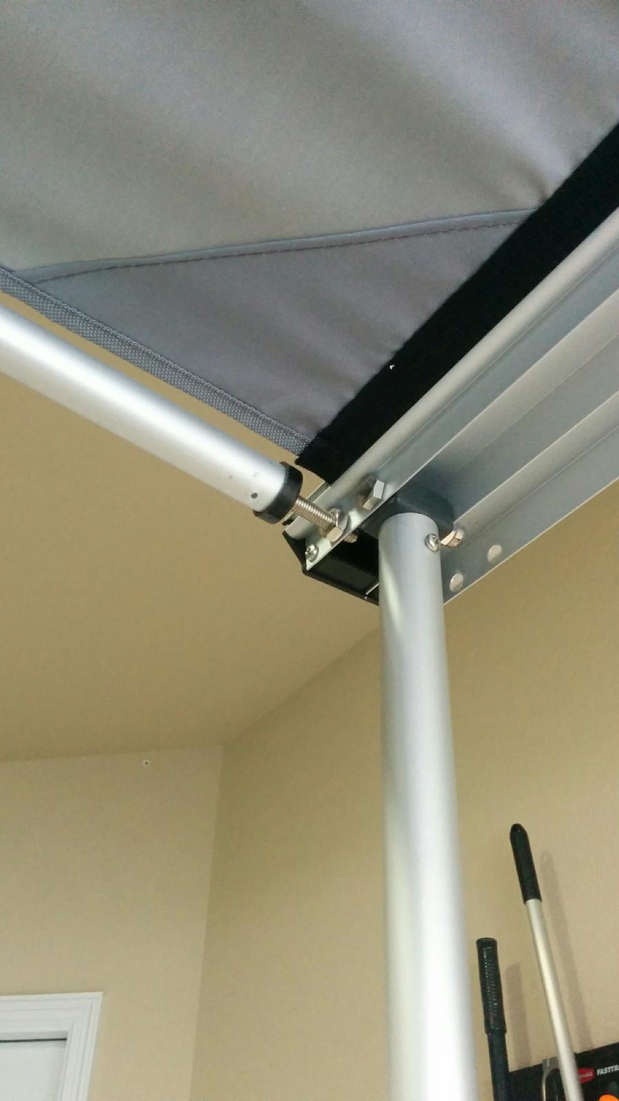

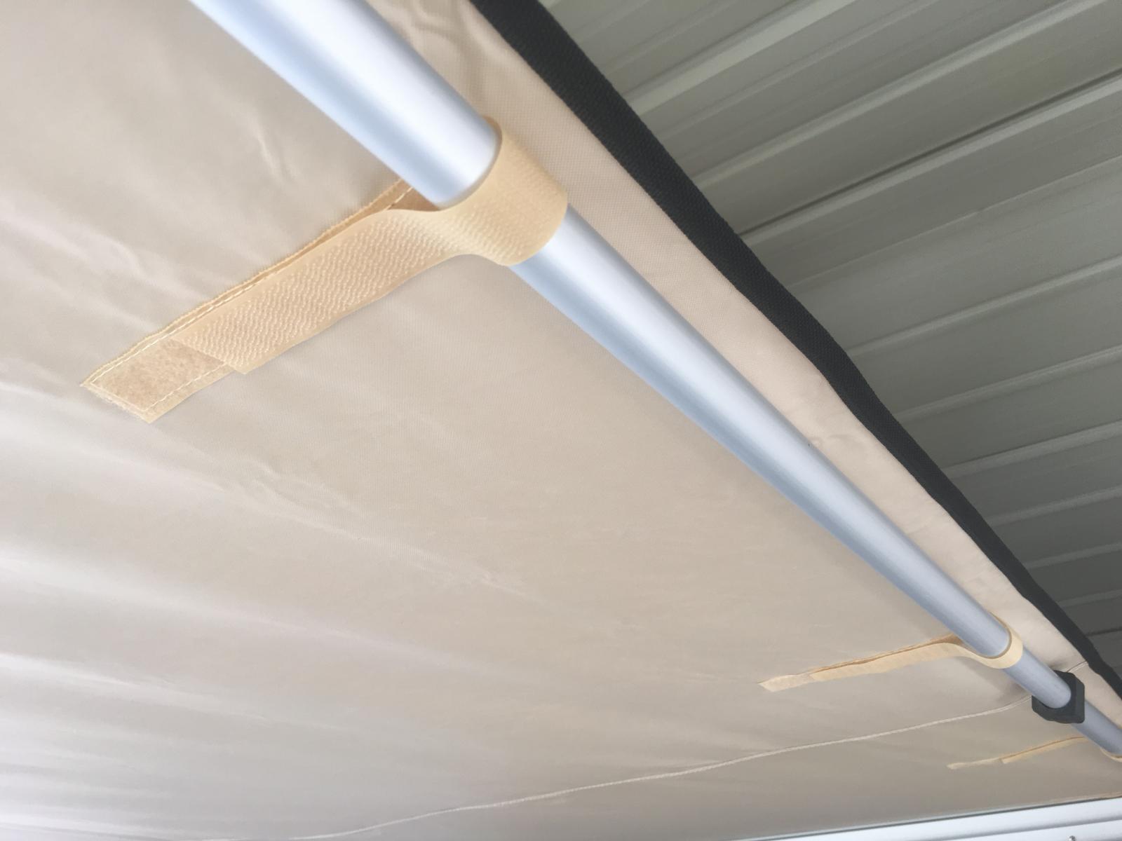

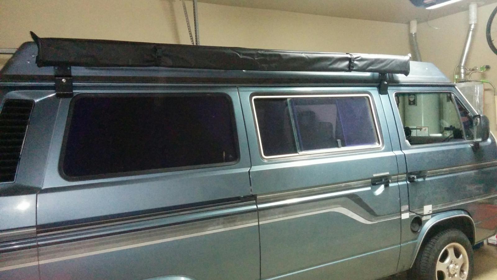

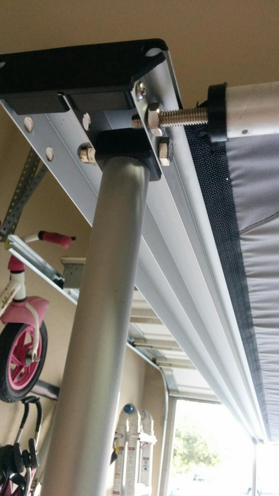

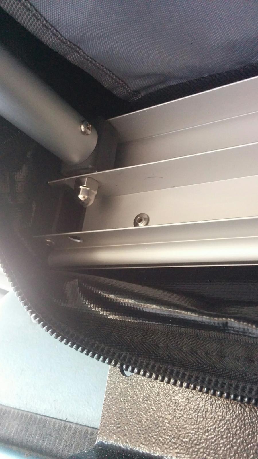

So my feedback of the cheap Yescom awning.
easy mounting with couple of minor issues. I recommend using the GoWesty mount, its a bit cheaper and you have to drill the holes anyway. I ordered the RMW mount thinking it was a direct fit, well it wasn't, I had to add one hole in the middle (see pics on the mount bracket).
- awning is somewhat decent, not bad for the price
- corners are reinforced with additional fabric
- poles are telescopic and twist lock
- horizontal crossbar has a double channel for additional shade attachment
overall, I think it is pretty good for the price, definitely not as the same quality as the ARB awning.
this awning would be a good additional second awning for the price.

I like the ARB zippered casing, it's made of truck-tarp material. ARB's prob gonna look good (outside) for longer. But you guys are storing your valuable vans under cover right? Wink

Great photos of the walMart awning. The tarp material alone would cost that much or more at retail $. It looks like a decent product.

Nice. Does everything end up in that enclosure on the van? Or do you have some poles that get stowed elsewhere?

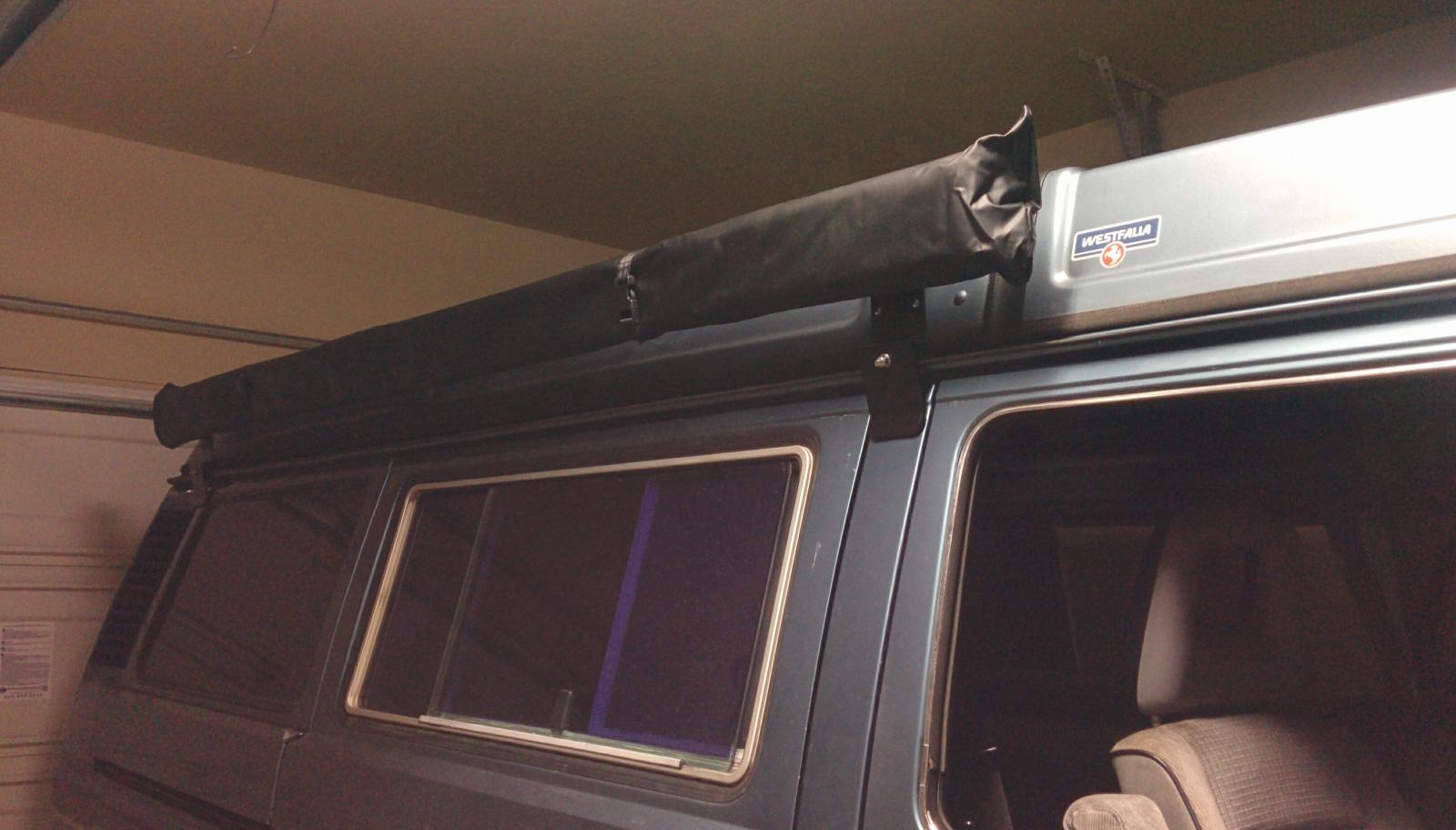

Got it attached on a frozen Turkey day!

^^^ Looks like a productive morning! It also looks like you’ve got some sunshine! We have a pleasant cast of grey here in Seattle.
I think someone on the ARB awning thread was looking for a black bag. This might meet their needs.

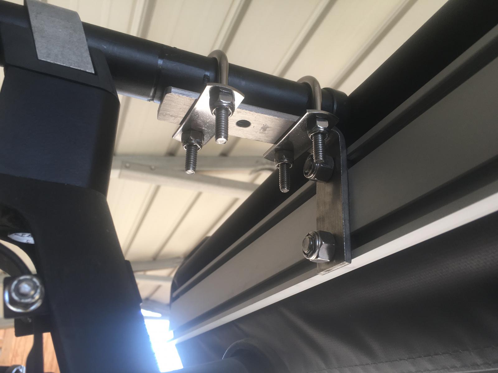

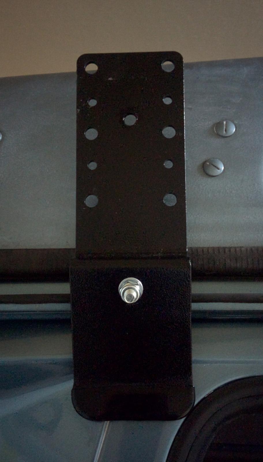

I also said "yes" to Yescom. Installed it yesterday. A couple of issues:
I have a tintop with a full Megawarrior safari basket and Yakima bars. I used some stainless steel u-bolts to clamp it to the bars. Replaced the standard nuts with SS Nyloc nuts. I had to cut about 3" off the ends of the two brackets to get them to fit where I wanted them.
Also: The bolts that came with it would spin inside the channel when I tried to tighten the nuts on, so I purchased some 3/8"x3/4 SS bolts that had bigger heads. The open slot in the extrusion was too small for 3/8" so I removed the thread up close to the bolt head with a grinder to reduce the diameter and they slid in after that. Added Nyloc nuts there as well. Of course the brackets had to be drilled out larger to accept the larger diameter bolts.
If I stay happy with the location, I may drive some self tappers through the extra holes in the brackets into the bars for a little insurance, but they are very secure as it is right now.
So far, so good. Happy with the price/quality so far, based on what I see.
