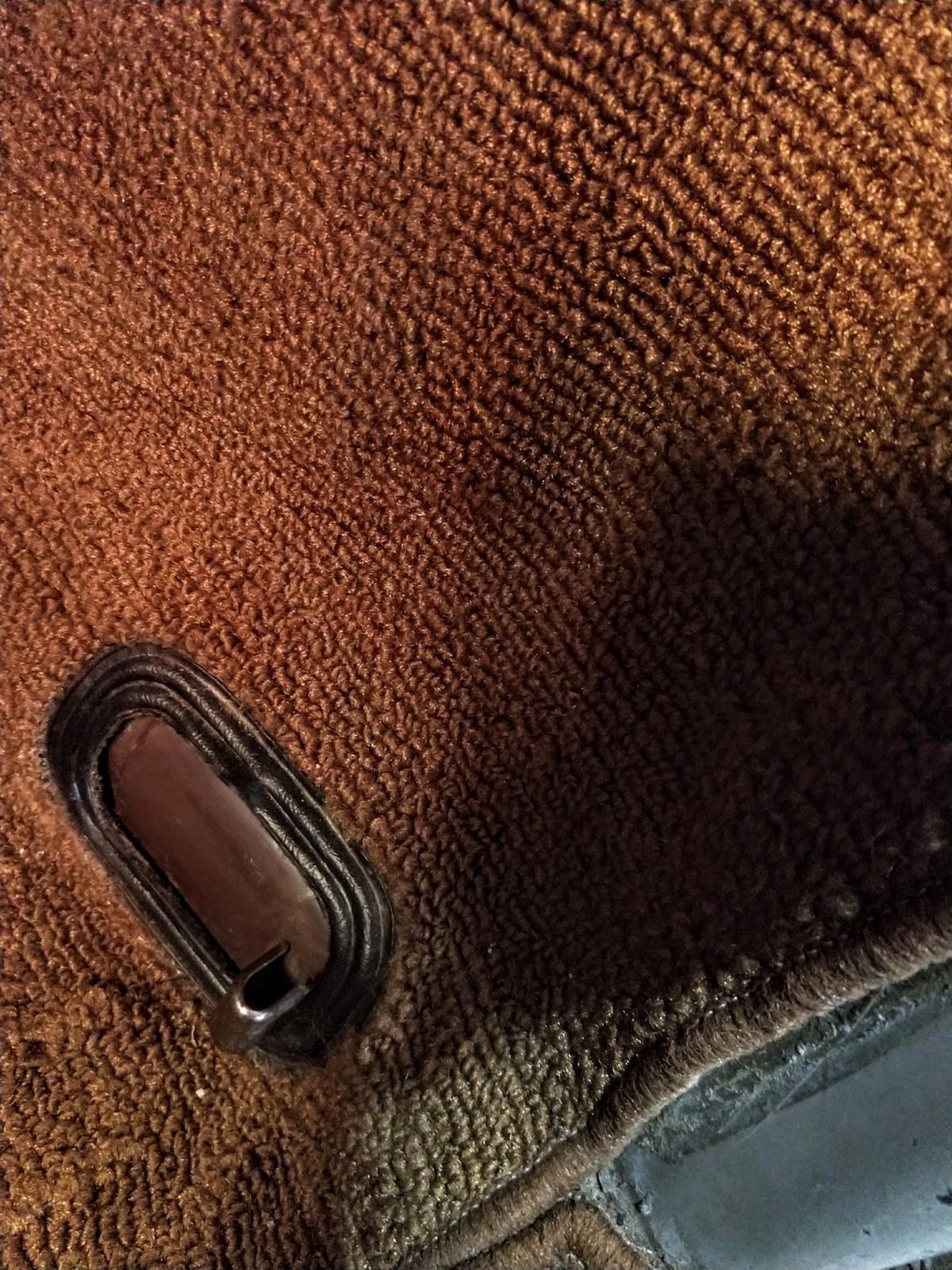

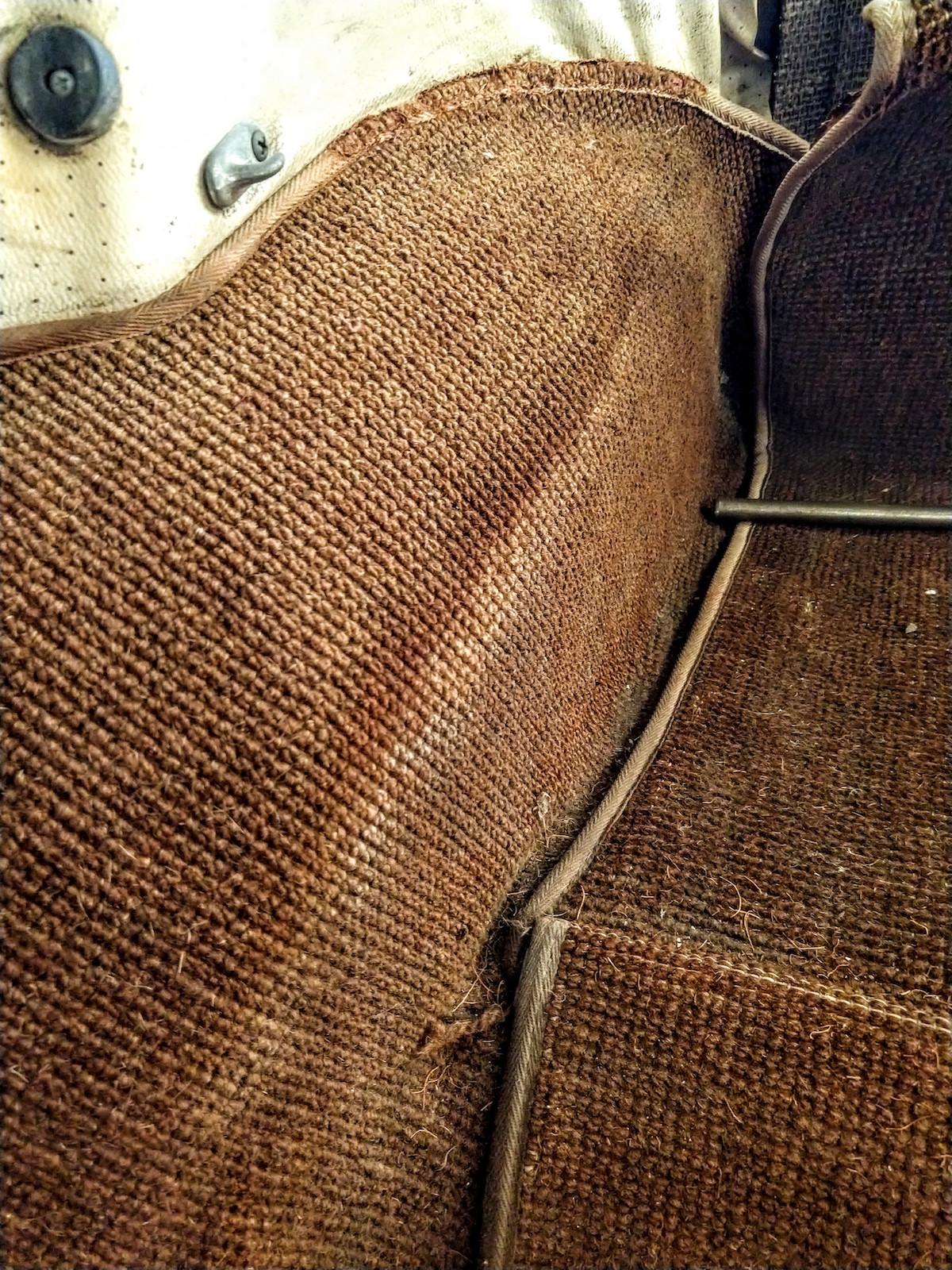

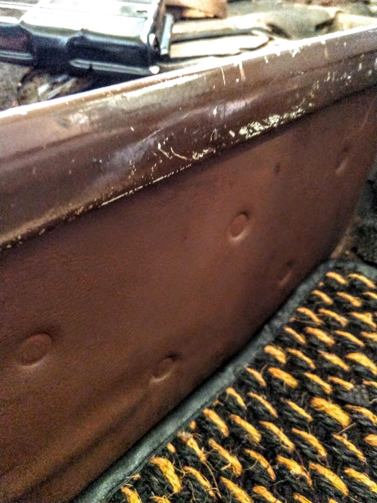

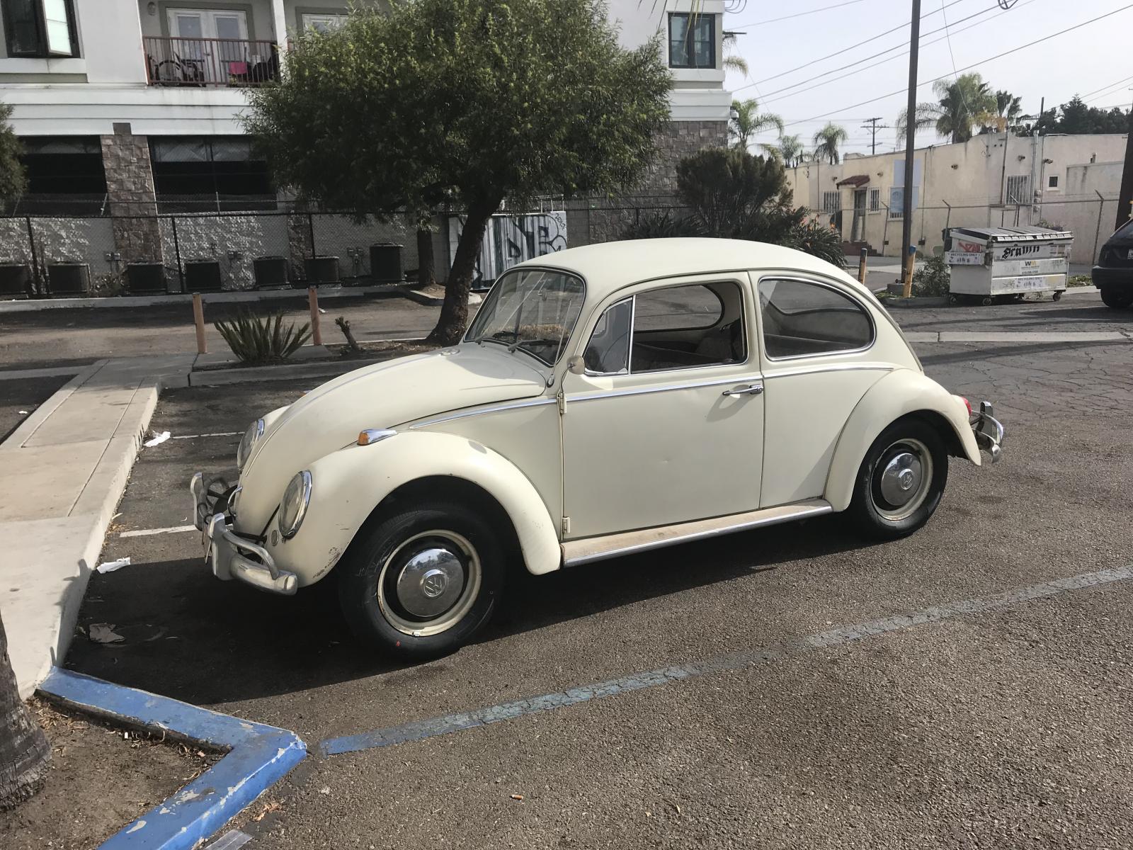

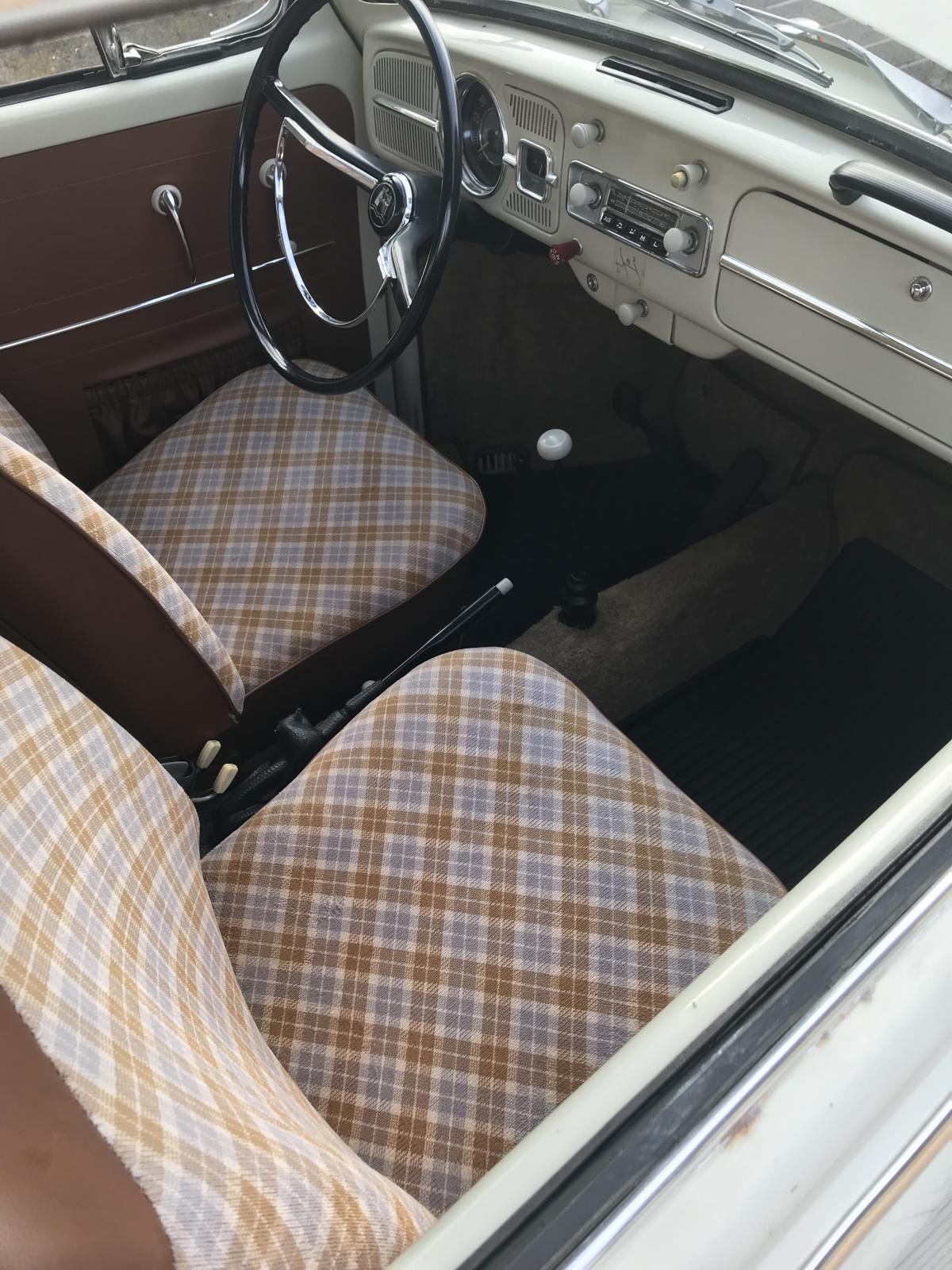

I recently acquired this 1966 beetle, which is mostly rust free and not very molested.
From what I can tell, the seats have been recovered. I'm needing photos of the correct interior so I can track down correct replacement covers. Does anyone have reference photos that I can use?
Brown seems to be the correct interior color because the rear kick panels, rear seat support, and the metal carpet hardware are brown. The front carpet is tan and the rear seat carpet is dark brown (not sure if mismatched carpet is original, both are aged and square weave).
I added the black all weather mats after I cleaned the carpet so that it stays nice.

Your original interior would be called Teak. Not sure if the brown that Wolfsburg West offers is the correct color.
As much of a correctness snob I am, I really like the way the interior looks as is in this car. Although I don't think the material the seats are done in will last long.

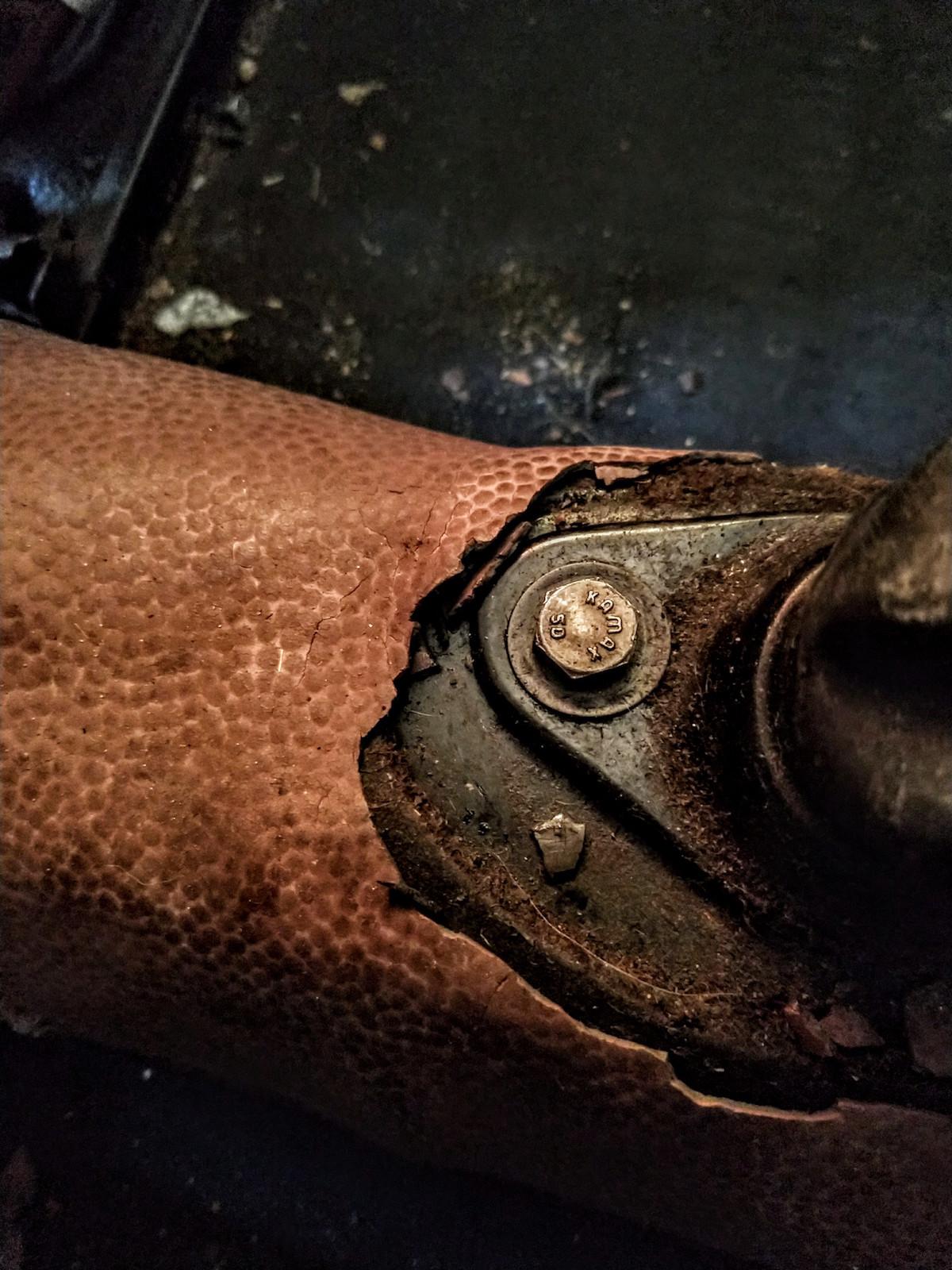

1966 Seesand bug with Teak (brown) interior...side panels, kick panel, floor rubber mat, floor air vent...

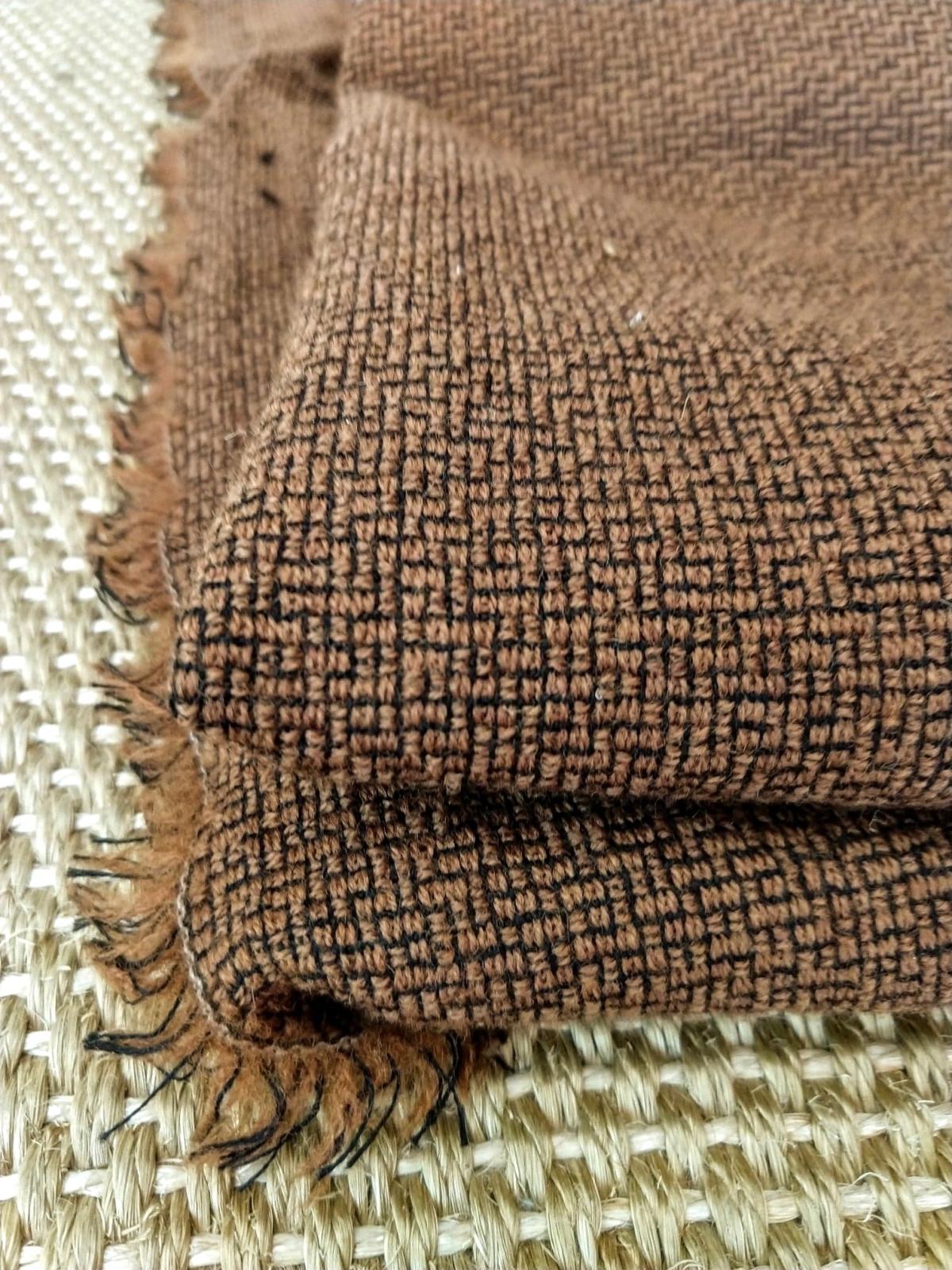

In my previous post from 2018 I was asking for a source of original wool fabric or an accurate replica to re-upholster my seats...it took 4 years but I was finally able to find a close match to the original pattern (wool with black nylon threads)...

You'll have to purchase the platinum fabric from SMS in Canby and then have it dyed in teak color by a wool specialist...the white wool will take the dye very well, while the black nylon threads will not get affected...

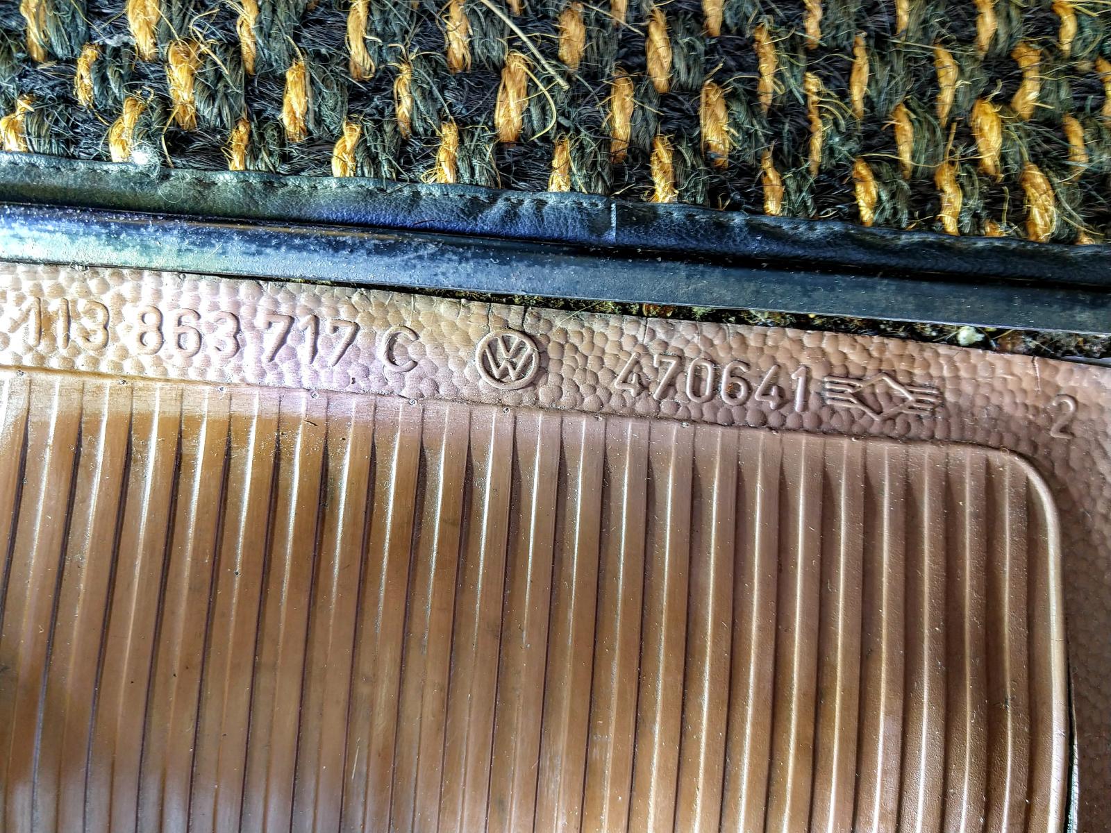

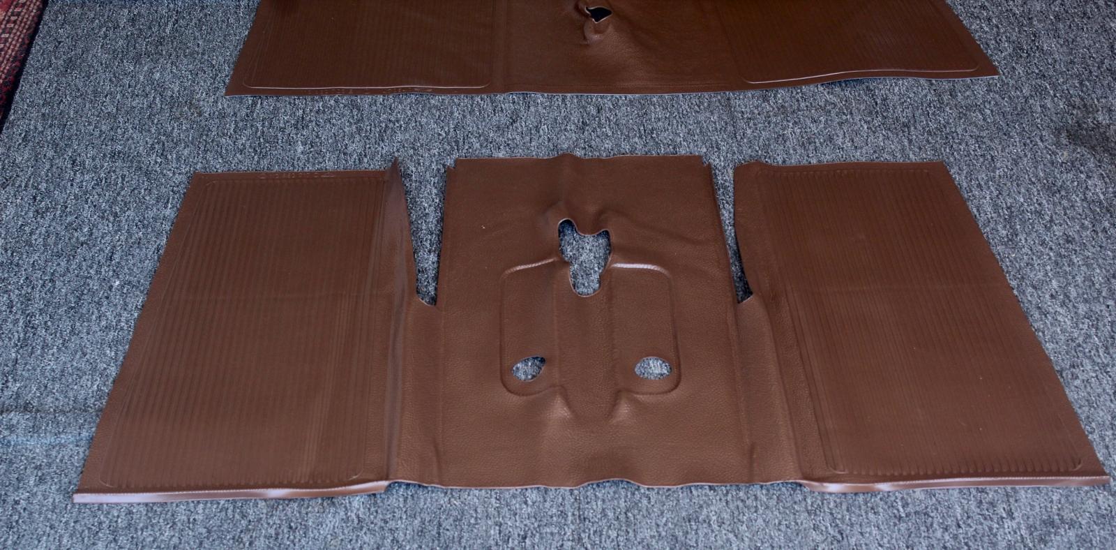

I'm adding a few pics to this thread for people still interested in restoring a 1966 Seasand or Pearl White euro beetle with original teak interior. The original '66 rubber mats are similar to the teak interior panels as shown in the following pictures...
