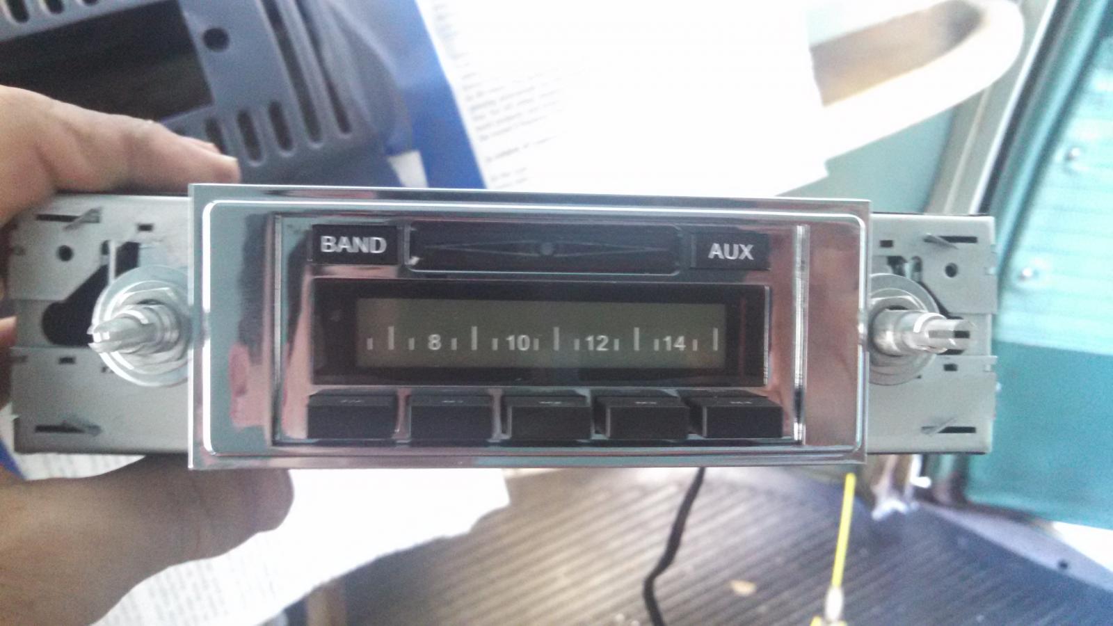

I have a custom autosound radio in my bug. It works good and has the aux jack for playing music from your phone. I would like to get a retro looking one with Bluetooth though so I don’t have to mess with wires.

Stay away from the Custom Autosound brand - complete shit. I've owned two - they are junk. Channels cut out, occasional buzzing, zero customer service.
I will happily sell you mine for $50 if you want a cheap piece of shit to fill the hole in your dash.

Wonder if I got lucky then. Mine was in my car when I bought it 2 years ago and it still works fine.
