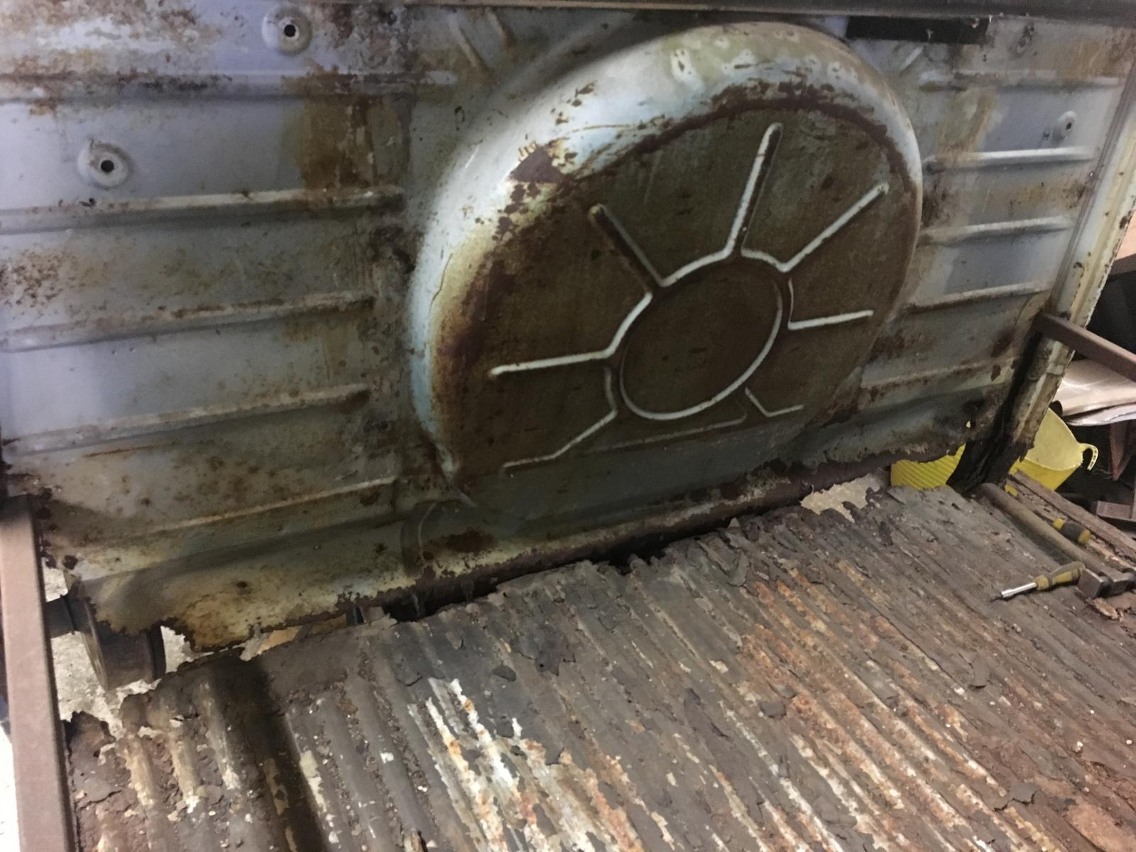

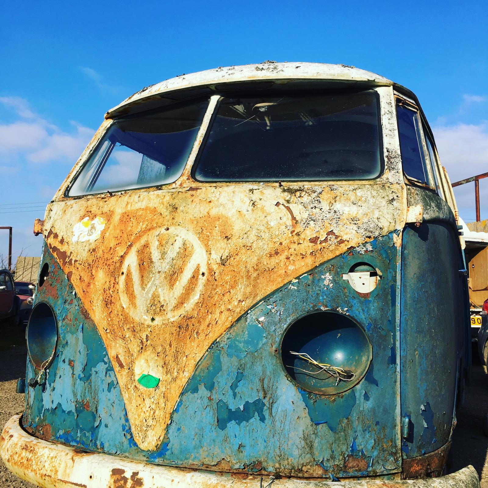

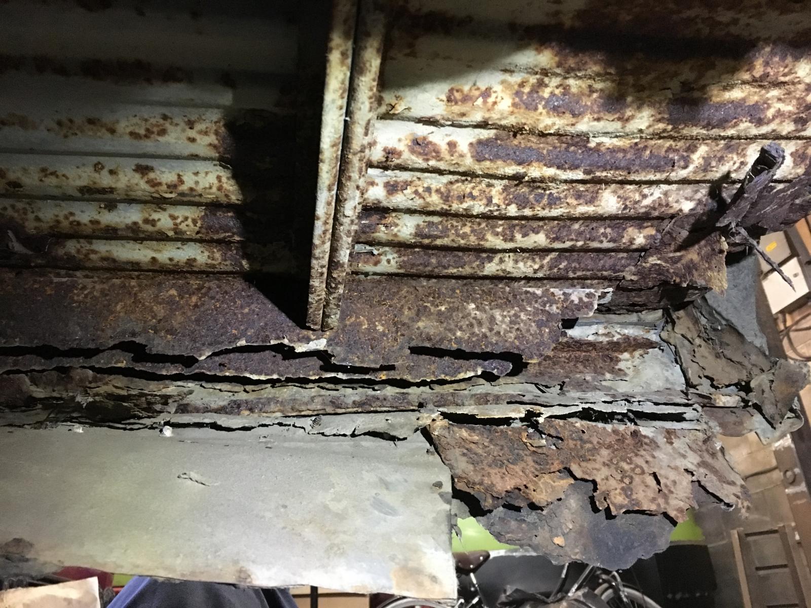

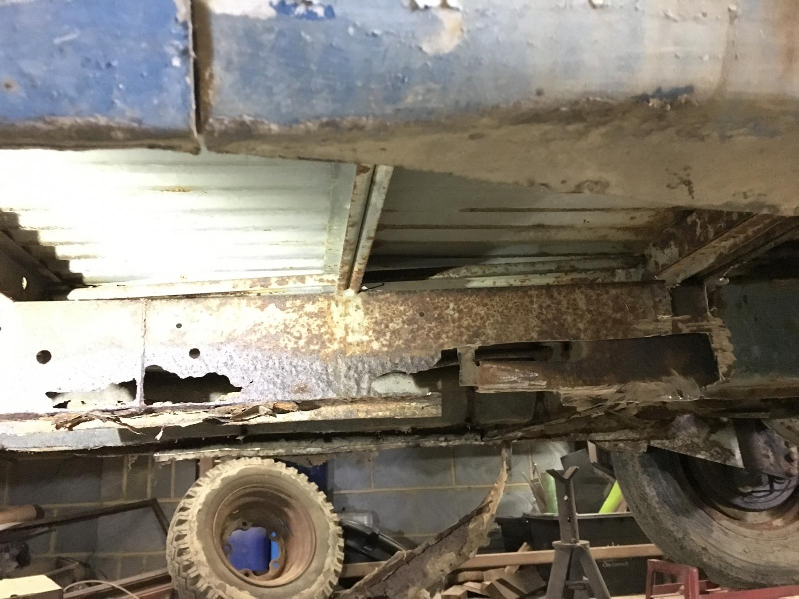

Hello all. This is my '66 microbus. I got it in February and have been doing bits and pieces on it round other work since. It's a very early '66, production date is 6th July '65. It was exported to Sweden, to an island called Alno where I reckon it was used as a minibus/school bus or similar. It then lived in a field under trees for decades, hence the lichen and moss. It's weirdly rusty in that lots of bits are good, better than it looks, but some bits are really bad. the bottom of the bulkhead, front floor support and outriggers and chassis rails, crossmember, and sills are kippered.

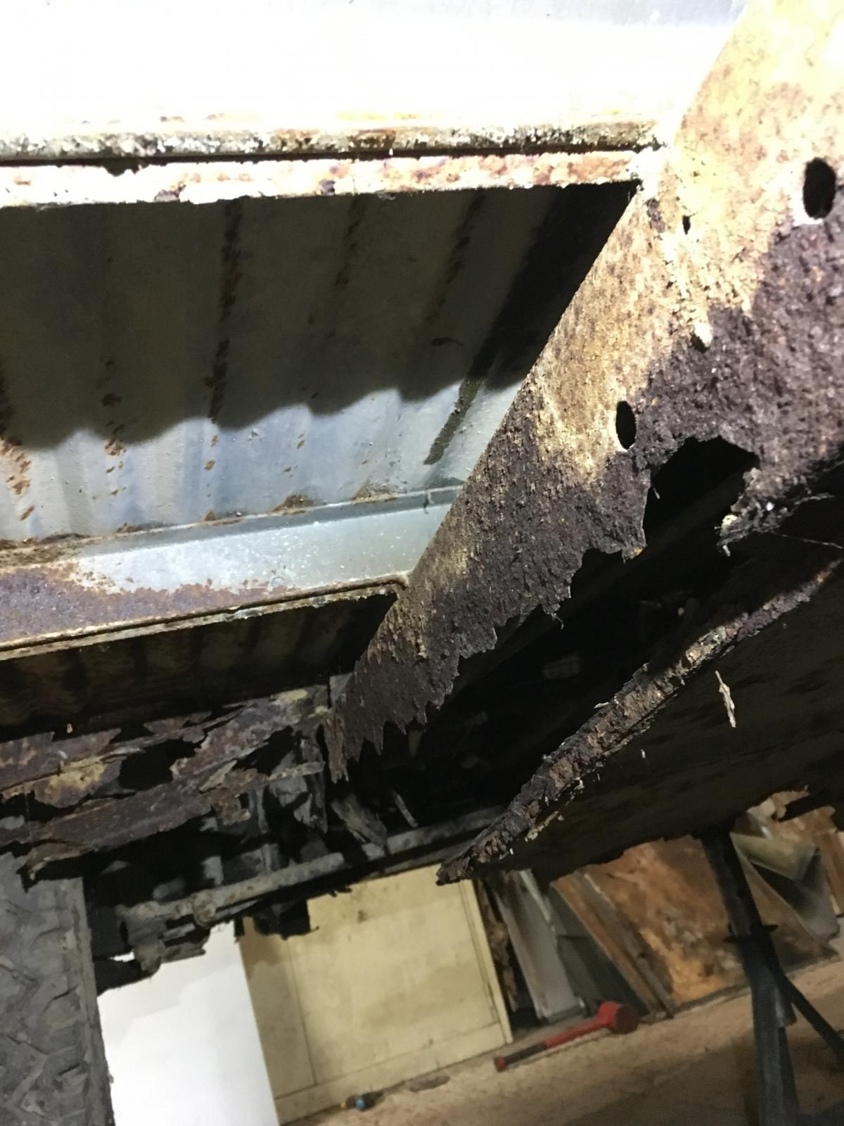

Some pics of the rot.

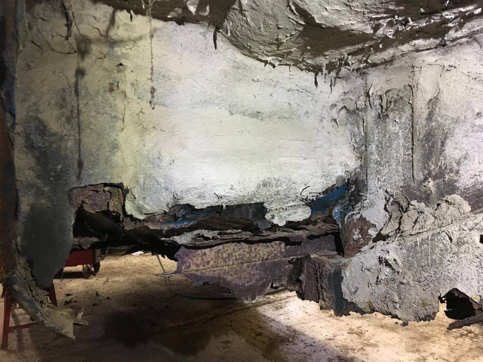

or this thread- i sense a complete frame swap very soon- how this is that tar they smeared on there? that looks like a real treat to deal with! Hoping for big things- keep us posted

Chassis is ok apart from that middle bit, so I repaired. Tar or similar. Couple of cms think in places.

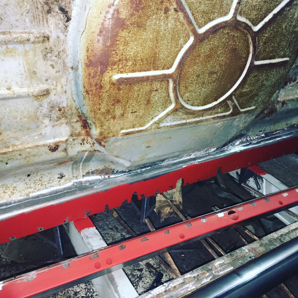

I should mention that I've already done a load of work, I'll try and catch up over the next few days with pics.
Started with chassis repairs. Got the main rails made up in Zintec.

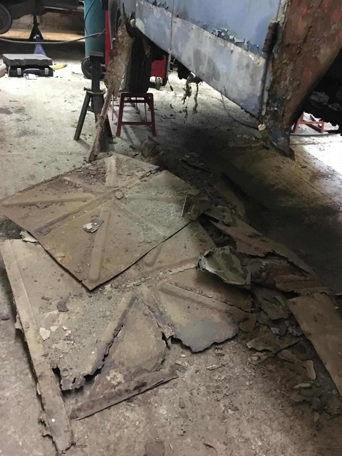

Quick edit. Next bit is new crossmembers, top hats, bulkhead lower section, outriggers, gearshift guide tube, heater tube, inner silks, acc guide tube, repairs to the heat exchanger cable guide tubes. I saved the I beams
