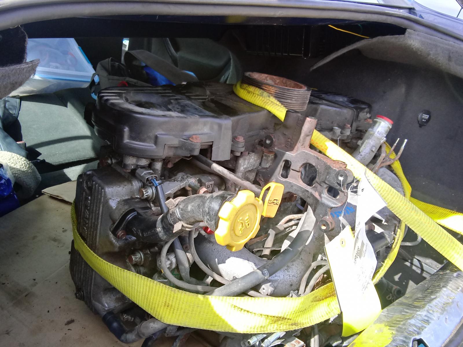

tjet
Joined: June 10, 2014
Posts: 3725
Location: Az
tjet is offline
PostPosted: Tue Mar 12, 2019 3:15 pm    Post subject: Re: Questions on Kennedy CARB approved (California) Subaru EJ22 kit Reply with quote
AZ Landshaper wrote:
Seems to be the same engine w some added smog stuff. I’m sure there’s a code difference stamped into the case but it’s very hard to see below the plenum and wiring harness etc.there does appear to be a few differences that one in the know would be able to ID w/o any problems or inconvenience esp w one of those border patrol search mirrors
Thanks. I did find the vin stamped into the right rear side. EJ22 is cast in on the top.
[email protected] wrote:
I think you will need to swap out a few things. There are some groups on Facebook that you will need to access. Let me know if you need the links. Also the Yahoo group. I would think you are best off if possible to get a 94 and under with ecu and harness. Like find a beater for $500.
Yeah send me the yahoo link. I dont have a facebook acct though.
markswagen wrote:
Good luck finding a cheap beater, not down here at least, you may have better luck north of LA, I search at least twice a day every day looking for donors, there are a few in Portland right now.
Last one down here was $1500...(
I see the prices are higher in the SW. I had to grab this motor as it was only $250.
markswagen wrote:
Finding an engine is MUCH easier than the harness, I'm not brave enough to trust that someone has pulled the entire harness without damaging it, not on my $ anyway, I have 3 customers who want conversions doing, shelling out $ on their behalf, and finding I now own an almost complete rats nest wouldn't be good for my bank balance.
Thats good to know. I'm gonna hit the junkyards for a harness when it starts warming up.
joetiger wrote:
...On mine, the harness went right through my hands, into a box, and off to Tom Shiels. There were a couple of areas that were cut and shouldn't have been which he repaired as part of the service.
Do you have any pics of that harness? Did he thin it down by removing unnecessary wires?
FYI, I pick the motor up tomorrow.

PostPosted: Wed Mar 13, 2019 10:18 am    Post subject: Re: Questions on Kennedy CARB approved (California) Subaru EJ22 kit Reply with quote
Got it Smile noticeably lighter and smaller than wbx.
