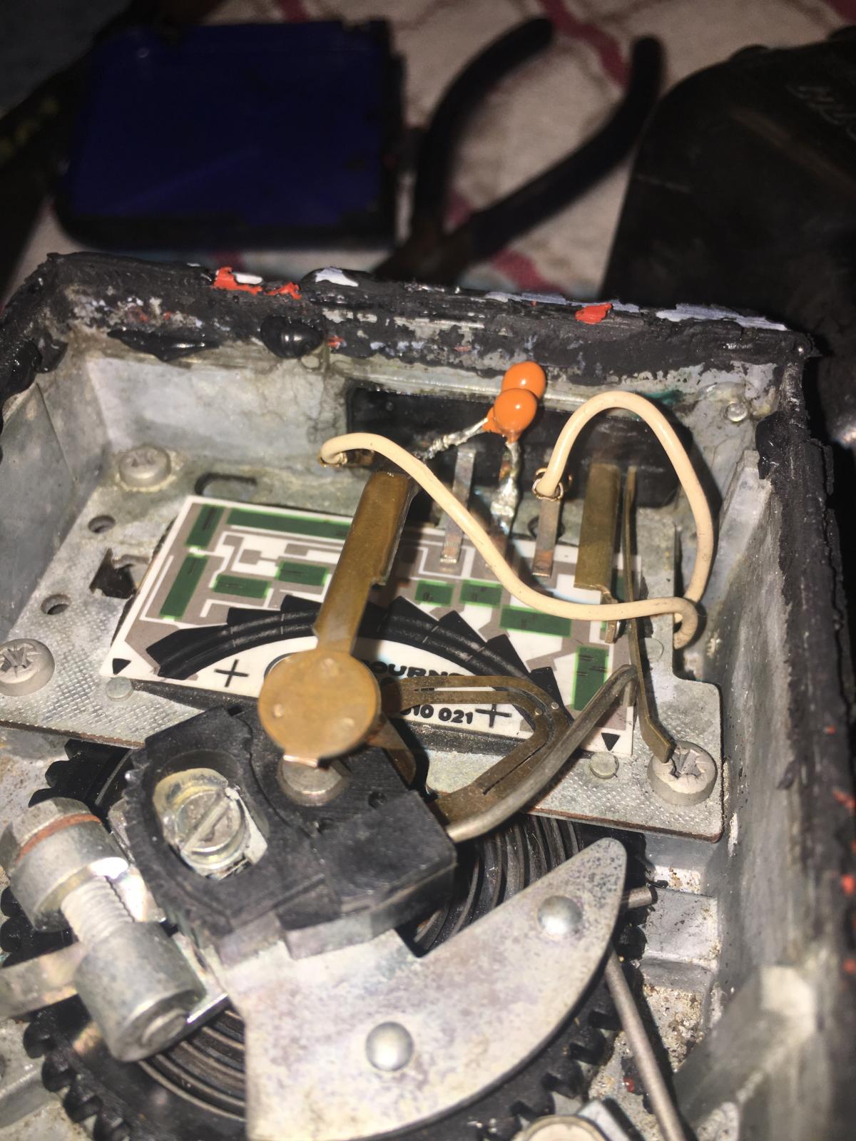

So i was following the capacitor fix and i couldnt get a 22 all i could get was two 10's. Will this work? Did i put them together correctly? The solder job isnt 10/10 will it be fine?

I just twisted two 10s together and soldered them there

You've got a case of series vs parallel wiring.
Not 100% sure about resistors but if you wire two 6 volt batteries in a parallel system like you wired your resistors, you still only have 6 volts at the end. Granted, a strong 6 volts but 6 volts nonetheless.
If you wire the same batteries in a series...... - 6 + ****** - 6 + you wind up with 12 volts.
I imagine resistor play by the same rules?
You only have a really strong 10, not 20 as you have them wired in parallel.

Yes, two 10 microfarad capacitors wired in parallel as you have shown will be the same as a single 20 microfarad capacitor.

A quick search on allaboutcircuits.com shows that capacitors in parallel have an additive effect while those wired in series have a diminished effect. It's the opposite for resistors.
Dave
For resistors, they add as the sum of the reciprocals (1/R).
Voltages are as you stated, batteries in parallel have the same output voltage and double the current capacity. Batteries in series have the same current capacity and double the voltage.

As I recall, the usual instructions for the capacitor fix on a WBX is to bridge terminals 2 & 4.
It appears to me that the OP has bridged 2 & something else.
The OP has an air-cooled and the AFM has different connections so maybe I am miscounting.
Someone who knows should check his work.

I know its 2 and four i believe this to be 2 and four but i dont really know
Thats why i put it here to get my work double checked
Its an air cooled but its also california emissions model so i was hoping it would be the same

Did i miswire it?? Should i solder it to where the little plug goes?
