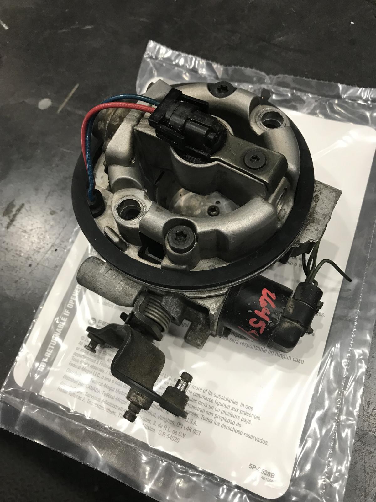

PostPosted: Tue Aug 20, 2019 10:37 am    Post subject: Re: 1300 budget beetle engine upgrade/FI Reply with quote

My 40hp EFI project, using a 90's GM TBI Chevy Beretta. Paid $30 shipped on eBay
