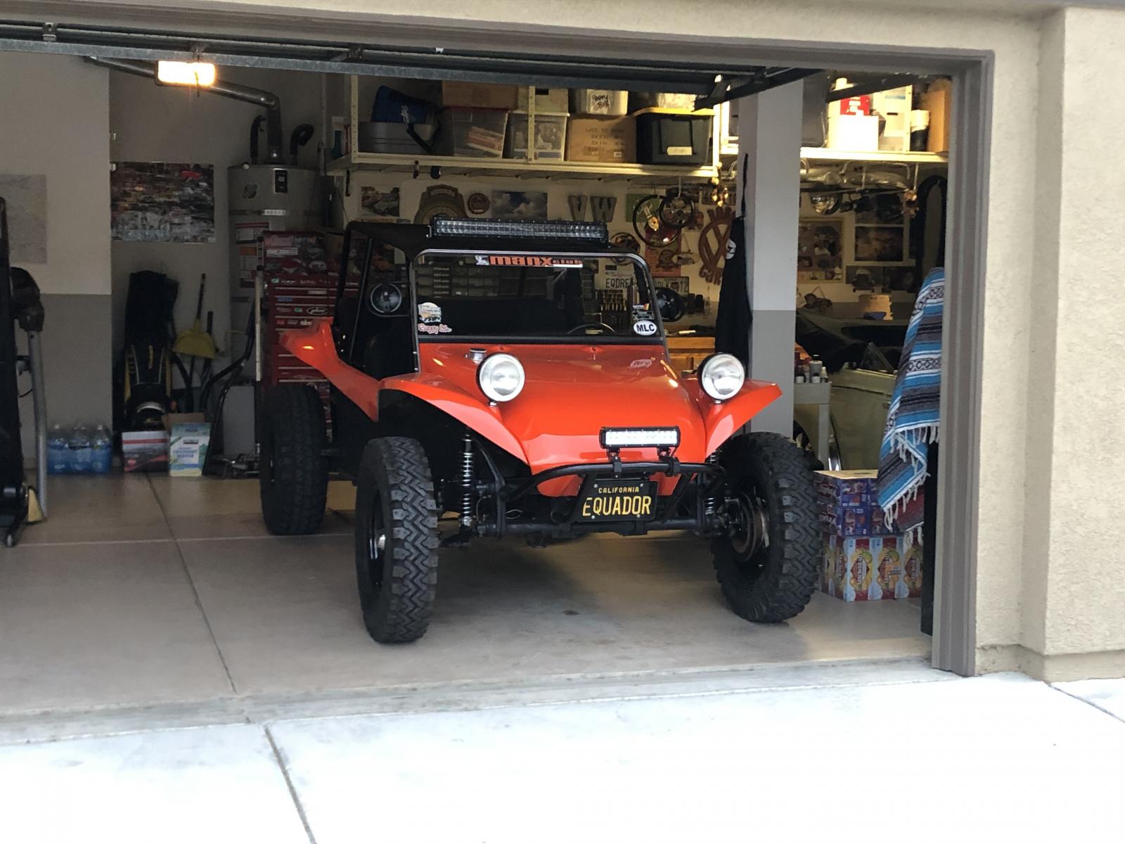

I know this has probably been discussed in the past, but did a search and couldn't find my answer.
I want to swap out the front tire for my dune buggy and wanted to go with a taller/narrower tire. I like the 7.00-15 size tire, but will it fit on a 4.5" wheel? Also I know Mickey Thompson makes that size tire, but can you recommend another brand? I plan on both off-road (back mountain roads type stuff) and street use.
Thanks in advance. Here is a pic of my buggy. VW Logo

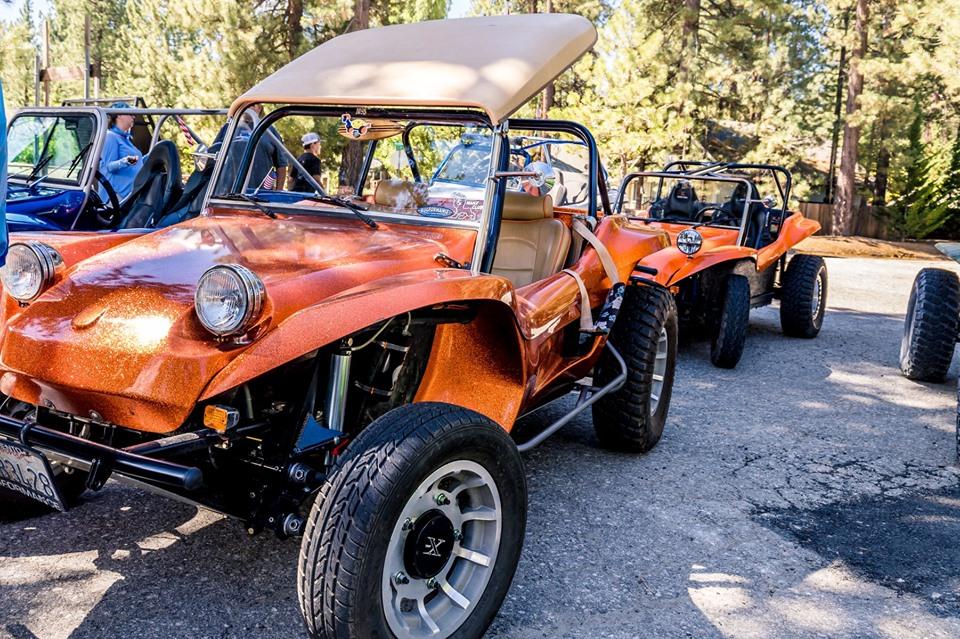

A 7.00-15 will absolutely fit on a 4.5" rim. I am running them on the front of my fiberglass buggy. The desert racers have been running that combo for many many years. The only issue you may run into is getting a big name tire shop to mount it for you. The suggestion is to take it to a small shop and take them the tires and wheels not the car. I'll see if I can find a picture of mine.

Thanks for the info JSTURTLEBUGGY. That’s pretty much the answer I was looking for. Much appreciated.
MIKE E. , what brand tire is that in the pic?

That tire is a Yokohama Y-720 Traction Service tire. It is labeled "For Racing Purpose Only" so it's not DOT approved if that matters to you. I opted for the shaved version. That's where they knock the sharp corners off giving a little more round to the tread.
You have a great looking car.

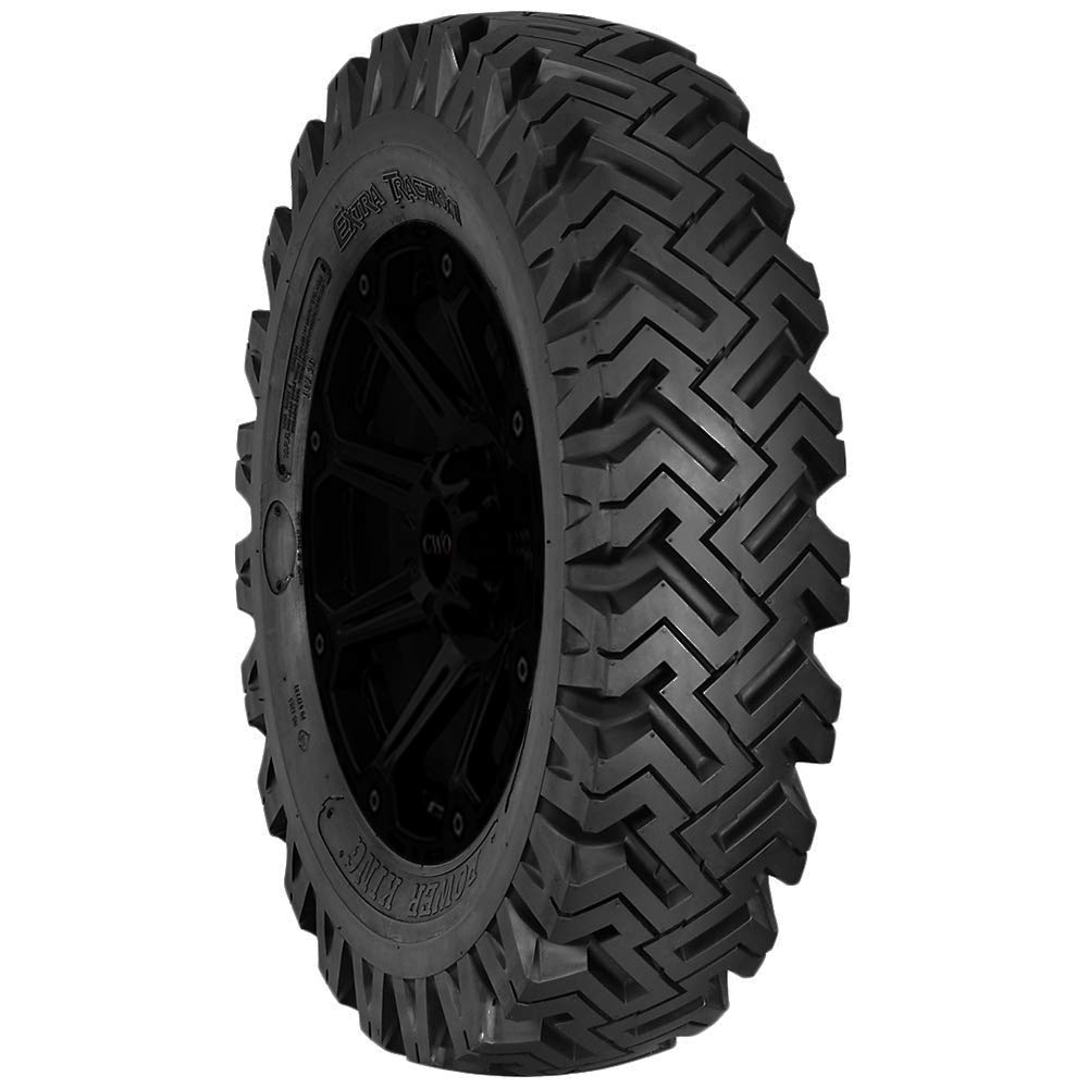

Another option is the 7.00-15 Power King Super Traction II D/8 Ply BSW Tire
https://www.amazon.com/7-00-15-Power-King-Super-Traction/dp/B07FRGLKXM
I ran the Hercules HDT for awhile on stock 4.5" wheels. Looks like they don't make them anymore.
