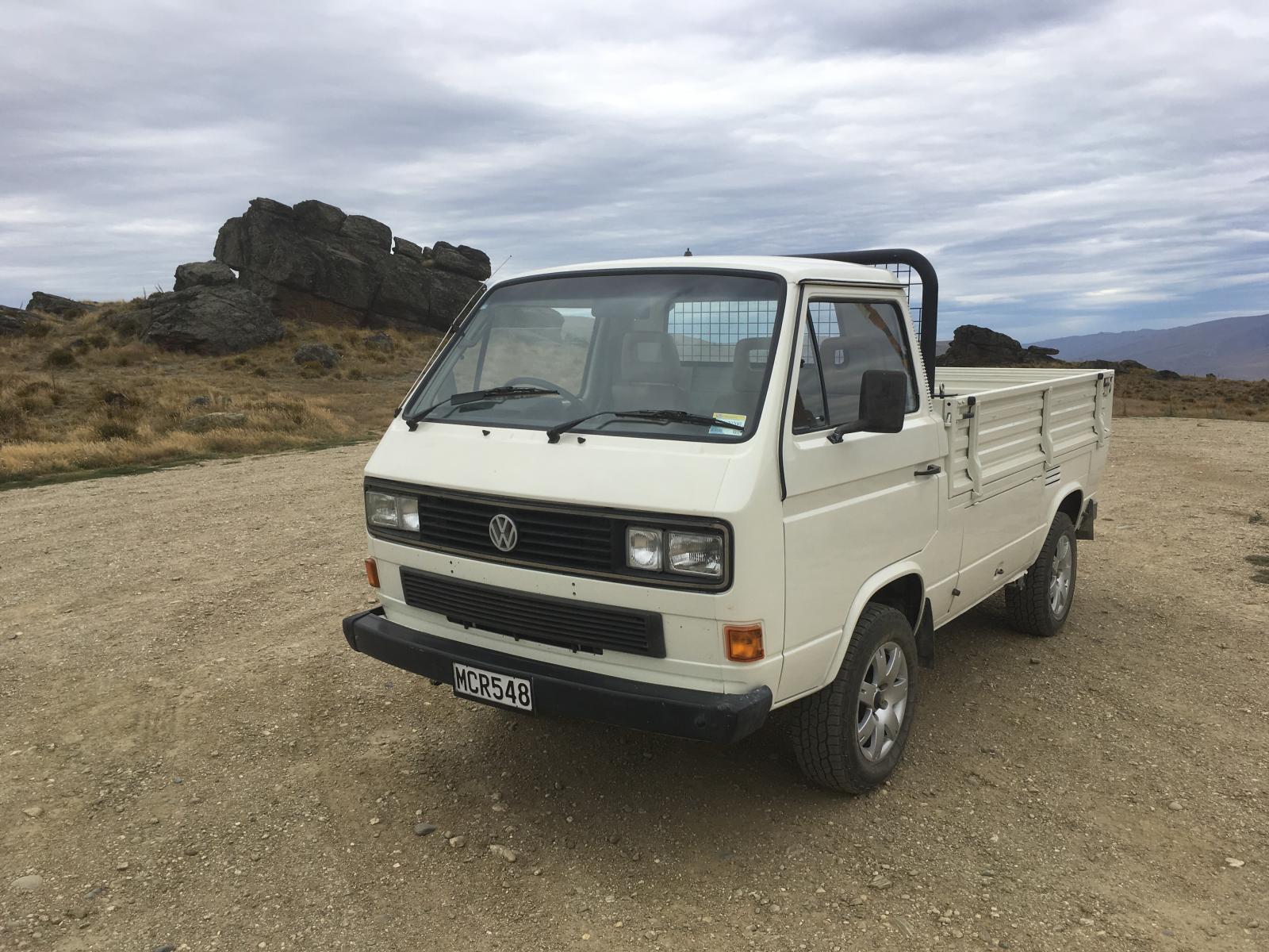

Sorry I have no technical info to share but I do have a couple photos I took of a sweet Syncro Doka with VR6. Maybe some inspiration?
These were taken at a Vanagon group meeting at White Salmon back in '08.
Again, I have no info about who's truck, here's the only other pic I have.
Anyone know the rig?

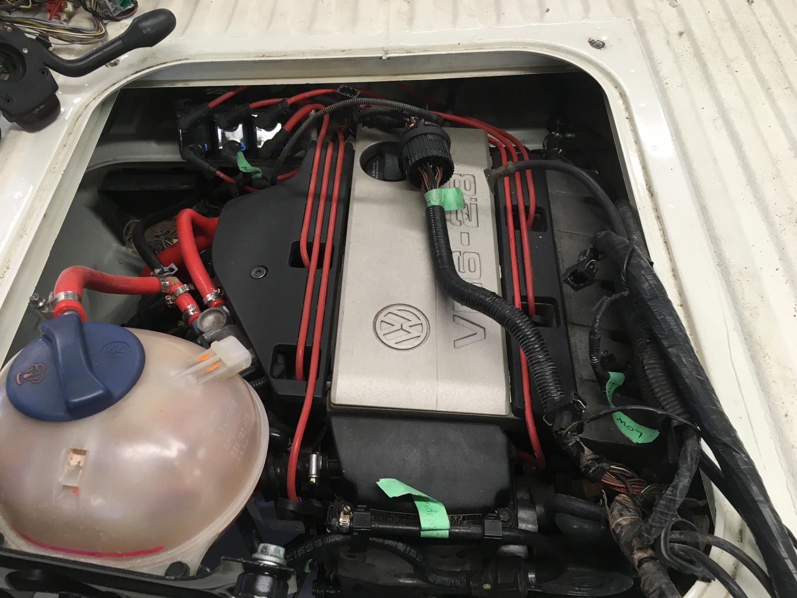

I have got my VR6 (2.8, 12v out of a 1997 Golf) installed in my Sinka.
The only thing to do is the wiring.
An Auto Sparky is coming in two week's time to try to sort out the wiring so that we can fire it up.
I have forwarded him all the info on this page and lots more. Hopefully he has got his head around it.
The donor Golf was imported from Japan. It has no SAI but has an immobiliser which we will have to work with.
The donor had an automatic transmission (my Sinka is manual), so will have to do a few mods to the ecu to trick it into being a manual.
If anyone has got any further info on the wiring mods we have to do, I would love to hear about it.
Attached are some photos of 'The Flat White'.
Cheers Brett

That's a bit cramped but fits surprisingly well for how big of a displacement increase it is. Looks great.

It's nice to see the aluminum t-stat housing and crackpipe. I recall that the SA five cyls used a thick trans stiffener along the top spine. I assume this was due to the extra weight and higher center of gravity.

There is quite a bit of room in there, however with the top engine access hatch being smaller than the vanagon hatch and offset to the left (to accommodate the JX diesel engines I guess), it is slightly awkward to get at things.
However, this is made up for by the excellent access through the rear facing hatch the vanagons don't have.
