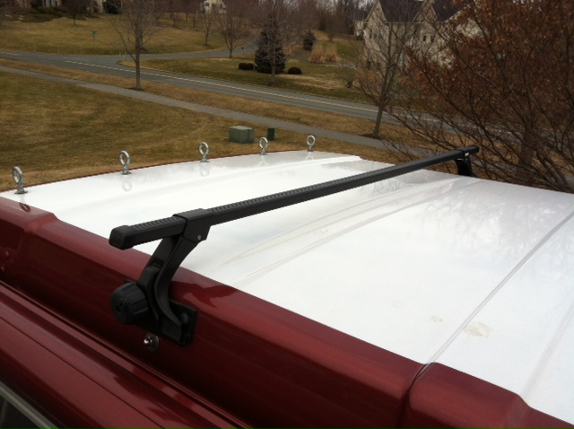

Any suggestions on how to insulate the poptop? Mine is painted tan. We have 8 months of brutal heat and humidity in Miami.
Apologies to the OP for the hijack.
This really helped cut down the heat from my pop top. Easy to do with spray paint if you go this route.

Thanks for the tips Dobryan and Ahwahnee. I was thinking of white vehicle wrap for the top of the poptop instead of paint. Also insulating the undersode of the poptop with a new headliner. Going to see if they can get Aerogel insulation. Used by NASA. I am also considering a double layer top like the tropical top I had on my Land Rover. Get a sheet of Starboard and mount it on my roof rack bars. The only downside of that is it probably wont fit in my garage unless I remove it. I will test a couple of these this summer sith my heat gun. This wiil be cheaper and simpler than dual AC or dual condensers.
I am hoping the tint will solve the problem. I am getting like Ahwahnee

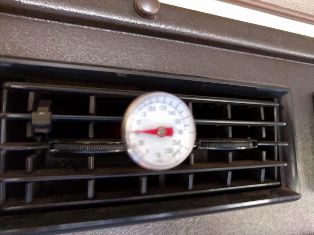

What Temps are you guys getting coming out of the evaporator in the rear?

PostPosted: Mon May 18, 2020 9:10 pm    Post subject: Re: Using Two AC Condensers in Series Reply with quote
Try the white paint or wrap first. I think you’ll be surprised and may avoid the other measures.
