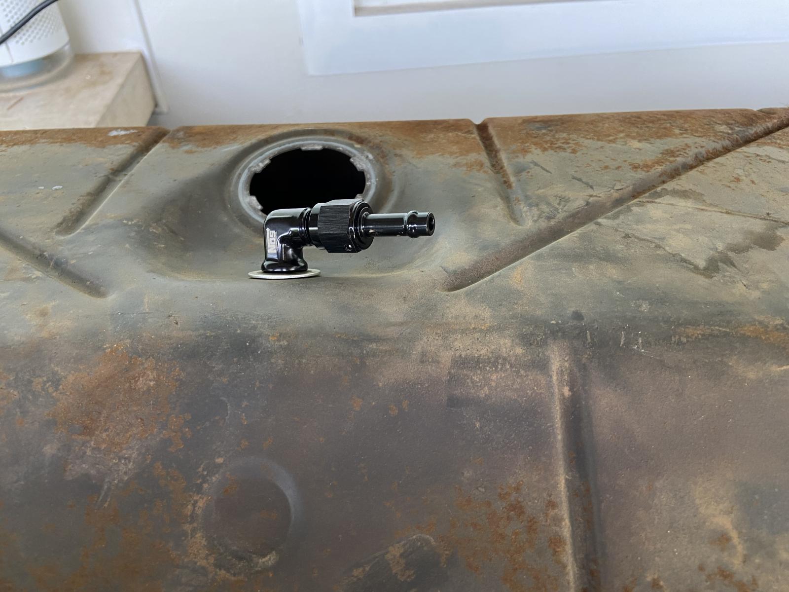

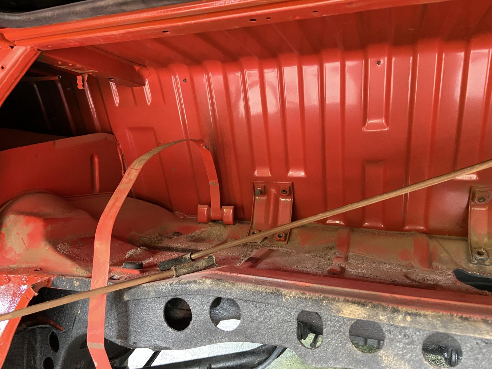

First Up: Add a return line to the gas tank (and clean and seal the tank).
Step 1: Disconnect two wires from sender, remove fuel vapor lines (and replace with new ones), and remove (and also replace) rubber fuel filler elbow
Step 2: Remove tank and then vacuum out 47 years of crud.
Step 3: Test fit the fuel return. I searched high and low and considered several options based on posts from other forum members. I didn't like the idea of t-ing the return line into the filler hose because it provides an opportunity for aeration of the fuel in the tank, so I opted for an in-tank pickup.
While there are several materials/hoses rated for total fuel immersion, few have data that goes out more than a few months. I don't know about you, but I HATE getting covered in gas and hate even more having to pull the engine to get at the tank (if not cutting an access hatch for the sender etc), so I opted for a PFTE hose that measures approx. 10". This allows me to install the return just forward of the sender unit which means I can get my hand/fingers in the sender hole to cinch up the nut and affix the PFTE hose with a proper non-gouging clamp for backup. At the same time, the length of hose ensures that I can slope it away from the main line at the bottom of the tank.
I went ahead and made the requisite 9/16" hole in the tank. Normally I would have loaded up my bit with grease to prevent metal shavings from falling into the tank, but since I'm cleaning, etching, and coating it, I didn't really care.
Next up: Clean and seal tank, replace/calibrate fuel sender, and then finalize return line install. I also got impatient and started mocking up the rads to figure out where I will make the cuts on the driver's side engine tin lip.

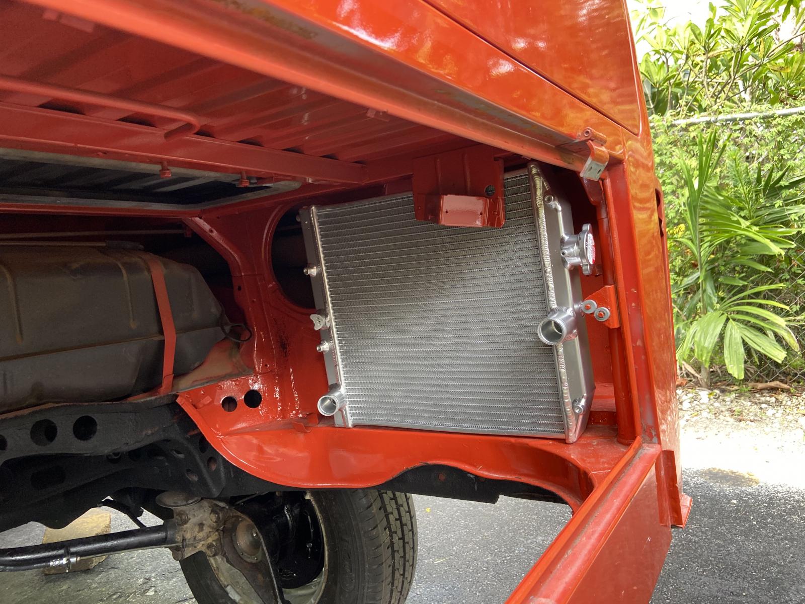

The caps on the rads are a higher psi than the the one on the overflow tank which will be mounted at the highest point in the system to avoid getting air trapped in the system. I’ll mount the overflow tank where it can be accessed from the hatch or use a remote fill location (spare tire well is how I did it previously)
As to the batts, I’m thinking of mounting the main batt on its side (sealed batt) to somewhere under the belly and then sticking the house batts under the rear seat. I will iterate as I go to see how best to maximize space.

PostPosted: Mon Aug 03, 2020 5:01 pm    Post subject: Re: Annie-other Subaru Swap - Build Thread Reply with quote
oh boy
in bay radiators Popcorn
knowing what I know now I think I can make it work. but typically...they don't. what is your target coolant temp?
I have been down this road. didn't end well

PostPosted: Mon Aug 03, 2020 5:25 pm    Post subject: Re: Annie-other Subaru Swap - Build Thread Reply with quote
skills@eurocarsplus wrote:
oh boy
Yeah I ran into some roadblocks with this in the last conversion and ultimately decided to go belly mount with a big ass Ford Explorer radiator in between the frame rails. That said, I like to run off-road on occasion and am loathe to have my Achilles heal sitting in the most vulnerable of locations.
Given my current cooling plans, I *think* I can pull off bay mounted rads in the 210-220F temp range. I’m not going to cheap out on fans (12” SPAL Hipos with upgraded alternator to keep up with amperage demands) in order to move a good amount of CFM and also shroud/block off the rads to force air through them. I figure it’s 50/50 and can always go belly mount if needed. Of course I guess I could always go with a variable speed thermostatically controlled water pump like the fancy bmws and Porsches but in the end I do want this to be a reasonably priced build.

PostPosted: Mon Aug 03, 2020 6:50 pm    Post subject: Re: Annie-other Subaru Swap - Build Thread Reply with quote
problem is, 220* is too hot for this generation Subaru. for a short period...ok but not sustained.
trust me, I did a LOT of futzing with this. at 210-213 Subaru fires both fans and kicks out the a/c compressor.
some claim it works, but it's on the ragged edge imho. I understand the off road thing.
I can honestly say that I can cruise at 80 with a/c on and not break 205* in 92* weather

PostPosted: Wed Aug 05, 2020 9:53 am    Post subject: Re: Annie-other Subaru Swap - Build Thread Reply with quote
panel wrote:
What radiators are you using and are you going with the Subi-gears kit ?
The rad info is in the Google Sheets link at the top of the post. Scirocco rad for the drivers side and Honda Civic rad for the pass side.
I’ll be going with the Subarugears (info in Google Sheets as well) kit so I can reuse the five speed trans from my Subie. Wanted to go six speed, but the Subarugears guys advised against it given the level of hacking required to shoehorn it in. Maybe for version 2.0 down the road including AWD Laughing
