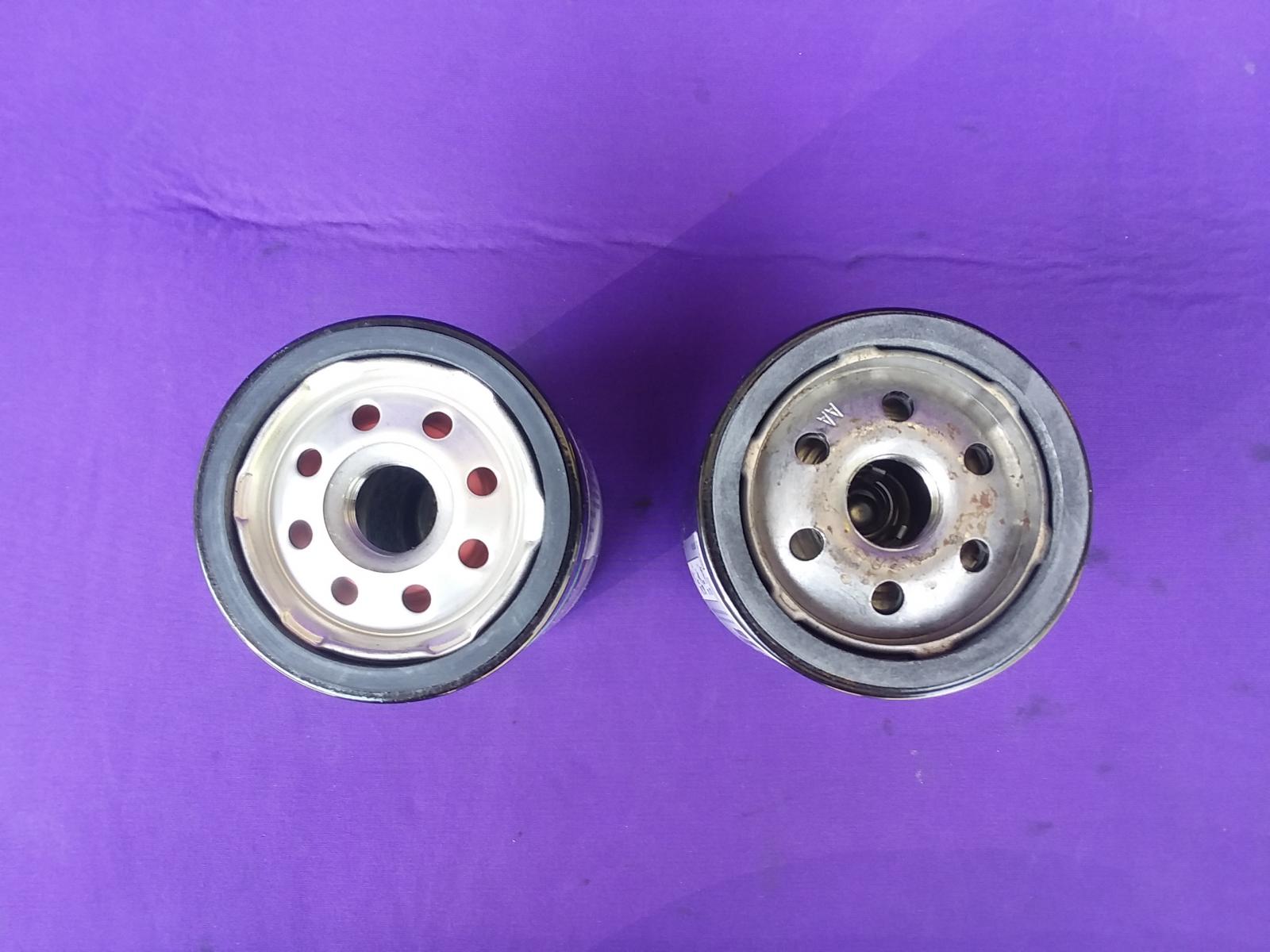

Hexie wrote:
Also picked up a Mobil 1 M1-205A as a backup, so if anyone has experience with this that would be good too!
That's all I've used on my 2.1L. No issues.
Be aware though, that there are two types... either one could be in your box.
I discovered this during the last oil change.
~Kamz Anxious

PostPosted: Sat Jan 30, 2021 1:47 pm    Post subject: Re: Mann Filter Question Reply with quote
The mobile filter on the right appears to have an anti drain back valve that the other does not have.
The one on the right has a square cut O ring, that sure looks to stand pretty tall. Not sure I like that.

PostPosted: Sat Jan 30, 2021 7:27 pm    Post subject: Re: Mann Filter Question Reply with quote
I've been using the Mobil 1 "205A" and it is a good filter for the engine. It has the drain back valve in it. They advertise that it does and you can see it through the holes (except for that filter made on Wednesday that KamzCab86 posted.)
