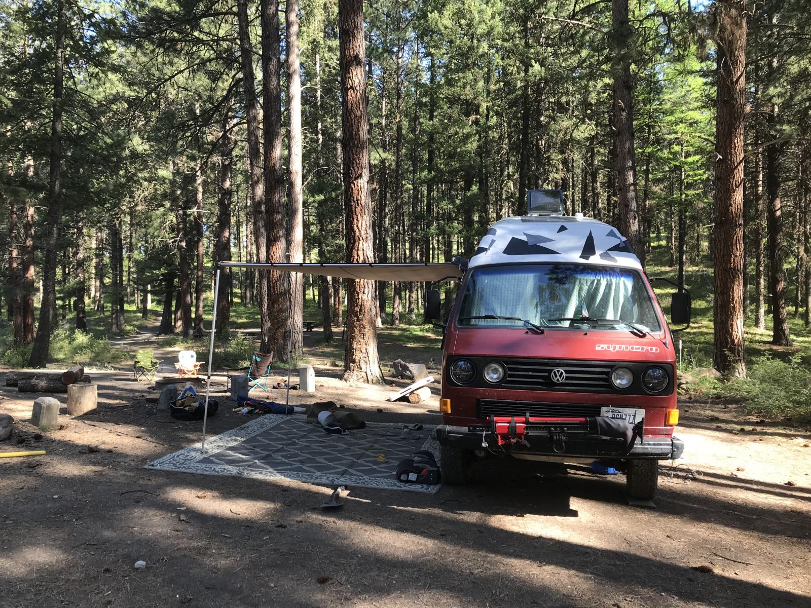

I've had my two 120 watt flexible King Solar panels on my roof since summer 2016.
They've endured about 60,000 miles of travel and some bad hail storms.
I have them mounted on aluminum bar stock that is tensioned to keep the panels slightly bowed away from the roof surface. This also maintains a low profile, keeping the panels less conspicuous.
The aluminum bar stock frame has rubber bumpers mounted underneath it (they are actually sink drain stoppers) that keep the frame from flexing too much.
The laminate film on the surface of these panels peeled away long ago.
The efficacy of these panels has definitely declined since they are new. If I press on them, they sound a bit crispy/crunchy now, and because of that I have been giving thought to replacing them.
Ideally these are mounted directly on a fixed surface, where they will not flex and last longer. That has not happened with these panels. I still do not regret it.
As a side note, my home has 17 280 watt conventional glass/aluminum solar panels on the roof, for 15 years now. Good solar panels should last at least 25 years.
Despite their age, they still deliver sufficient energy to my Redarc DC/DC charger to keep my 200AH of LiFePO4 batteries charged up nicely. In fact, I used the van to run my house during the recent winter freeze, and an even more recent (last weekend) 26-hour power outage due to storms. In both cases, the panels were instrumental in recharging the house battery system that had been run down to 12.6 volts as it kept my home refrigerator running in the face of no grid power overnight.
They are definitely lighter and quieter than my original solid 100 watt panel.
I will most likely try flexible panels again, but I am looking at all options. I agree with Howesight above--the newness of the product allowed marketers and manufacturers to really sell something that wasn't totally developed.
I've been slowly looking for a good brand to buy. I have one spare 280 watt panel from my house installation and it's very tempting to put it on the van, as bulky as it would be.
The first photo below is mostly about kayaks, but you can barely see the panels on the top of the van.
The second photo was meant to show some antenna mounts, but you can also see how the panels are mounted in the background.

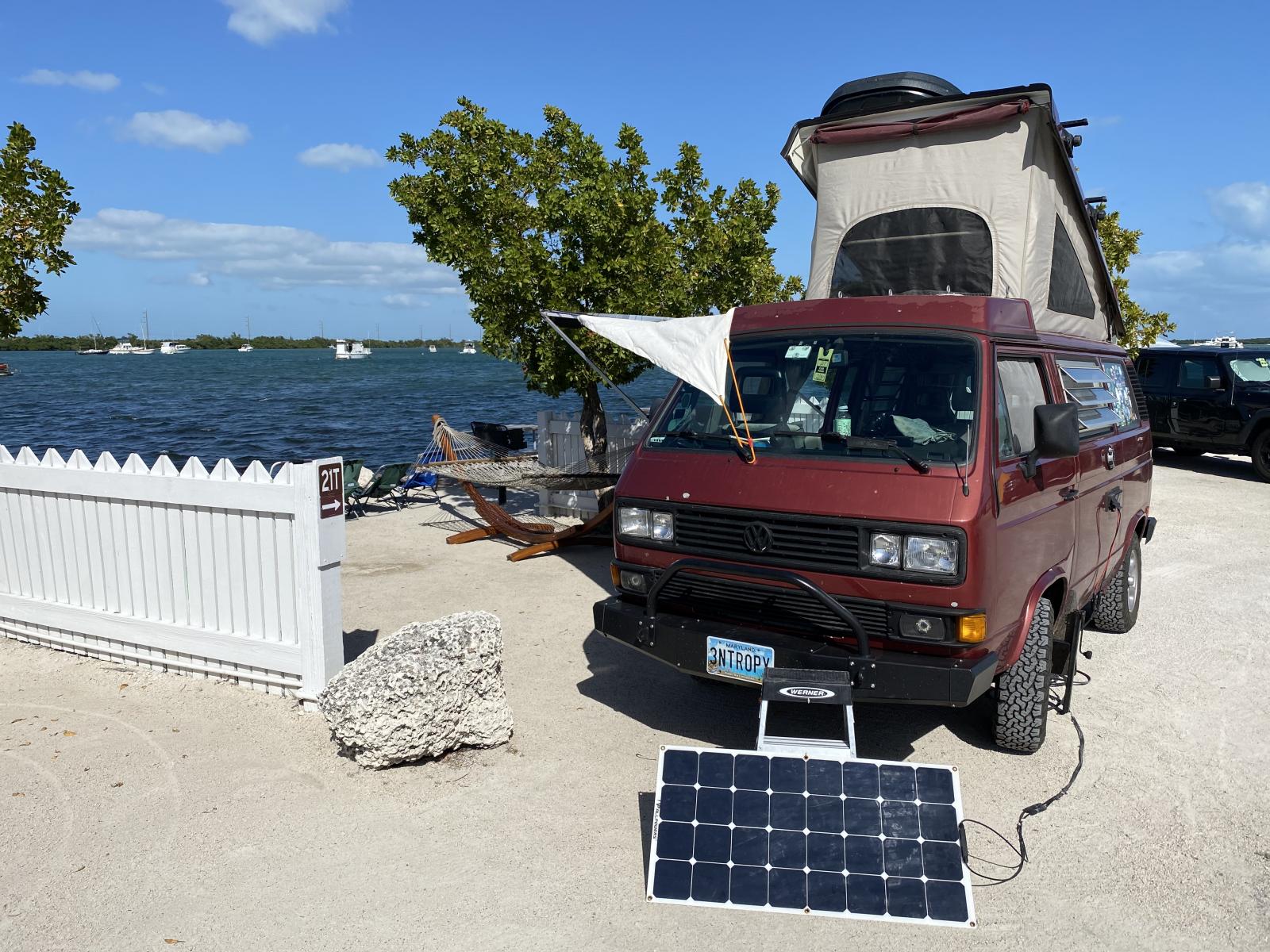

I have a panel I deploy remotely and after 10 years it is just fine.

Never mind the panels, Dave O. Where is that fabulous site 21 T? Need to go there.
Boyds Campground, Key West, FL Cool

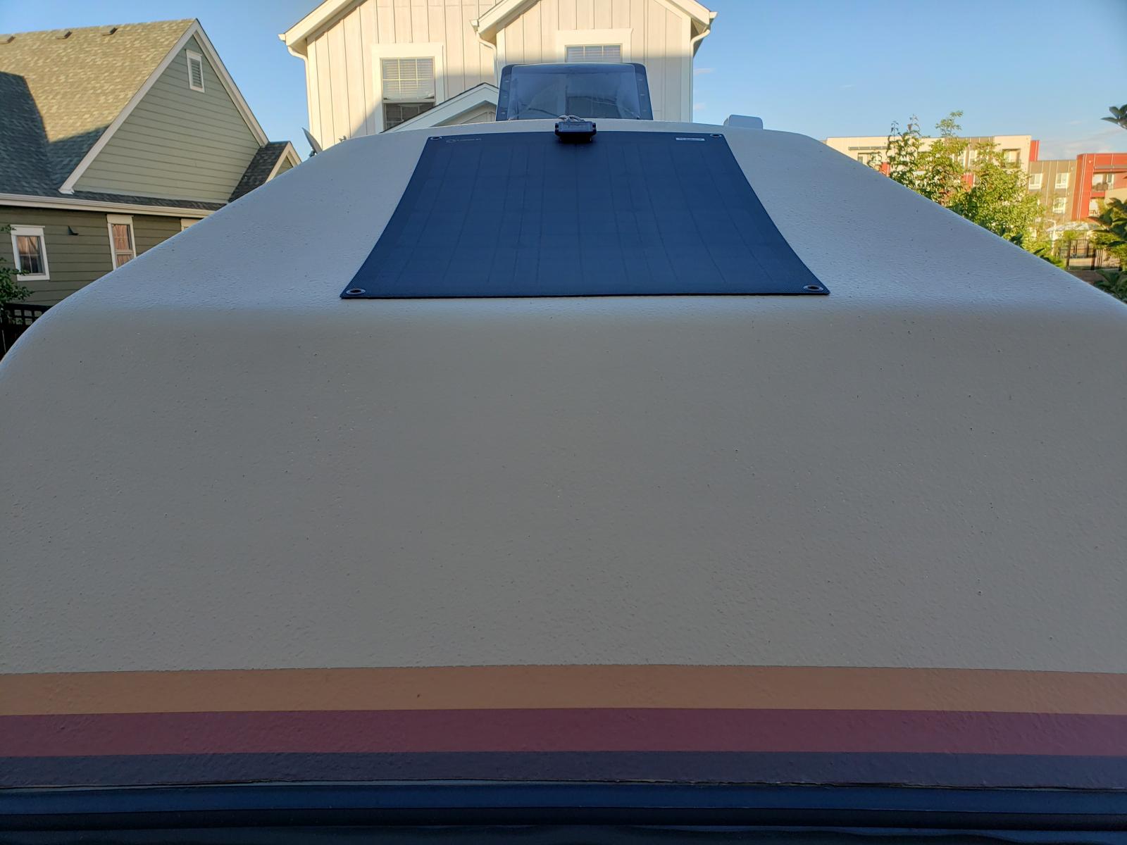

Fiberglass-backed ETFE panels (whatever that means.)
They've been on the van with 3M UHB tape for a couple of years and have been through blizzards, hailstorms, high wind, heat, whatever, and still work perfectly.
https://www.lensunsolar.com/Lensun-80W-12V-Fibergl...an,rv,boat
55 on the front, 65 on the back (not pictured.)
They're stiffer and heavier than the standard flexible panels.

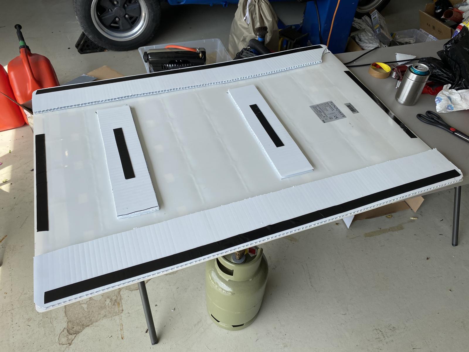

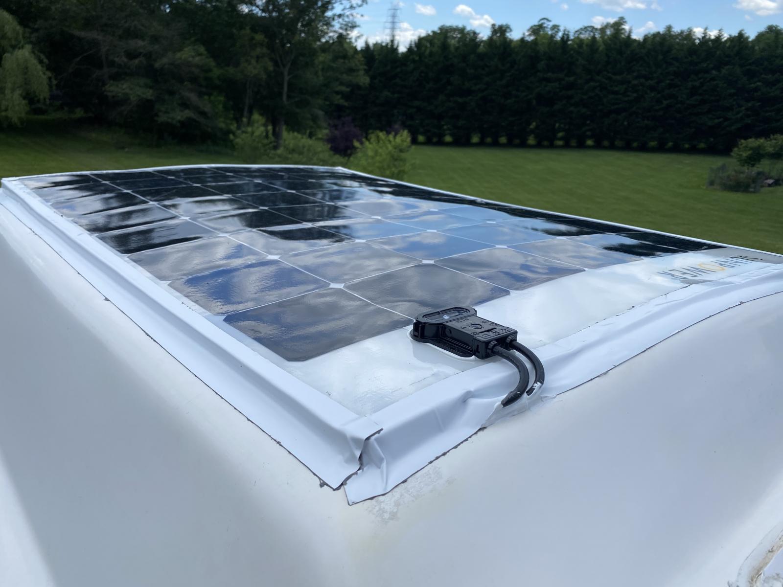

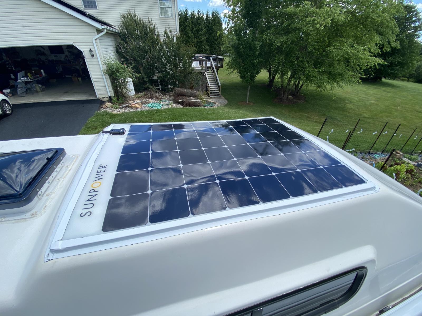

Here is how I did the flexible panel on the euroBus. Time will tell how long it will last.
dobryan wrote:
I finally installed the solar panel on the NAHT.
170W flex panel.
https://www.emarineinc.com/sunpower-170w-solar-panel
The NAHT has some bumps and such on the center portion for a vent and likely for structural reasons. I needed to bridge those to create a reasonably 'flat' surface for the solar panel.
I chose to use 10mm coroplast as the material since it would allow good air separation to help keep the panel cooler.
To adhere the coroplast to the panel and then to the NAHT I used VHB tape. And then I used roofing tape to finish off the edges of the panel to NAHT.
Panel VHB'd to the NAHT.
Note that the solar panel wiring is tucked under the panel. I had prewired the NAHT for solar anticipating panels on the rear deck area and so I used a utility box especially design for solar wiring. Unfortunately that box was too tall for the panel to fit on top of it so I had to cut it apart to get it off of the solar wiring that went thru it. I used the 3M marine adhesive from the NAHT install to seal up the area where the wiring came thru the NAHT. The nice thing is that the connections are not visible and out of the weather. The bad thing is I may have to destroy the solar panel if I ever need access to them.
And the roof tape is applied.
Everything works well. The panel and the Victron solar controller are happy with each other.

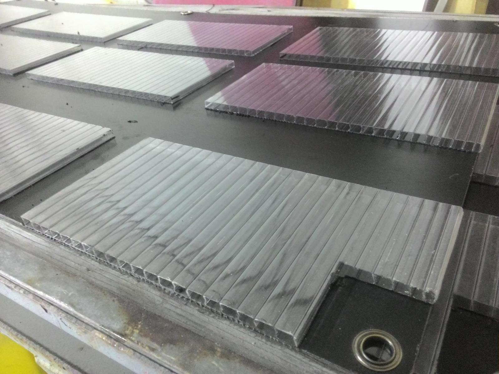

I installed LENSUN panels on a few vans now, and on many boats, I bond them on poly carbonate sheets so they can vent, this is the first gen of my concept, currently ready to launch the second gen version with even more ventilation- panels need to breath to dissipate
heat or they will have a short life!
