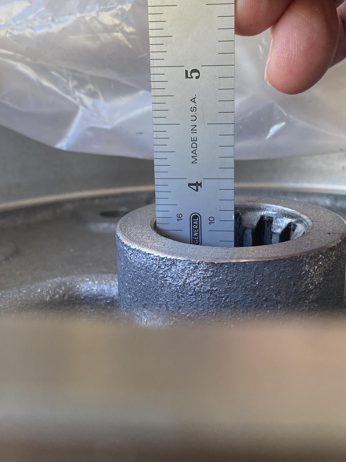

Maybe it's a reflection in the shiny silver paint, but it almost looks like there is a "crease" in the part of the wheel between the mounting flange and the rim. The curve doesn't quote look "VW" to me!
One thing I'm learning on my Bus is that drums with the same bolt pattern, splines, and diameter my differ in a critical dimension: between the inner flange and the outer shout, due to changes in the stub axles. For example, I think '67 USA models got "long axles" and this created a change in the drum, though I'm not sure. And of course, yours is a non-USA car.
This all makes it very hard to give advise!
I suggest you measure this distance like I did, and compare it to the new drum (or ask the vendor to measure theirs):
