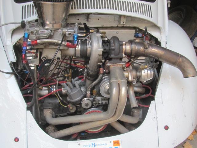

300hp Aircooled VW not with heat & AC Rolling Eyes ,I'm close to that maybe??? Laughing
'Black Ice'Drag Buggy 'Turbo'
Rail Buggy 1915 turbo
76 Drag/Street bug 2180cc 'Turbo' 11:85 @113 mph"If I go any faster I'll burn up the Hamster" ,gets 28 mpg. also 10/09/22 11.90 @115 mph
