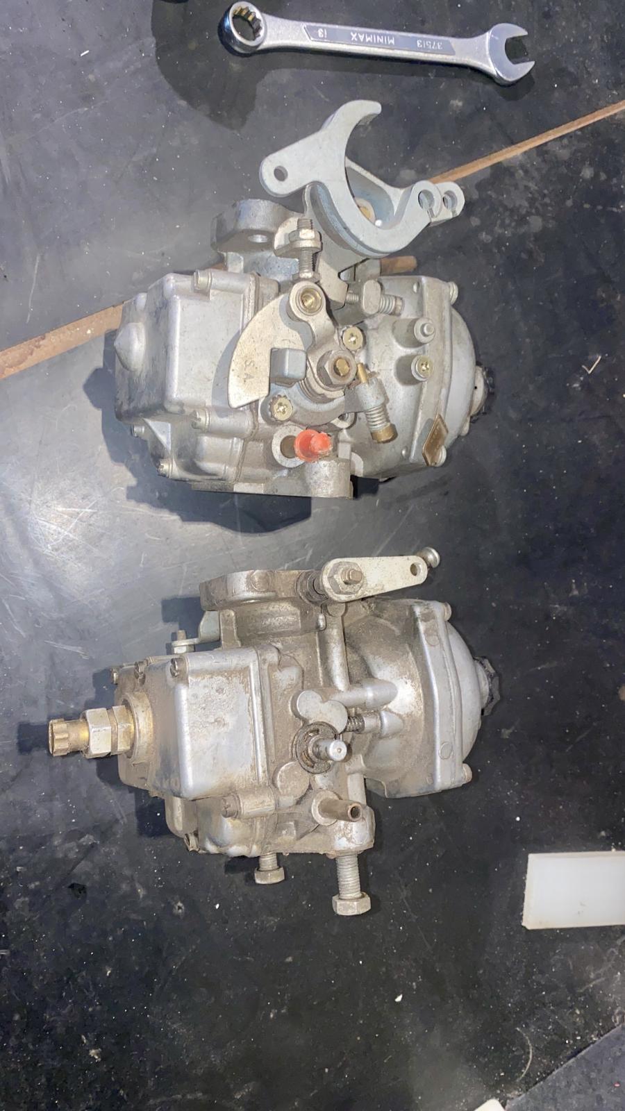

There were two carburettors provided. One was right off the previous install and the other is a spare. we have a CD 150 Stromberg and a CD 150 Zenith,

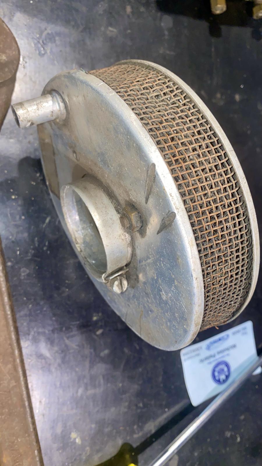

And a period Air filter which won’t be used. Instead I propose to plumb the existing oil bath filter by extending the existing tube and revising the provided filter tube so it points vertically. I prefer an oil bath over a filter. Fewer consumables.

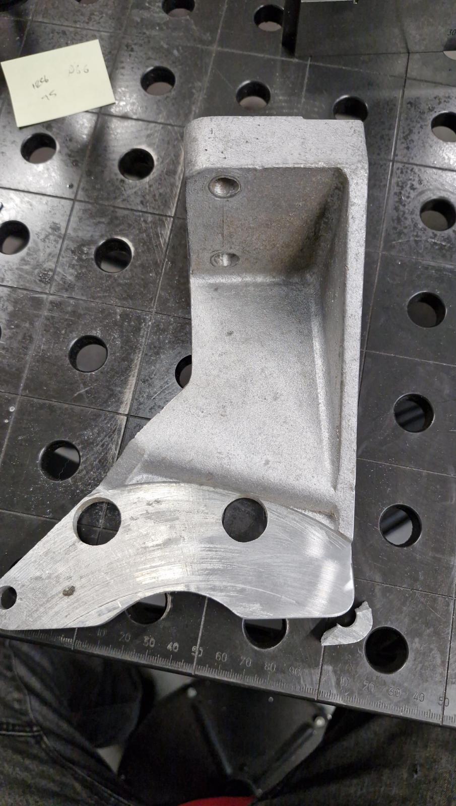

The VW stand is broken in one corner. This isn't a difficult TIG repair. There are lots of talented TIG welders out there.

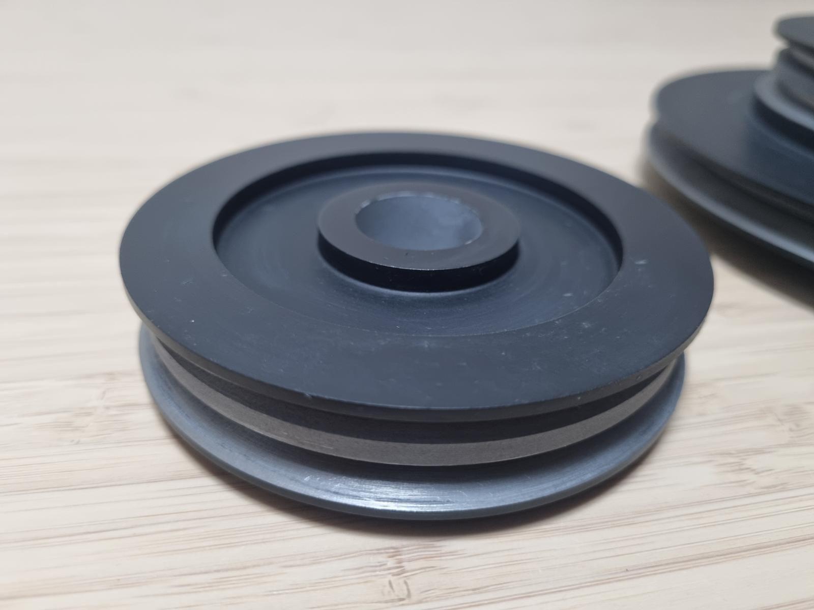

More concerning is the cast iron pulleys both of which are chipped. I have the chipped piece from the larger pulley
The chipped piece is missing from the smaller pulley. I'd like to learn if there are replacements out there. Otherwise I'll have to find someone who can rebuild them.

I’ve found a guy here in Australia who can copy the broken pulleys in cast iron. The VW crank pulley would be the most rare. Would there be interest if I commissioned a few more? Not sure on the price yet but expect about $150.

The cast iron has been milled and we have a new pulley to replace the broken one.
I was out with my estimate for the price. But how do you measure the price of unobtainium when you absolutely need to have it.

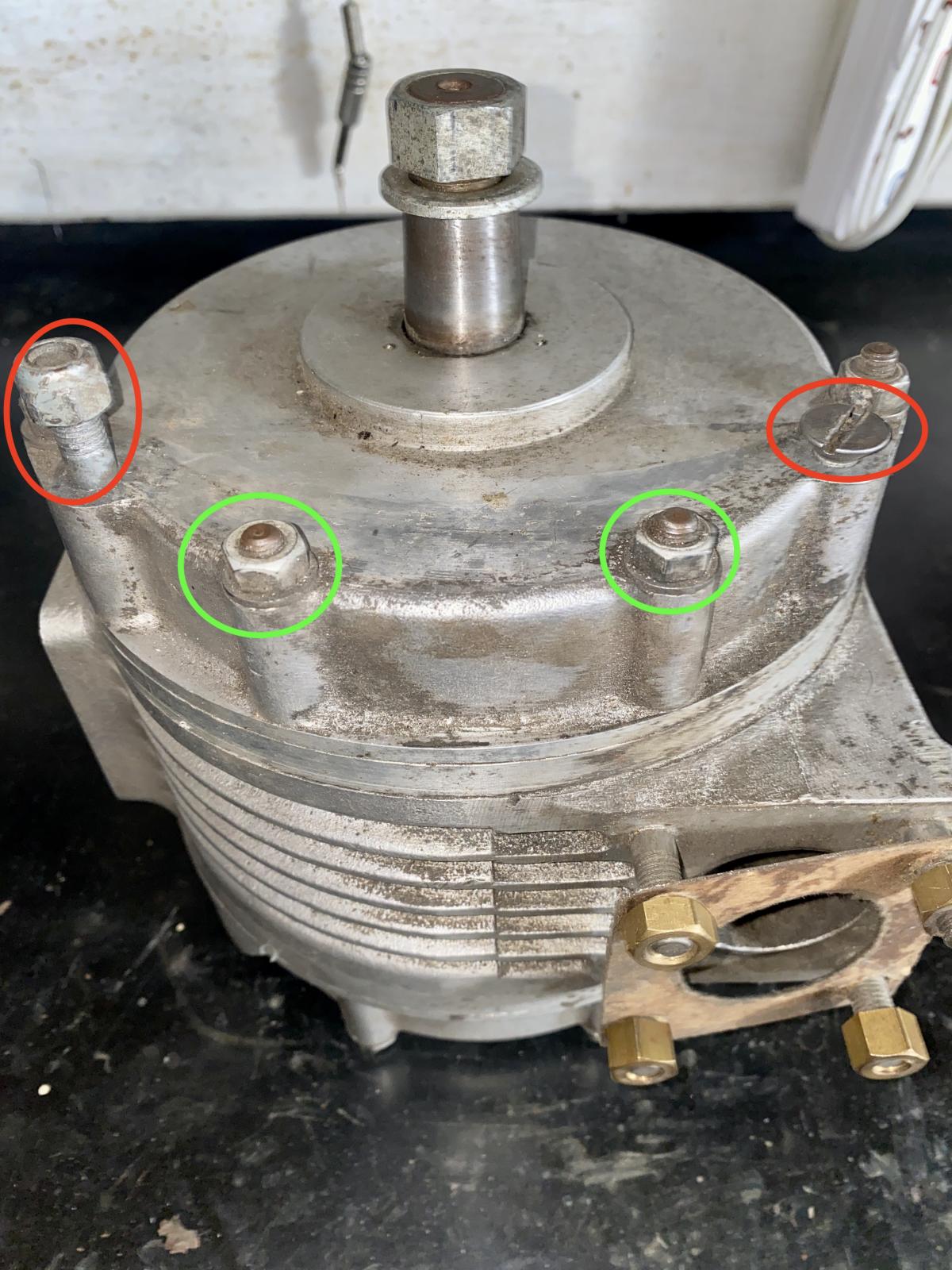

I recently bought this and i intend to fit it to my old speed oval at a later date although it will take a lot of work to adapt it to my okrasa 30hp motor. I`m missing the supercharger mount but seen as i`m fitting it to an earlier motor i will have to fabricate my own mount anyway.

More Photos of them both. I'm happy with the outcome.
I marked up a photo for you showing the mounting holes on the C75B that mate to the VW stand.
Circled in red are the mounting points. One is a stud fastened with a washer and nut and the other is a countersunk slotted screw fastening to the C75B body. Only these two support the C75B. Circled in green are bolts with through holes on the face of the stand and there is no support provided at these points. I'm guessing there would be interference with the belt if a washer and nut were sitting under there.
On the other face ( towards the front of the car) are a couple of straps that probably help with the twisting moment. These use a couple of studs and you can see them in the earlier photos. As yet I haven't had a chance to work out how those go.

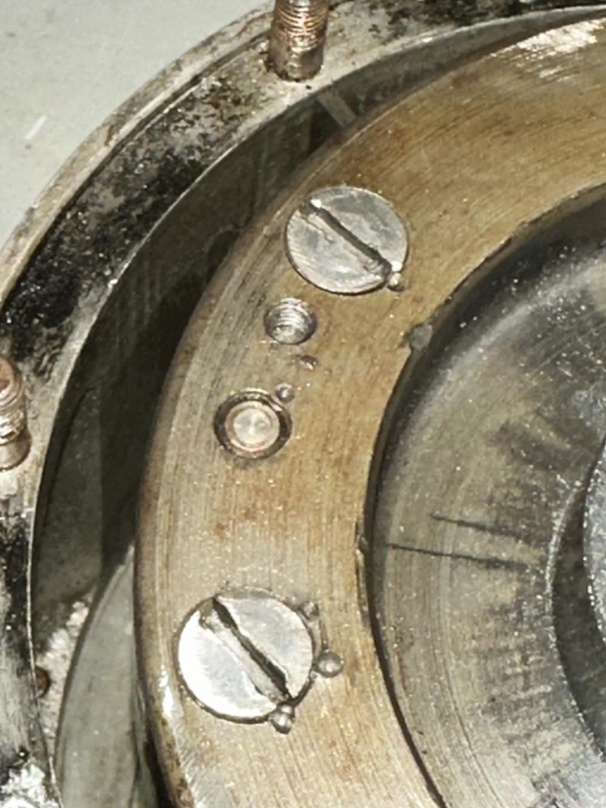

I carried the Supercharger in my luggage over to Auckland so I'm able to make progress with cleaning it up along with its ancillary parts.

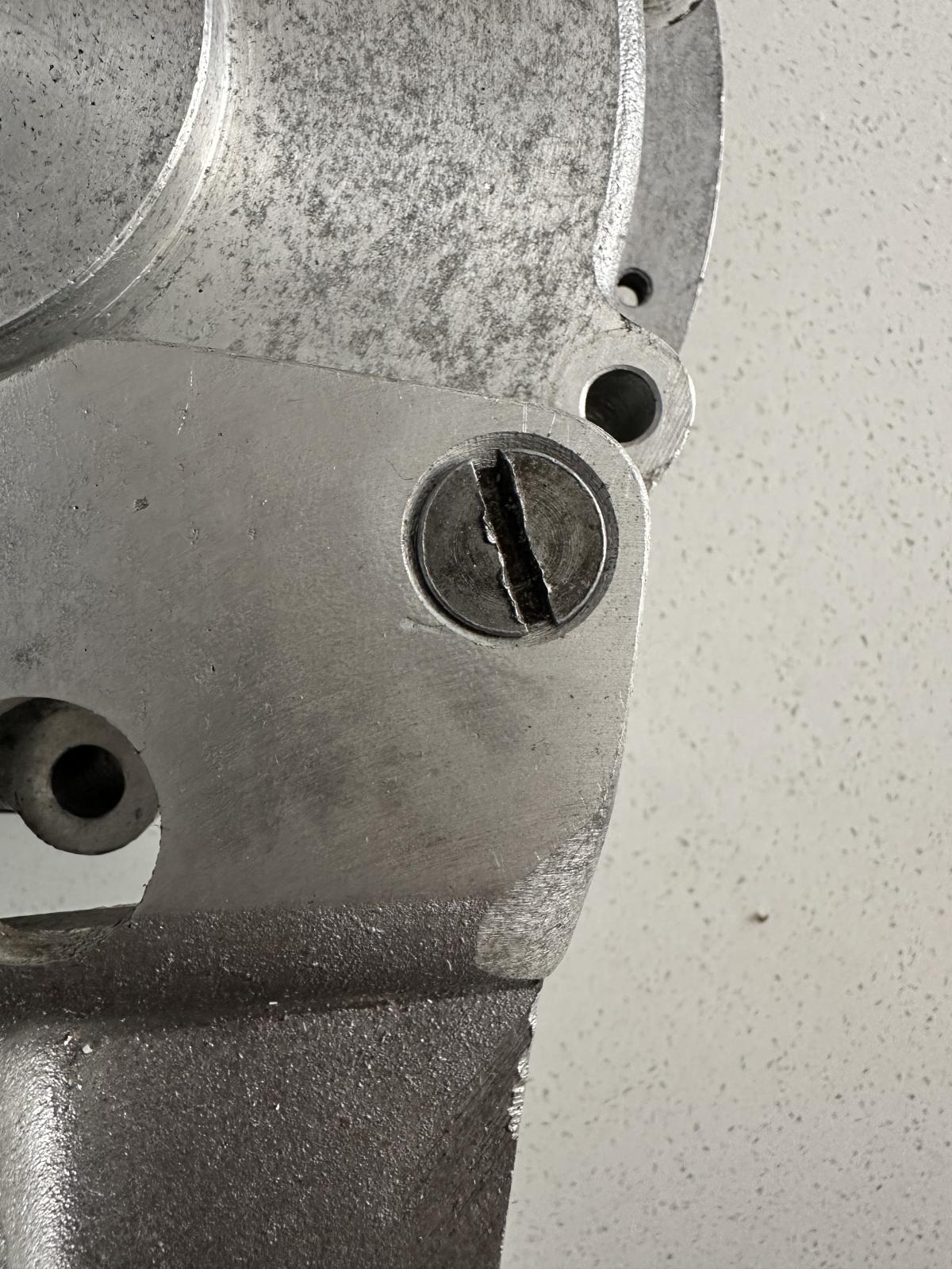

The C75BV being an English affair is definitely not metric. I've been working for years deliberately avoiding the old imperial measures but now I'm going to have to learn. It gets tricky with both Australia and New Zealand having long been metricated and finding a bolts supplier carrying Whitworth hardware is a small challenge. I found one but even then they sent the wrong sizes. I was stuck for a while till I found the oil inlet is held in with the same thread size as is used to split the sections of the supercharger. So I could make a start.
This screw is tightened to split the front plate.
Taking care to not strip the aluminium and make sure the plate comes of squarely.

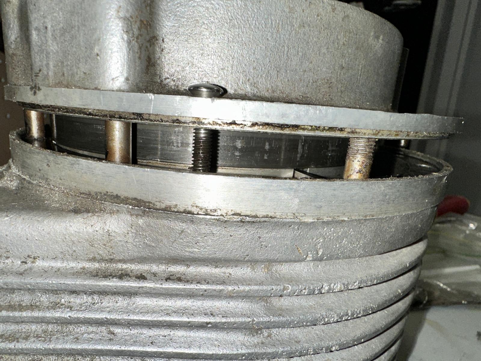

Inside the rotor and vanes look oily but clean enough. No damage is apparent.
I spotted one screw is missing. It would have fallen out into some previous owners intake manifold. Hopefully it never made it into the cylinder head.
Counting up the punch marks this unit has been worked on at least twice since it was built. I'm lucky third

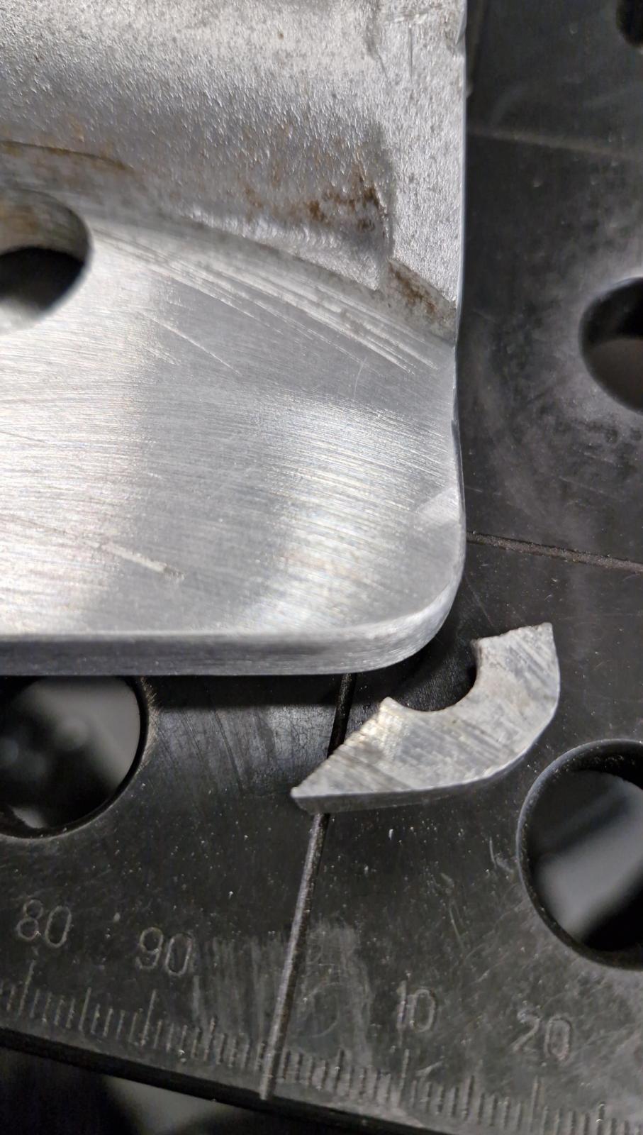

The VW specific stand has been repaired by one of the guys at work who is an aerospace grade welder. It came up quite well.
Overall view
The repaired corner before drilling
After drilling and counter sinking the hole I test fitted it on the face cover. It seems to line up ok.
Drilling this was easy, holding the work in place on the drill press was challenging. Before starting I did a bit of research on the question if this hole needs to be counter sunk. Nearly all the photos of I uncovered on the web show a countersunk screw. Only in the EMPI catalog of '66 does it appear with a bolt. I guess the tight clearance for the belt was discovered after the first few prototypes.
Anyhow, on this project we have fixed everything that was broken in transit. From here we are moving forwards.

I have a question concerning the oil metering fixture.
Which side of the pin should the spring be situated? I think it is shown below in the correct sequence. I will need to clean off the corrosion from the pin, or put in a new one if I can find a replacement
I've found a new bit of damage or at least the cause of it. The bearing on the outer face appears to be around the wrong way so the shoulders touch the spinning plate and jams the bearing. This causes the bearing to spin in the aluminium mount inside the face plate and the bearing can't do its job properly. I'll have to extract it and work out a fix.
This is the view inside showing the blades in the trunnions and the lock nut that's secured with a split pin. Before I venture down in there I have to make a mandrel to slide the vane mounts on. Only after that can I lift them out and inspect the bearing at the other side. The trunnions will need to be replaced. I understand replacements are not difficult to engineer and the modern day material of choice is PEEK plastic (Poly ether ether ketone) which is supplied as rods. Convenient to machine in shape and to slit.
