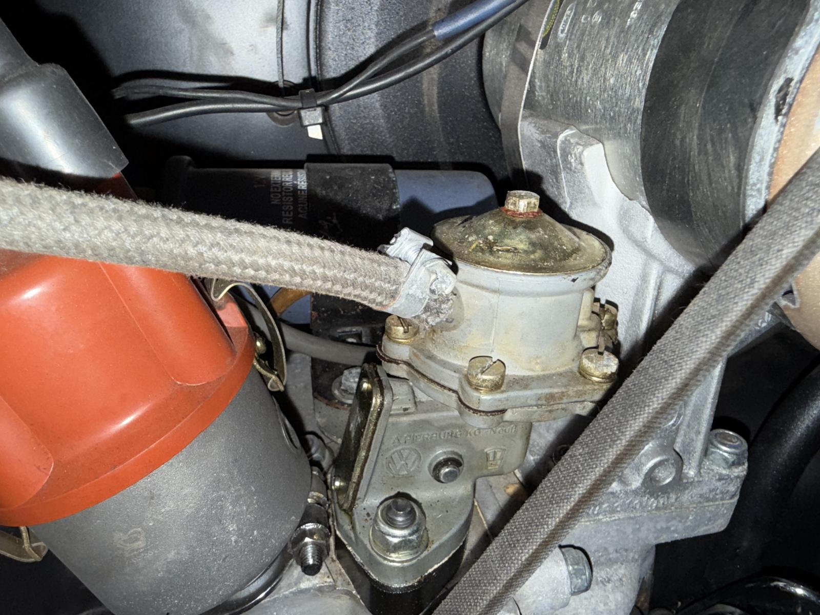

PostPosted: Sat Jul 22, 2023 8:53 pm    Post subject: Re: End of my rope, please help, 1900cc engine + Weber stalling Reply with quote
I have had this same problem on 2 different engines now. The issue sounds strange, but I have fixed it both times the same way.
Same problem. Runs fine till it gets warmed up, then it runs out of gas, and won’t re-start. Leave it sit for 20min, and it fires back up after a little cranking.
So here is what I found. The black aftermarket fuel pump stand....just like he one on your engine. The guide hole for the pump push rod is too small. As the engine warms up, the hole shrinks and pinches the pump push rod. The rod can no long pump up and down, so the pump quits pumping, and it runs out of gas. Let it sit for 20min....engine cools, push rod starts moving again. It takes a while to get it going again because you need to crank the engine till the float bowl fills up again.
To fix it, pull the pump stand off, and ream the guide hole out larger, or swap it out to one of the OE brown bakelight style original pump stands.
Good luck. Hope this helps.

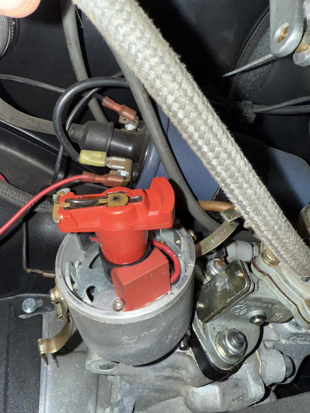

PostPosted: Mon Mar 24, 2025 9:00 pm    Post subject: Re: End of my rope, please help, 1900cc engine + Weber stalling Reply with quote
Still at a loss here. Years later and this issue is still not resolved.
It was not the gas cap, I spoke too soon. About 6 months ago I brought the bus 3 hrs back to the engine builder on a trailer as I had given up. He set the carb mixture, set the timing. He said one spark plug wasn’t sparking and he fixed it, but I’m not sure I believe him. Bus drove great when I got it back from him. No issues for a couple months.
Got the bus out today for the first time since winter. Behavior has returned. Runs good for the first 10 minutes. Then starts stalling randomly at stop lights. Sometimes it fires right back up immediately, other times I have to sit there at the intersection and crank for 5 minutes, but it eventually does fire back up.
Limped back to my house. It’s been sitting in the driveway for 45 minutes and still won’t start. I pump the gas and crank, it pops and fires for a second then dies.
Could it be a defective coil ? What are symptoms of a bad coil?
Could it be this pointless distributor?
I don’t know what to do anymore other than to just start replacing everything aside from the engine block

PostPosted: Mon Mar 24, 2025 9:28 pm    Post subject: Re: End of my rope, please help, 1900cc engine + Weber stalling Reply with quote
Brian
Also yes I have checked this. The pin moves freely with plenty of room, no resistance whatsoever

PostPosted: Mon Mar 24, 2025 9:30 pm    Post subject: Re: End of my rope, please help, 1900cc engine + Weber stalling Reply with quote
Do I even have a condenser on this distributor?

PostPosted: Tue Mar 25, 2025 5:43 am    Post subject: Re: End of my rope, please help, 1900cc engine + Weber stalling Reply with quote
Try swapping the electronic "upgraded" ignition components with original German points/condenser.
Hole too small in aftermarket fuel pump stand? Sheesh, never heard of that. It's probably made from plastic instead of real Bakelite so it expands/contracts differently. Try swapping in an original unit.
It's times like these that makes me appreciate the boring reliability of a 019/050 and PICT-30.
Hope you find out what the issue is. It may not be a fuel delivery problem; it could be ignition.

PostPosted: Tue Mar 25, 2025 8:41 am    Post subject: Re: End of my rope, please help, 1900cc engine + Weber stalling Reply with quote
My thoughts are, it's either fuel or ignition!
Too much or too little fuel pressure?,... (install a cheap fuel pressure gauge to see).
Maybe the idle jets are the wrong size?
Replace the coil & install points, & also install the correct spark plugs.
Make sure the valves are adjusted properly for the type of pushrods that are in the engine. (do you have chromoly or aluminum rods)?
Check for vacuum leaks that could be opening up as the engine expands from the heat.
Report back. Smile
